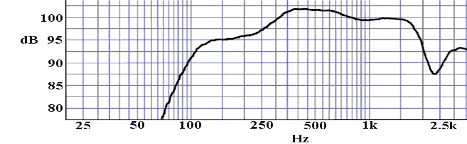

Thanks for the time, guys. I've included another graph, showing the raw response of both Alpha 6 drivers superimposed (blue/red), as well as the horn response (purple). Note that the Alpha 6s are not baffle mounted for these raw response graphs, only hand held and close mic'd at about 1 inch from cone center. Those dips are in the raw response, and I don't see how they can be horn related.
You're right, mtg90, that dip isn't present in the Alpha 6 published graph, shown here:
http://www.eminence.com/pdf/Alpha_6A.pdf (I posted a close up of the FR)
John

Here's yet another plot. This one shows, from top to bottom:
1) horn response with 2 alpha 6 drivers, ground plane
2) multiple handheld sweeps with sealed back single alpha 6 driver, measured outdoors at about 2.5 feet.
3) original responses of raw unsealed drivers, handheld, close mic'd at about 1 inch.
4) impedance plot of sealed back driver, not horn mounted.
Again, that dip in the mid 600 range is there, in the original raw sweeps, the sealed sweeps, and represented in the impedance plot. At this point, I'll have a VERY hard time believing it is caused by the horn response. I still don't understand why a midrange driver would have that kind of breakup (or whatever it is) in the middle of the mid range, and on 2 units... very odd.
John
John

post #25 of 78 Old 04-30-2012, 06:17 AM
Bill Fitzmaurice's Avatar
Location: New Hampshire
Posts: 14,454
Liked: 4628
A dip like that is typically sourced by an out of phase reflection, which also can show up on an impedance plot. It won't show up on HornResp. I doubt it's driver sourced.
Bill Fitzmaurice is online now
post #26 of 78 Old 04-30-2012, 06:50 AM - Thread Starter
johnbomb's Avatar
Join Date: Aug 2005
Location: Nashville
Posts: 340
That impedance plot is from the sealed driver sitting next to my computer, not horn mounted.
johnbomb is offline
post #27 of 78 Old 04-30-2012, 03:52 PM
Posts: 14,454
Liked: 4628
That means the blip, and possibly the response dip as well, is sourced by whatever you sealed the driver in. The closed back version of the Alpha 6 (available as OEM only) has a 1 ohm impedance blip at 700Hz; the Alpha 8 MR has one at 900Hz.
post #28 of 78 Old 04-30-2012, 04:11 PM - Thread Starter
johnbomb's Avatar
Join Date: Aug 2005
Location: Nashville
Posts: 340
That's a good point, Bill, and I had looked at the sealed back alpha 6 graph before you posted. If the blip is related to the homebrew seal job that I did, I can live with that, because I need the low end boost that it provides. I can just EQ the blip in the raw resonse with the minidsp, if I even notice it during listening. Either way, moving on...
I found out that the BMS 4550s will be here this Wednesday. My dad has a shopsmith w/ lathe capability, and hopefully I'll get to use it this weekend to make the CD mounts w/ contoured throats, ala Paul Spencer. Hopefully, more measurements to come soon!
John

My BMS 4550s came in today... YES! Man, these things are heavy! I routed a hole through my horn so that I could hand mount the driver and get some quick measurements. No bondo shaping in the corners of the horn... yet.
I posted two graphs:
1) The first shows ground plane measurements of the driver sitting on its side on the ground (green) vs handheld against the back of the horn (red). Things look really good until about 8 khz, where the FR rolls off pretty quickly, faster than it does for the raw compression driver measurement. Also, I had hoped for lower extension from the compression driver, to make my crossover easier... Oh well. Hopefully, bondo contour shaping will help things.
2) The second graph was lifted from jmorken's unity horn project, documented here:
http://www.diyaudio.com/forums/multi...ve-x-over.html
He made this measurement before he had done final contour shaping of the horn throat. I figured this was the best benchmark for my project at this time. I'll need to fab up a mount for the compression driver, likely out of 1/2 inch wood, just to support its weight. This will probably increase the effective distance from the midrange ports to the mouth, and I expect the midrange to rolloff a bit earlier than it does now.
