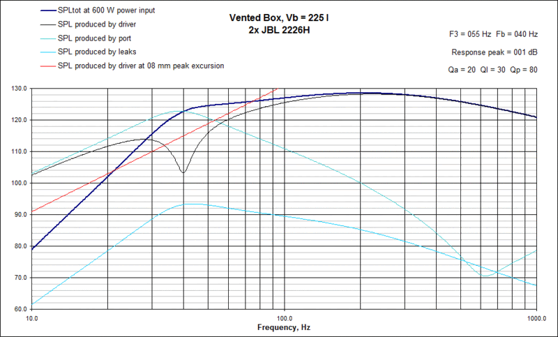

Alright, Ive got my old two tubatrons still sitting in my closet, I have some down time due to a blown PJ bulb (second one in a year, grrr, has nothing to do with the subs I promise!). Im going to pull my screen and really do some cleaning up behind it. While im at it, I am going to reincorporate the LLT's which are two tempest x-2 15's tuned to around 11-12hz powered by an epx4000 to my already existing dual XXX 18's that are on the fp14k.
I have the DCX 2496 still in the chain to eq, and ive got a 4311 and an sms-1 on order, but the different options im considering and would love your input on is:
1) keep the LLT's as they are, let them AND the XXX's play all the same bandwidth.
2) cut down the tubes a good amount and raise the tuning to aim for MEGA midbass output to help up where the XXX's get inefficient. EQ them seperately where the XXX's maybe run up to 40-50hz and the tempests go from there to maybe 120hz optimally. These would still be ported.
3) Remove the port from one tube, cut it down some and create a single dual opposed sealed setup for the tempests, and either eq them seperately or together???
As far as placement goes, none of these options would grant me the ability to put them anywhere else in the room other than behind the screen, but the final option, just building a quick sealed box or two and scrapping/selling the tubatrons is also a consideration. With the sonotubes being 24" dia, I couldnt even make these end tables or anything, just too big around... but what I could do, with the sealed boxes, is put one beside each row of seating.
Im not really looking at making this TOO permanent, as I still want to put two more XXX 18's in, and in the not so distant future if I am able to, but i thought one of these options would help me out during the interim. My overall objective? Well, more displacement, for help down low, but also to help the XXX's up where they become less efficient. can I get both with one of these? Perhaps if I left the LLT's alone, but making them blend with the sealed XXX's might not do well.
Id love to hear your thoughts guys! I saw the other post regarding something similar, but as I havent decided to split the bandwidth or not yet, this digs a little deeper
Thx

1) or 3)
Option 1) is the easiest to try out but could pose some situations with mixing ported and sealed in the same system. Not definite but could happen. Having a DCX online is cool but your LLT is tuned well below where it could help if that was something that is a problem area.
Option 3) is the easiest to deal with (though you'll need to alter the LLT's or build new sealed boxes) and will give you more output where your XXX's are lagging behind.
Option 2) is kinda.... meh, imo. You could tune higher relative to most HT subs but you'll still be lower than needed. You won't need more output in the 20-30hz range. You'll need it in the 40-80hz range. Lol and you're not gonna tune up to 40hz methinks. Try your Tempest's sealed with plenty of power. If that doesn't work out....
... then I'd say... "go big and go pro".

Alright!! Got everything hooked up last night but only was able to get about a 30 minute music listening session in so I cant comment too much yet, but holy jeez, I gotta lot more bang in the now with Both RE's and the LLT's firing. Lotsa low end. Right now I still have the XXX's on the DCX and the LG14k and the LLT's are going straight from the 4311 to the EPX4k. All i did was let xt32 eq the LLT's and since it has two channels, it eq's the XXX's seperately. I REALLY like that!!! Im going to get a good listening session in tonight and ill post my impressions tomorrow.
What I have pretty much decided to do however, is pull the LLT's and focus more on some pro drivers to really pound out the 40-100/120hz area, and let the RE's handle the low low stuff That will just be spectacular. I really just want insane amounts of midbass for music listening!!!
So far Scott has suggested the selenium 18SWS800 which fits pretty well with the power I can give it from the EPX4k, but id love to hear some other suggestions for a sweet pair of 15 or 18 pro drivers capable of COPIOUS amounts of midbass!!!
BC 18tbx?
beastaudio is offline
I just got a pair of 18LW2400s in ~5.5 ft^3 enclosures tuned to 38hz. I became interested in them after seeing Ricci's test of the 21LW1400. They are powered by an EP4000 in bridged mode, drivers wired in parallel for ~950 watts per driver. They kick ass for midbass, gave me way more than my 4 MFWs could. Now I run the MFWs 0-40hz and 18LW2400s 40-110hz.

....but id love to hear some other suggestions for a sweet pair of 15 or 18 pro drivers capable of COPIOUS amounts of midbass!!!
BC 18tbx?
Sure... that or:
18sound 15LW 1400 or 18LW1400 or 21LW1400
Eminence Sigma 18
Eminence Impero 18
AE TD18h+
Eminence KappaPro 15LF2
JBL 2226h/j
JBL 2241
JBL 2242
B&C 21sw152
Dayton Pro PA460-8
Peavy Lowrider 15
Peavy Lowrider 18
TCsounds PRO 5100
I'm sure there are a few others to choose from.

18LW2400 or the 18TBX100.
they model within 0.5 db of each other, but go with a ported enclosure like haan did, 5.5 cubic feet tuned to 38hz. that really maximizes what you are shooting for.
both can handle lots of power. both have demodulating rings (18lw2400 has two). they are pretty much the same price ~$320. the drivers on scott's list either lack some features or are much more expensive. the td18h+ might be worth paying up for, but who knows if they are available. i'd pick the 18sounds for its lower qe and le.

Thanks for all the suggestions... What about a pair of 4648A's? that outa do it huh? Ill look at the other drivers too
Umm, well... yeah. Do you have those? I've got three. Not going to use the cabs though.
I'd try the resonant cabs afterwards if there isn't enough midbass from the sealed version. The inroom response from both the XXX18's and these midbass units will sum up where it looks like they will be rolling off (~50hz) and the FR should be very smooth. Throw in a vented version and you might get some nice impact and obvious increase in SPL but it will be in a very narrow region and will require the use of HPF's and introduce new things into your measurements like some null around the tune and possible port compression. Also the box will be 2-3x larger so positioning in the tight spots will be ...harder. The sealed MBM's gives you more placement options to play with. They can also contribute to the lowend being sealed and if designed for excursion control then you'll never have to worry about extra filters or bottoming them out ....ever. The sealed option gives you the bass where you need it, up high. If you want to make subs of them and need extension, which you don't, go with the vented.
However, wood is cheap-ish so you should try both but I'd start small and easy.

Sweet, yea I would not be opposed to rebuilding the cabs for something sealed if I needed to, but a pair of these for about half what one goes for new? I might have to jump on that. Ill build whatever I need to if it necessary, that is a pretty sweet deal I could just plug the ports too?

You could but the net internal airspace is larger than needed for excursion control but I guess it wouldn't hurt to try. Go for it if you can get it cheap!
That will certainly punch it up a notch. Bridge your EPX into one. It's native tune is 40hz so HPF there.
Think I could get away with having both on my single epx? OR would I need to plan for another one down the road?

Oh... you're going to get two? Sure, you can do that.
Just to visualize.... here's one 4648a cab with 600w going into it.
Co-locate the 2nd for 6dB more across the bandwidth.

Now i really like the looks of that

well another thing I thought of, how would these cabs work on their sides, as opposed to standing up? I say that, because on their side, with the 15's beside each other, they will fit exactly between my 18's, then youll see a wall of speakers awesome
Im assuming no difference since these are purely going to be used for 40-120hz materials

They will work perfectly. No changes unless you plan on using them up past 1khz.
I also highly recommend running them the the way you mention consuming the middle space between the XXX's.
