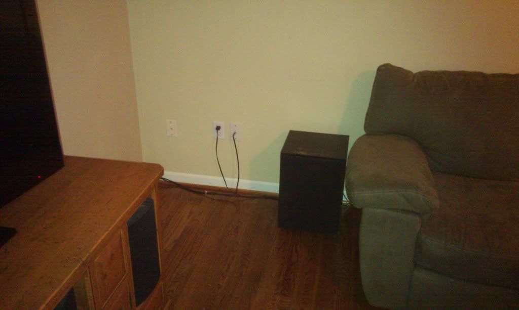

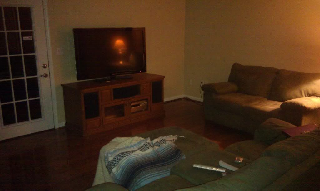

I won't ever have it full power. I'm replacing an old POS 8" sub that rattles and distorts at any big action sequence. I just want to cover anything that comes up without it taking a crap and pulling my attention from the movie. I had to turn the volume down to a whisper during the War of the Worlds sequence just to keep the sub from coming apart.
Do I need the rounded end pieces for the port or will straight pvc pipe work? Also, should the ports and sub face the room or the wall?
I'll post pics of the room and dimensions in a few hours.

I didn't even think to just use a round over bit. I have a cabinet shop next door to my business, so I have access to all kinds of good stuff. They actually helped build the entertainment center in the pics here. We are going to build the sub to match. The room is 16x20 with 8ft ceilings.
dave-n-kelly is offline
post #30 of 31 Old 05-22-2012, 08:56 AM
dave-n-kelly's Avatar
Location: Boones Mill, VA
Posts: 29
Jay, just to clarify:
just give a 4" port at least 4" of clearance from boundaries
is this from the sides of the box or just the end of the port? Also, should I do a small plate with a roundover inside the box on the other end of the port?
