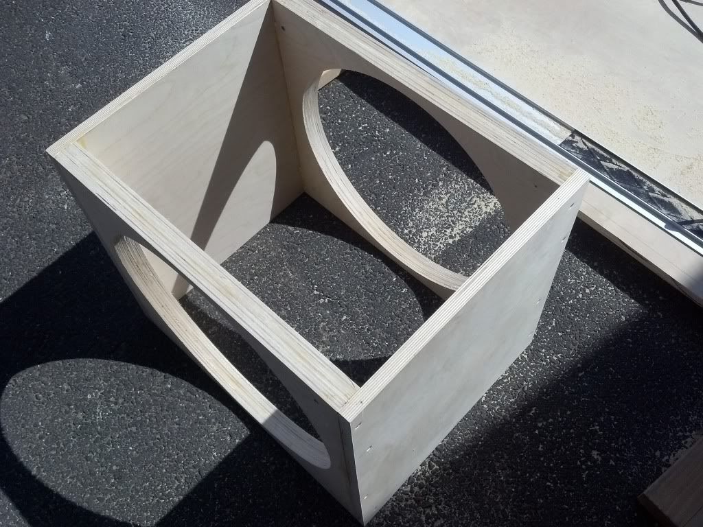

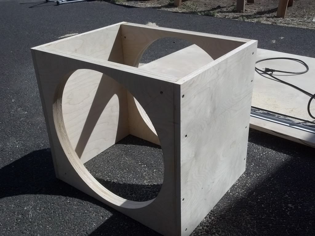

Made a little progress by lunch time...

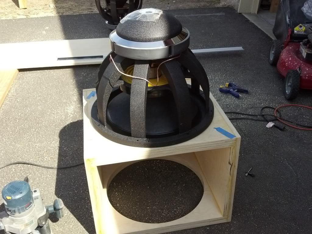

Looking great buddy! Is that one box or both? You'll be venturing into the crawlspace in no time!
Hey, you ever decide on what you were goimg to do with your amp situation? We don't want that to be the sticking point with your project so, just go ahead and buy another Clone... =)
popalock is offline
post #105 of 345 Old 05-27-2012, 11:16 AM - Thread Starter
keager's Avatar
Join Date: Oct 2010
Posts: 653
Thats just one manifold. Im bass-less now, so gonna get one installed then start the other. No amp decisions till sub installed. Sorry....
keager is offline
Cool, well it looks great. Nice cuts and very professional looking thus far.
popalock is offline
post #107 of 345 Old 05-27-2012, 11:48 AM - Thread Starter
keager's Avatar
Join Date: Oct 2010
Posts: 653
Thankyou sir. Hopefully will be able to mount drivers in manifold for a test fit before going down below. I suppose I should hook them up to to make sure magnet and cone clear each other with high excursion. Measurements say they will, but it would be better to change something now then later....
keager is offline
Definitely a good idea. I just realized you are going to have to mount these from the inside of the box...
popalock is offline
post #110 of 345 Old 05-27-2012, 02:59 PM - Thread Starter
keager's Avatar
Join Date: Oct 2010
Posts: 653
Actually have to mount from the outside due to joist width and magnet depth.
The magnet will be outside of the box in the crawlslace, but are you actually mounting the sub from the inside of the manifold with the magnet facing out right?
popalock is offline
post #112 of 345 Old 05-27-2012, 04:40 PM - Thread Starter
keager's Avatar
Join Date: Oct 2010
Posts: 653
One magnet out and one magnet in. Both mounted from outside the manifold

Posts: 653

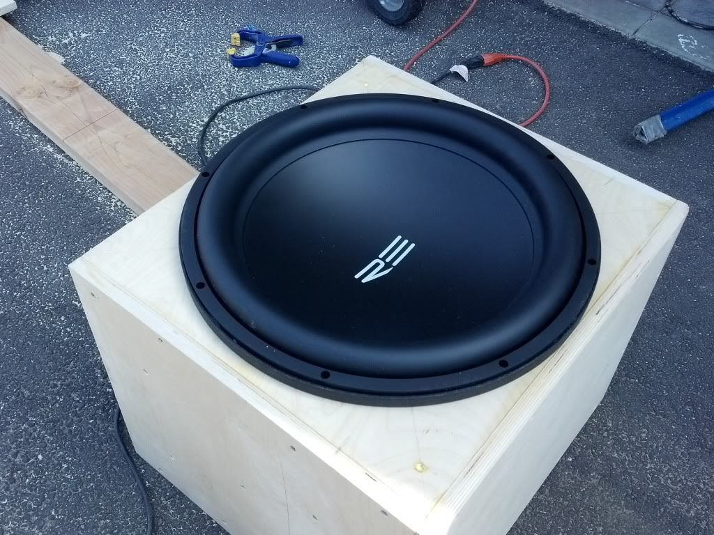

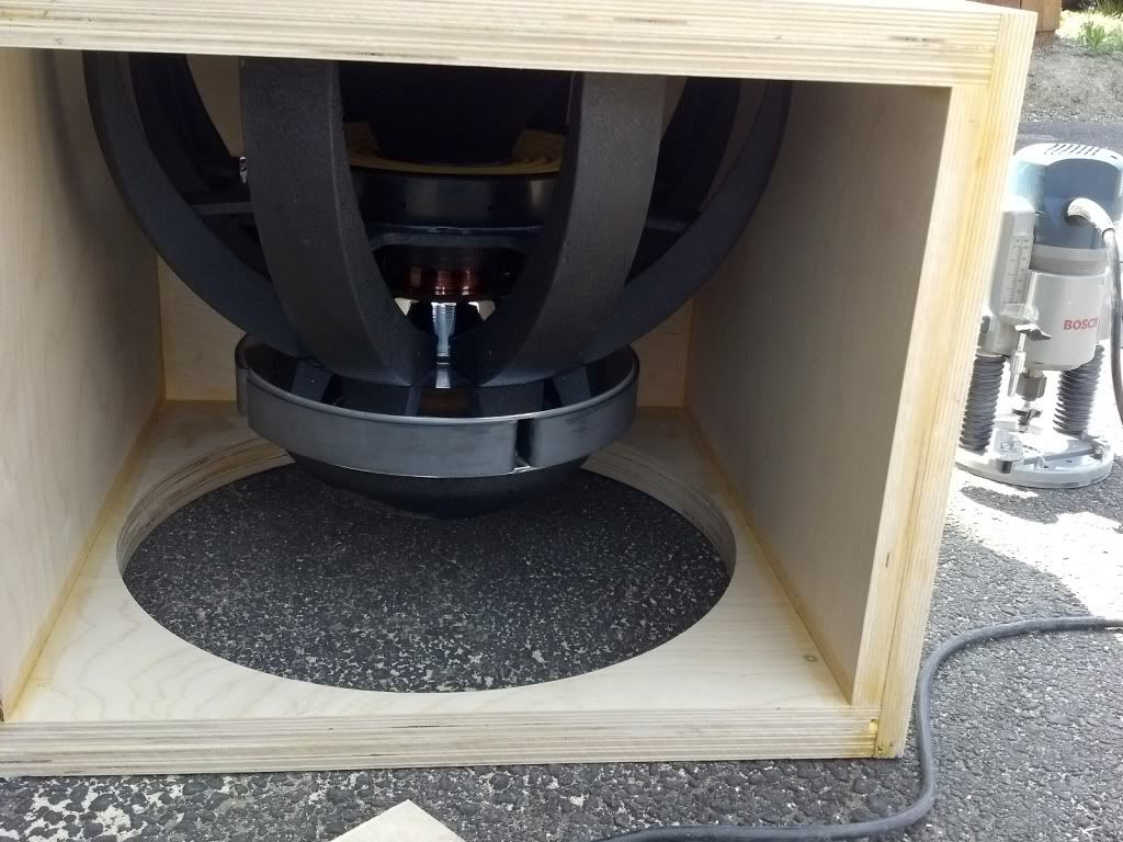

Little more progress. Setting drivers in cutouts to mark and drill pilot holes for mounting screws.
keager is offline

Liked: 61
Damn those things are huge!!!! How much clearance do you have between drivers now?
tsloms is online now
post #115 of 345 Old 05-27-2012, 06:03 PM - Thread Starter
keager's Avatar
Join Date: Oct 2010
Posts: 653
There will me more clearance than the one way excursion of the cone. Its a tight fit. It's starting to get interesting now.
keager is offline

Posts: 653

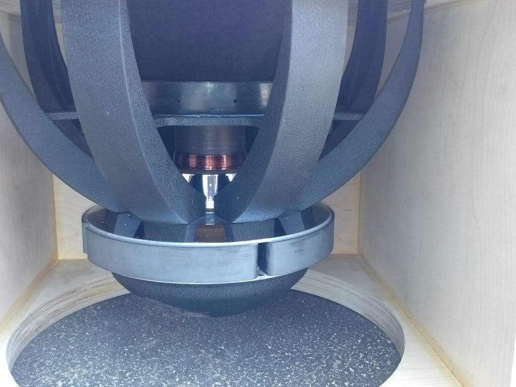

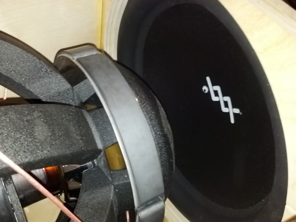

This is how the drivers will be mounted in the manifold once under house, bolted to the bottom of the floor joists. Over 4 inch clearance between the cone and magnet
keager is offline
Hummm, this is what the IB guys over at the cult suggested? I see now why I was a bit confused when you told us how you were mounting them. I've never seen this before.
Can you point me to a source that recommends this technique. I'd like to read up on it myself.
popalock is offline
post #120 of 345 Old 05-28-2012, 09:06 AM - Thread Starter
keager's Avatar
Join Date: Oct 2010
Posts: 653
The main reason I'm mounting them this way is lack of space on one side. I don't think there is a large benefit or drawback acoustically. Possibly to balance out driver non linearity, which is something I'm not knowledgeable about.
