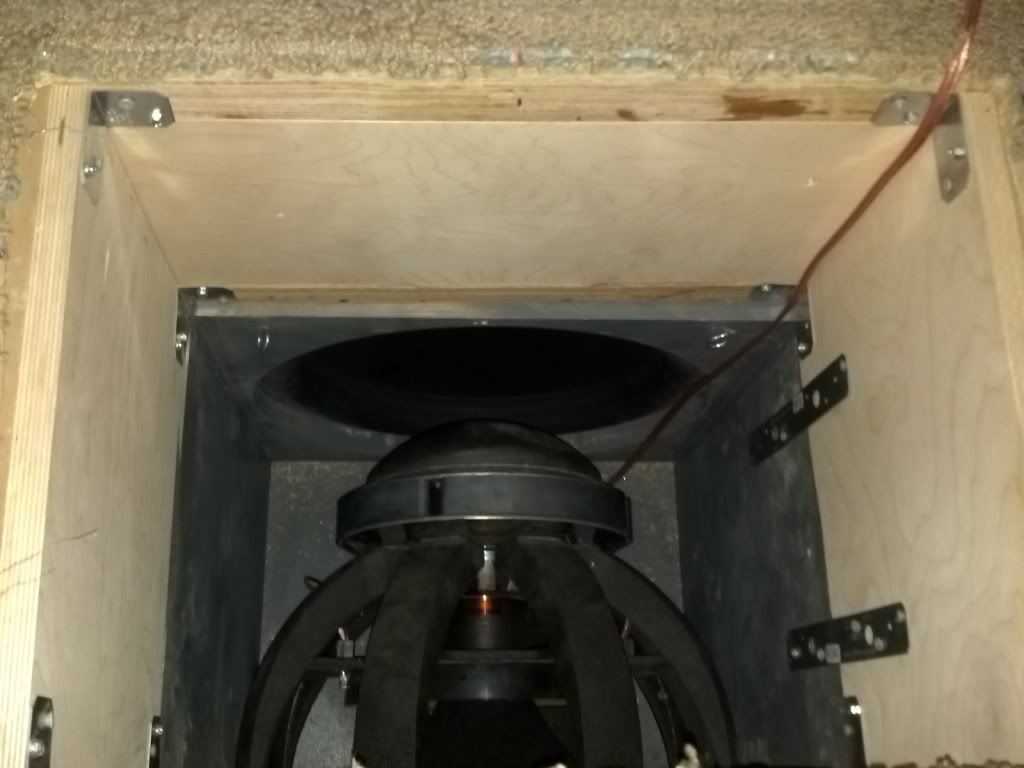

Here is where I'm at. Manifold is slightly tweaked, but solid. I'm going under the house again to add more straps and to put some kind of support under the magnets. Incredible sound so far. might install my 220v 10000q in the closet today.

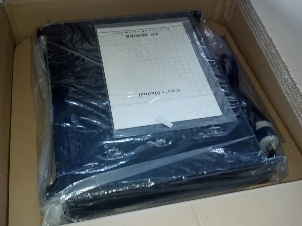

Unboxed the 10000q 220v. triple boxed in perfect condition. plugged it into the new 220v outlet in the closet and comes on. Fans are loud but cannot be heard at all outside of the closet. It came with a monster power cord and a hospital grade 120v style plug. I replaced the plug with a 220v plug. Back to the IB. I don't know how to describe the sound....It's so smooth and effortless and seems more natural. Hard to describe. At the same time it is sooo loud and the whole floor vibrates. Very cool sensation. I wonder how my black widows are enjoying the sound under the house....I think they should take the subtle hint to get out. Anyway, heres a few pics of unboxing etc.

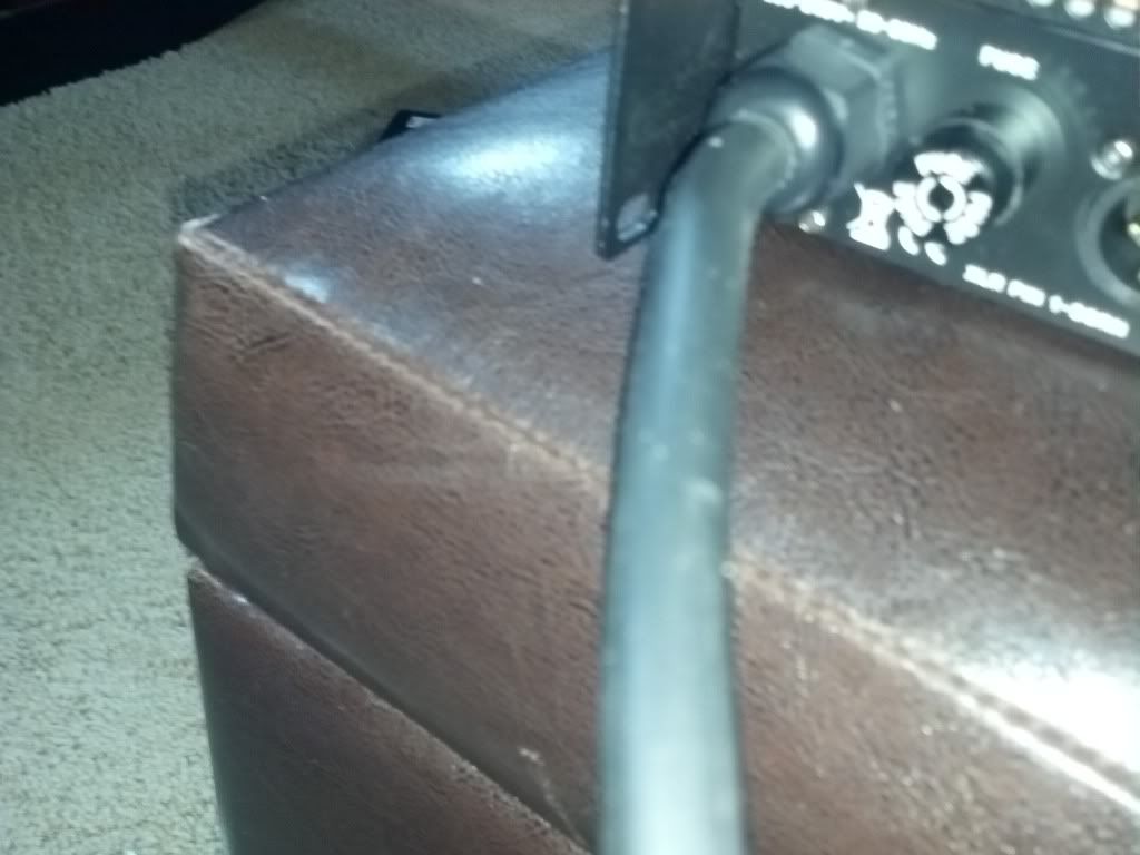

I also plugged in my 220v 10000q amp to the new outlet. Not hooked up to a source or speakers and it fires up ok, but every couple minutes or so, a relay clicks, the red light flash very briefly and the fans kick on high for just a second. I emailed Johnson and hope to hear back soon as to if that is normal. I couldn't hook it up to the subs because it uses ONLY speakon terminals for outputs, not binding posts like the 14000. Of course nobody stocks speakons locally. Much of he weekend was spent dealing with "issues" like these. Booooo

Dude, that sucks... One of us should have given you a heads up on the speakon issue.
