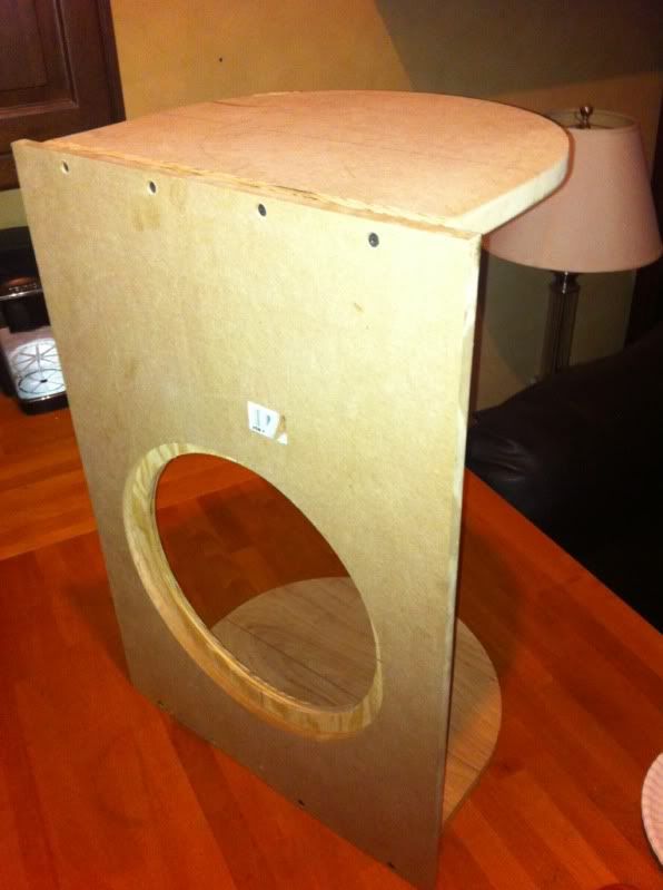

I have to wait for the waveguides to arrive, but I have started the test enclosure. This will be tossed out once the crossovers are completed. I just used what I had laying around so it is a mixture of MDF and plywood. I am going with a curved cabinet.
[IMG][/IMG]

The test enclosure is pretty much complete. I just have to wait for the waveguides from Erich to make the cut out. I also have to drill out for the port.
Its almost a shame to throw this enclosure out.

Awesome looking enclosure, thanks for sharing. I'm looking forward to seeing how it performs and hopefully Rick can provide some measurement data you could share with us too. biggrin.gif
With that particular box size, driver displacement (both 12" driver plus waveguide and cd) will have a greater effect on the final internal volume. Simon on AE forums mentioned .1 ft^3 as a safe estimate for the 12" drivers; he's spot with that estimate with magnet size (1.5L) plus basket etc. With your tuning and extension requirements it probably doesn't matter, but thought I'd mention it.
What are you going to do for the port? Looks like a round 4" port @ 4.5" in length has 1st port resonance of ~1.5kHz, but I’d be interested in hearing what others have to say. For my project, a fellow avs'er mentioned making the port longer and cutting it down closer to calculated size during testing. Seems like sound advice to me...
I'll be doing a very similar enclosure so it's nice to see someone utilizing this particular driver (I think you might be the first with the TD12M and SEOS, which is cool). I can't believe you've had those beauties in the closet for two years!
The cd and woofer are in separate compartments. There is a shelf right above the woofer. The volume of the td12m section is around 1.45 cuFT before the port, driver, etc.
I was going to do a 3" port. Thinking about putting it in the back but then i cant flare it. or maybe putting it under the woofer. I may not have left enough room tho. I could put it on the side on this box and move the woofer up on the real enclosure. I am going to get the woofer and horn closer also.
Just an idea: how about putting the port on the top, with the port tube running through the upper chamber (but with the chambers themselves still isolated from each other)?

I thought about that. Think I have too many nieces and nephews who would be too tempted to throw stuff down the port.
