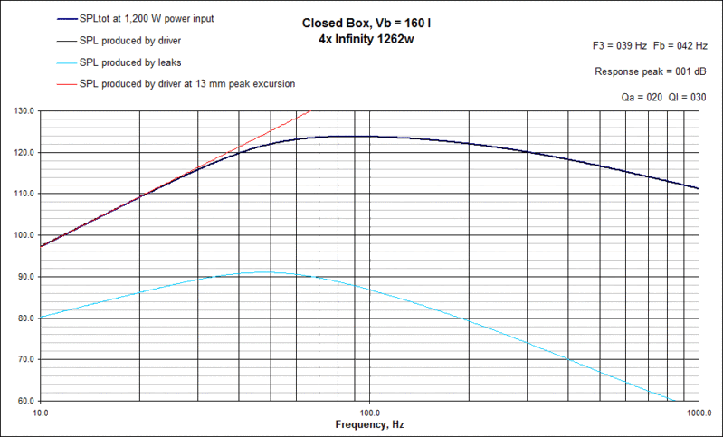

Just did a model with these. Awesome value with performance to boot! However, they model perfectly in a 40liter per driver sealed box with 300w each so with eight you're looking at 115dB @ 20hz but still, pretty nice. Perfect match with a Behringer ep4000.
Scott Simonian is offline
Did you model the 1260 or the 1262? The 62 has 3dB wired 2ohm in it's favor.

Yeah, I modeled the 1262w which is listed as 2ohm on the Infinity site (it's dual 4ohm apparently) so with two in series that end up with an easy 4ohm load. 600w for two drivers @ 4ohm is perfect for an ep4000. You can power four 12's off a single amp.
Hmmm. Bassbox has the 1260w at 105dB at 20Hz. The spec sheet on the 1262 would lead me to believe another 3dB/ driver. Is my reasoning off on this?

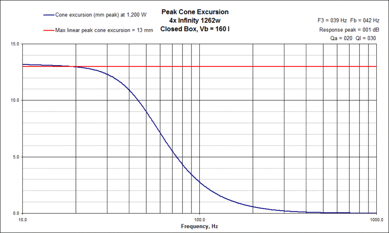

Sorry but I think you got some numbers mixed up. Though you are only off by 3dB so not too bad.
I model up actual displacement at power so ... I'm sure these are pretty accurate.
Add 6dB to this chart for eight (I can only model up to four drivers at a time)
These are 40liter/300w per driver.
