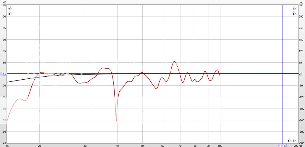

Ok, so after playing with REW a little bit over the weekend, here's the flattest response I was able to get:
No idea what's going on around 40hz. I moved the sub all over the room, and that dip never moved and never went away. I'm not sure if that's a room mode, or something with the laptop interfering with REW?
But, overall I'm quite happy with the way this build turned out and I'm already starting to plan my next venture. Since my room is so large and pretty much open to almost every single room in the entire house, I'm thinking about doing a sealed 18" to help smooth the response out a little more. I've been thinking about the Mach5 IXL 18" in a 4.5cuft sealed box. My box now and the Mach5 model relatively close to each other in WinISD.
Would this be a bad idea, mixing subs like this? I've been reading AVS for a long time and I've seen some people do it and they love it while others have said not to do this.
Baleful is offline

Do a close mic measurement to see if that 40hz null is still there. It looks pretty weird...
Mrkazador is offline

I would think it would change if it were the room causing it unless every position you tried was equal distance from the mic?
kcnitro07 is offline

The final measurement you see above has the sub placed roughly 12ft from the LP. When moving the sub around, I did move it closer to the mic but never any closer than 9ft. I'll do some close mic measurements as soon as I get a chance.
