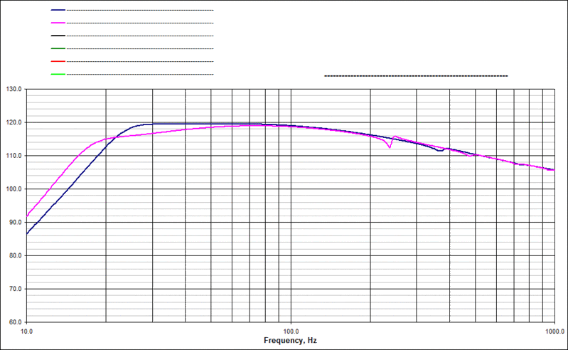

Originally Posted by mikeciccarelli View Post
I was aiming for 20 to 25 Hz..
I modeled this for you. Both are 6cuft, one tuned to 20hz and the other 25hz. Sim is rated @ 1,000w.
