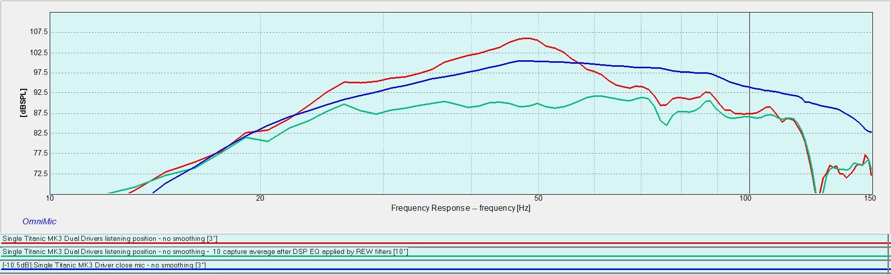

Alright here goes nothing. I'll start with graph comparisons (none with SPL calibrated, but since the SPL is not calibrated in either scenario it should be a an equal playingfield), then I"ll throw in some Build photos.
For those that hadn't seen my previous post that I accidently stuck a screwdriver through the surround on one of the V1220 drivers and replaced it with an infinity 1230W....I did, here is the graph of the V1220, F12 and 1230W:
Here is the Graph of the Daytons UnEq'd:
Here is the overlay of the two above graphs, colors are the same, red is Daytons green is bics + infinity
Here are the build pictures up until some shots of the finish mostly dry:
To finish them, I turned ghetto and turned an old table on its side and sat the cabs one on each leg...white trash? meh...
FInish is a Deck Restore product from Home Depot: http://www.amazon.com/SYNTA-INC-49005-Restore-Deck/dp/B002ZH63HA (was only $39.00 at Home Depot)
I'm a little curious why the SPL levels at 20 Hz are the same for the Bics and the Daytons?? Hmmm

I'm sorry I was being a bit lazy about posting the FR graphs we captured. This weekend I really cemented in my mind how much difference EQ makes. If you read between the lines on this thread you can tell that Nelson was a bit disappointed in the way his new subs sounded at first - especially for music. I would agree, they didn't sound good just dropped into the corners of his room. There was a pretty bad dip between 50 and 70hz no matter where we moved or angled the subs it initially seemed. We moved the subs all over the place in his room - trying different walls, different lengths along the walls, different driver orientatoin etc. We actually found out that the closest to perfect FR graph we could find from a reasonable seating position would be if he moved his TV to a opposite wall, and the couch to the other side. So we did. This move alone made the subs sound much better - even without futher EQ. Then we used the FR captured in omnimic to plug into REW and use REW to calculate our DSP filters for the Inuke DSP 3000 amp. This is a cool function and admittedly I haven't figured out all the bells and whistles, but generally speaking the filter calculators worked nicely as you'll see below. You'll note that in my FR graphs there was no smoothing used.
Blue line represents our close close mic measurement of drivers. We probably had the mic about 2 inches from the dustcap on the subwoofer driver. The blue line looks like it should for a generic sealed enclosure and expected roll-off. I measured both enclosures at the same distance and they were for all purposes identical. The lines nearly perfectly overlaid --- so much so that there was no reason to capture both and it was clear that his cabs were sealed correctly and the drivers were working correctly. The red line is the best FR we could get from the subs at the expected listening position. It typically looked much worse than the red line, but after re-arranging the room the red line was then our starting point to have the best listening position frequency response in which to EQ. The green line is what the 3 or 4 filters on the REW EQ filter suggestion loooked like. The sound change to the DSP EQ setting was tame in comparison to the un EQ'ed sound, but the EQ sounded nice and accurate in Nelson's room. Ultimately the non-eq'ed version sound and eq'ed sound both have their positives. It's just nice to have a somewhat decent FR, even if non eq'ed based on placment alone, and that's the real win here! The subs sounded WORLD's better by the end of the setup time. WORLD's better indeed! They went from a initial dissappointment to an enjoyable sound with just a few hours setup and EQ.

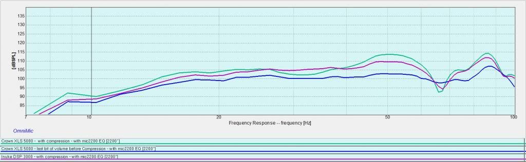

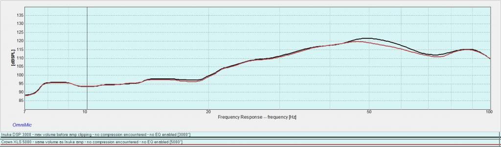

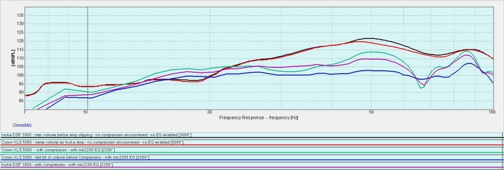

Nelson and I spent a couple hours today comparing my Crown XLS-5000 amp vs. the Inuke DSP 3000 amp on his pair of Titanik MK3 sealed drivers. Our goal was to see if the Inuke DSP 3000 was limiting his pair of sealed 15" drivers in comparison to an amp that has all the power it could possibly need to push the Titanik MK3 drivers to the ragged edge.
Summary:
It appears that the Inuke DSP 3000 is actually a very solid matchup to the Dayton drivers. We determined that when the Inuke got to the point of steady clipping on a naked, un-equed signal, that there was only about 1dB of headroom left on the table before the Titanik drivers themselves started compressing as tested when they had virtually unlimited power on the XLS5000.
The way we tested this was to begin charting the frequency response of Nelson's pair of subwoofers on the omnimic and continue to increase the volume until the subs FR stopped raising linearly. During these tests, the mains were always disconnected, and we were only listening to subs. The omnimic was placed in Nelson's main seating position. We never encountered compressing on the drivers when powered by the Inuke with no EQ applied. What we encountered as the limit was actually a steady clip light on the Inuke amp. This level of full clip while still raining linearly in frequency response is indicated by the black line in the graphic that follows. We switched over the Crown XLS-5000 and increased the volume until we hit the same general SPL based FR curve and recorded that which is the red line in the graphic that follows. On the Crown amp of course there was no clip light indicated, and plenty of power left in the tank. You'll note that FR's are basically in line between the two amps with the exception of a somewhat negligable difference between 50 and 60hz. I don't have an answer as to why this difference was encountered, but it is a small enough descrepancy not to be concerned with --- so it appear that to the point right before full clipping on the Inuke DSP 3000 amp you are getting a nominal output and similar frequency response to a full heavy duty battletank 5000 watt Crown amplifier.
Unfortunately, I didn't catch a graph of what happened next, when we decided to push the Crown. We turned the AVR volume up just a bit to see if the sub drivers had anything left when powered by the more capable Crown amp and the subs started making a bit of bad sound, almost immediately after raising the volume from this point. The clip lights never flashed on the mighty Crown amp all night, but you could tell the Titanik drivers were at this limit as the FR graphs stopped raising linearly when pushed harder by the Crown amp. Summary - The INuke DSP 3000 is a good matchup to the Dayton pair, and you don't leave much, if anything, on the table by forgoing an upgrade to a more powerful amp.
Round 2 of testing. We began testing with the MIC2200 providing EQ. Using the analog dial we were stripping down spl at 65-70hz, and adding juice at maybe around 15hz - 20hz according to the mic2200 dial settings. This allowed a fairly flat EQ line down to about 17hz as you'll see in the blue line in the following chart. This graphed blue line was about the most we could get out of the drivers before compression or some sort of unwelcome, and non linear change to frequency response occurred. How did this 'compression' or non linear frequency response change reveal itself as we upped the volume? We'll oddly enough, it didn't seem to occur at the lower frequencies, but at the higher frequencies instead. Both amps started showing a null at around 65hz, when pushed about 5dB beyond what the last linear increase in SPL was recorded at. You can see in this instance that once again, the amps aren't at fault for the change in frequency response, but rather that drivers were hitting some sort of limit. As to why this occurred at 65hz instead of 10 or 15hz? I don't know. Perhaps someone can offer some insight.
Finally here is a graph with all five captures together
Archaea is online now
