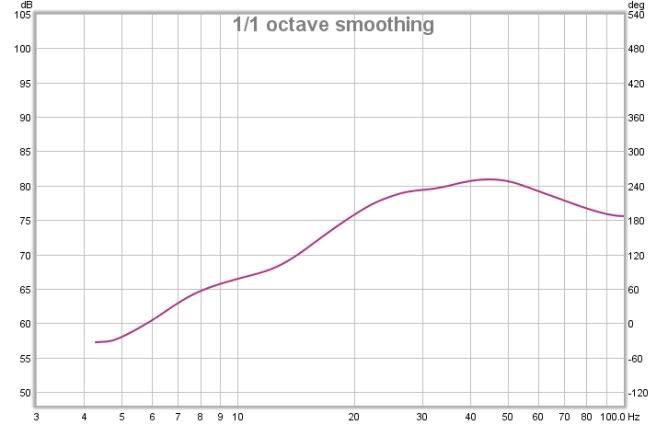

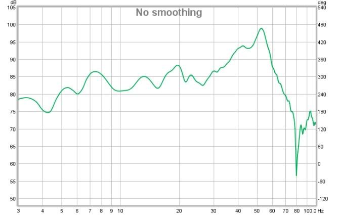

post #107 of 249 Old 09-13-2012, 01:39 PM - Thread Starter
MKtheater's Avatar
Location: New Hartford, NY
Posts: 17,003
Mentioned: 88 Post(s)
Quoted: 1588 Post(s)
Liked: 1116
Calibrated Behringer from spectrum labs(their most expensive), REW, and premobile.
I had posted them before.
Nearfield(NO EQ)
LP(no EQ)
That 52 hz peak is from room, easy to knock down. I am guessing I am getting room gain down low even from the nearfield which I placed the tip of the mic facing one of the dustcaps, as close as I could get it without touching from movement.
Marantz 7702 Atmos
MKtheater is online now

I would not take omnimic seriously under 10hz because when I ran it my 5-10hz range was different everytime. Sometimes low, flat, or elevated. With my new rig this happens from 3-5hz! Above this it is the same every sweep after another. Sometimes 3GS is flat, low, but never really elevated. Turning up the volume really helps because it will compress 3-5hz really early if the volume was too low. The omnimic supposedly now has a true 5hz correction now and mine was the generic 5hz correction.
