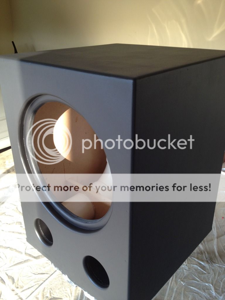

3/4" should be fine. I doubled up on my front because I wanted the driver recessed further.
Here's what mine looked like:
Baleful is offline
