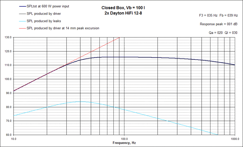

I am planning to have a cabinet maker build dual opposed sub cabinet to match my existing dual opposed sub in walnut finish that has 10.4" drivers. I want another sub in closely matched finish with similar performance & reasonable extension down to 20hz in a 2600sqft room. I am looking at 12" drivers & want to keep the size within 20"x20"x20". Can anybody suggest me the drivers for use as well as enclosure dimensions/plans & plate amp for this? I am contemplating Dayton HF 12" drivers. Want to keep the cost reasonable.

Sure. Go with the 12" Dayton HF's. In fact, they make an 8ohm version which is perfect for dual opposed and that sized enclosure. My models show you could use 500-600w total before exceeded rated Xmax all the way down to the single digits. What amp were you planning to use? A Behringer ep4000 could power this with a single of it's two channels. So if down the road you wanted to build a second, you'd have the amp already installed waiting for more. biggrin.gif

Unless I'm just way off base, isn't the 20x20x20 cube that the OP referenced around 3.5cf internal volume after dual 15" drivers and bracing, or about 1.75cf each?
[(19x19x19) / (12*12*12)] - (~.20*2) right?
That seems about right for sealed applications of a lot of 15s on the market, such as the SSD or Sundown Zv.3 15 or even some of the Dayton 15s?
