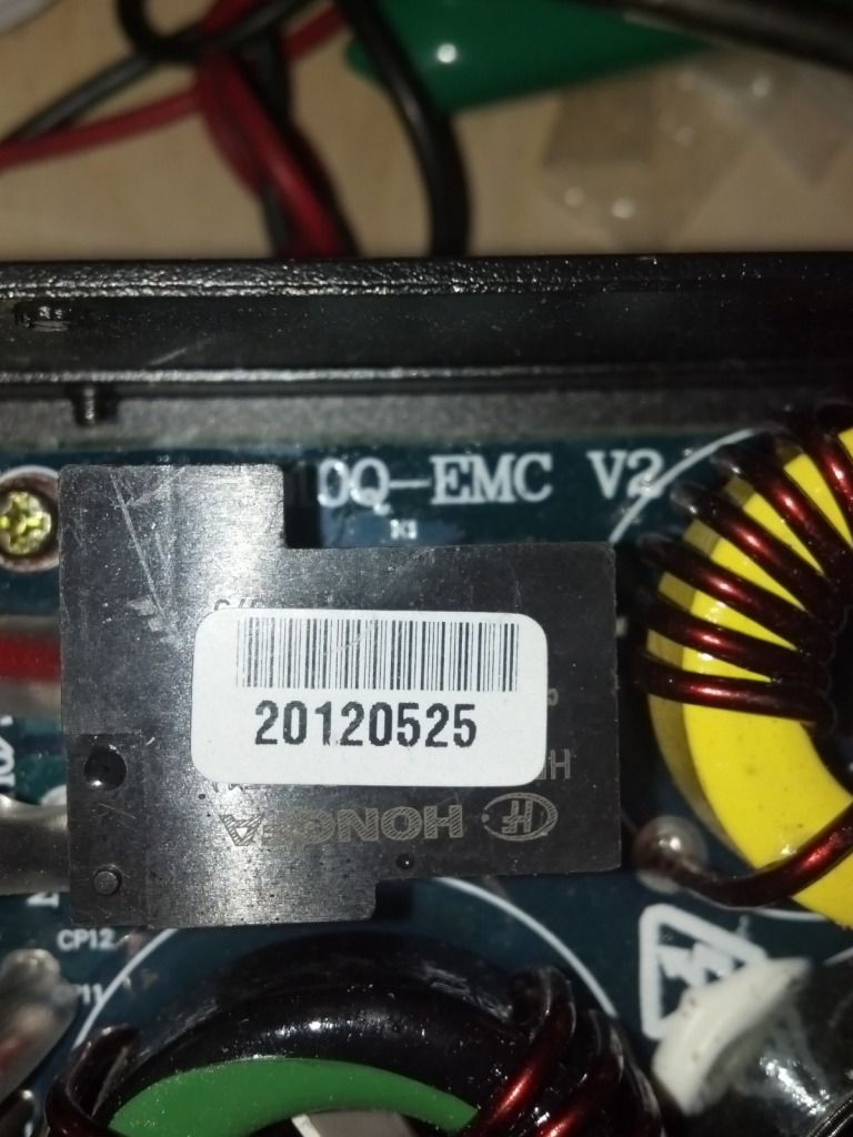

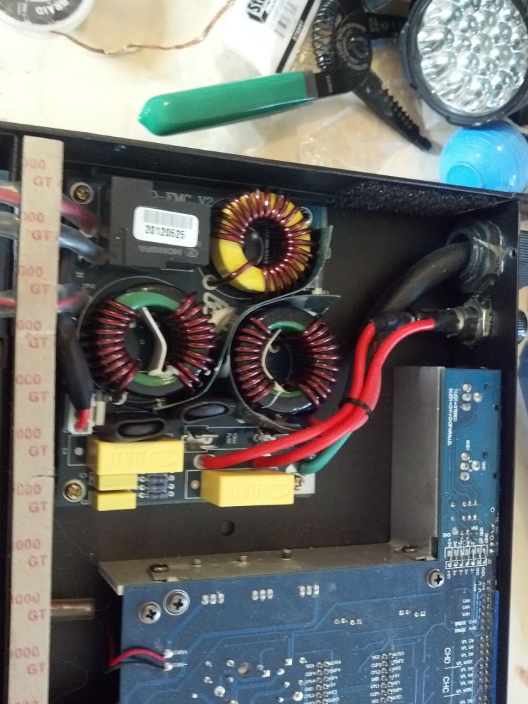

Hey guys. I have had some issues with my 220v FP 10000q clone amp intermitantly clicking off and on since I got it. I have been trying to contact Johnson Tang about getting it fixed, and he stopped replying to my emails a few days ago. Has anybody else been corresponding with him recently? Perhaps on vacation? Just a little worried he's ignoring the issue. I found a video on you tube of the same problem, just mine clicks on and off about every 20 to 30 seconds, and will sometimes go days with working perfectly. Of course the video is in spanish.lol. Sounds like maybe the power supply?

Yeah, the power at the plug is steady and it is pluggged into a relay box. The relay in the box is turning on and staying on. Bypassing the relay changes nothing.

The last email Johnson sent m, he wanted to know the voltage of the large red wire that is soldered to the top of the large circuit board on the left. It said in his diagram 153.5v. All I could measure was about 85v pulsing rapidly. I was just using a cheap multimeter.

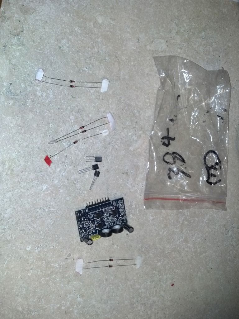

Just recieved email that Johnson is shipping the suspect diodes etc. He attached an invoice in the email that had an amount of 10 dollars. I replied aking him if he expects me to pay for them and have not heard back. I certainly hope he doesnt want me to pay for them.

Johnson sent the components in question via DHL and will be here in a few days. He said he will provided instructions and specs for testing/replacing

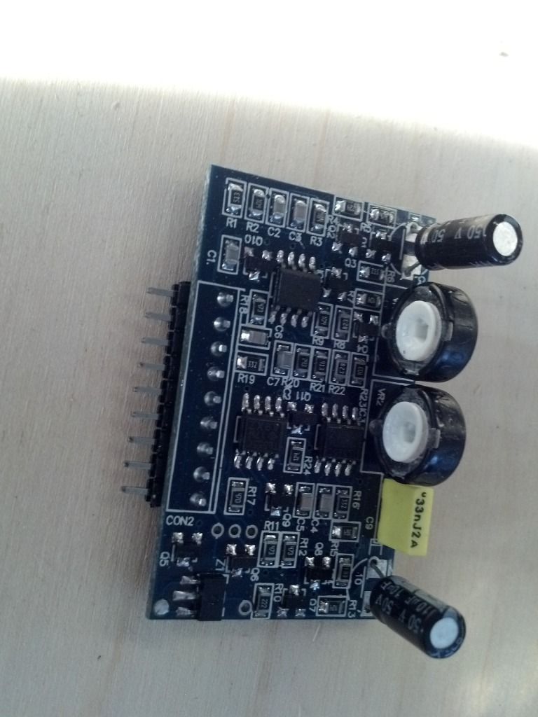

Here is the components Johnson sent to fix my amp. The parts are tiny, and will be a challenge to solder onto the board without damaging anything else. Waiting for him to send instructions and some specs to test the old parts.

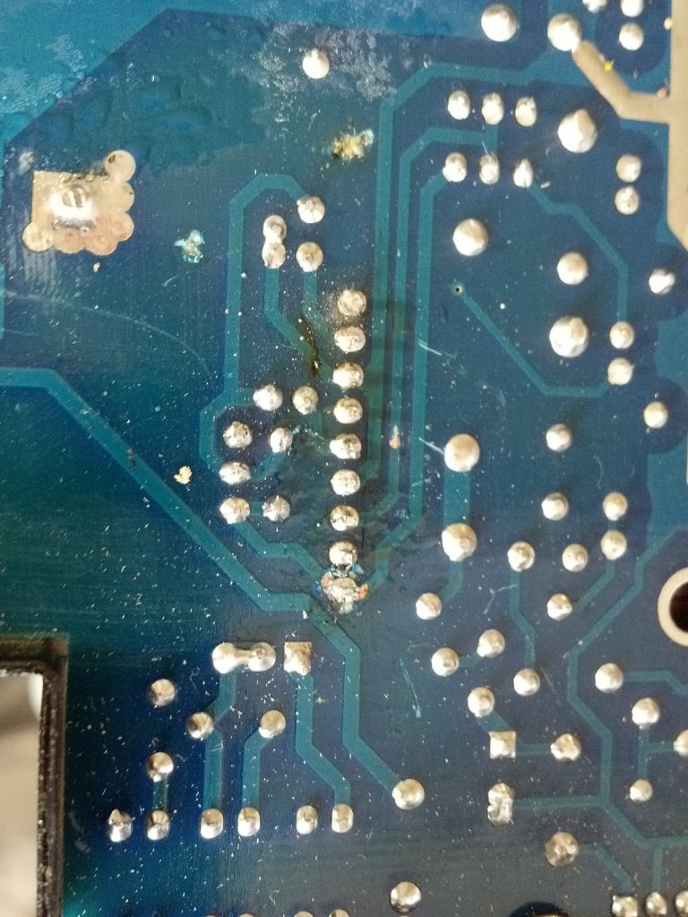

Well, I am in the middle of surgery with my amp. I have all the diodes in place and ready to solder, but I'm stuck and need a suggestion. The ast componet to replace is a little mini circuit board with several pin terminals soldered into the main circuit board. it is a very congested area on the board from above and hard to get my hands on the top of it. What I am having trouble with is desoldering and removing the old part. I don't have a way of heating up all the connections at once to pull it out when the solder is molten. I tried "wicking" the solder with some copper speaker wire and have not had any luck. These are very tiny terminals. Would I need to go get a desoldering bulb, or any other suggestions. See pictures.

I'm still at a standstill trying to remove this last part. I got some desoldering braid and it just doesnt quite get all the solder out. I ordered a desoldering sucker outer "gun" which looks like the only other option. I tried holding a thick piece of copper across all the pins to heat them at the same time and it just wont get them hot enough. They are really tiny pins. I'm open to other suggestions.
since you already got the pcb out i would really suggest you to bring it to someone that has a desoldering station.
an electronics repair shop that deal with surface mount component should have the station. i see quite a lot of handphone repair shop have some sort of SMD rework station that will have desoldering capability integrated.
with a desoldering station it'll take 15-30 seconds to cleanly desolder and remove any and all solder lead to all the pins.
desoldering with a sucker will also get the job done. but heat the pins too much and you could easily lift up the trace. and some pin are dead hard to remove by just using a sucker.
if desoldering sucker outer "gun" that you mentioned is indeed a self-heated desoldering tool then just wait till that arrive and use that. beats having to rectify lifted trace.

The PCB isn't "out". Its just accessable by removimg the top, bottom, and front covers. The thing I ordered is not self heating, but it looks similar to the blue tool you have in your last post. Not an ideal situation, but I believe I can make it work. Thanks for your advice and expertise.

Well I finally got the last component replaced. It wasn't pretty, but I am able to measure with an ohm meter that there is continuity from the respective printed circuit to each terminal. That was the good news. The bad news is, I plugged it in and the relay in the photo below just clicks continuously. About one click per second and the front panel lights come on just like its powering on each time it clicks, along with the fans. The pcb that the relay is mounted to goes straight to the power cord, fuse and switch. I carefully examined everything I can see, and doen't see any bad solder connections or things connected that shouldn't be. Another email to Johnson....C360_2012-09-15-08-44-04.jpg
