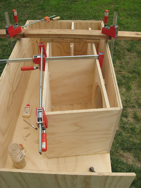

Started my rendition of lilmike's F-20 today. Obviously the sizes are exactly the same. Picked up the 15" driver on sale from PE.
I went with rabbit joints on the carcass and will biscuit the fold:
I got smart after my last subwoofer build and didn't route the rabbits where I didn't need them:
Starting the fold:
Tim

the biscuits aren't necessary, as the right glue will be stronger than the wood at the edge. i've never even heard of a horn panel "blowing out" when glued in. the weak point is the center of the panels...they will vibrate like drums and suck energy out of your build. the place to go overboard in a horn is the bracing, not the joinery. :-)
About two decades ago I did a bit of building.. furniture, cabinets etc. Nothing major, but I have an interest in woodworking. These projects are the first I've done since then (excepting basic trimwork, door hanging etc), so beyond the pleasure of a new sub, the journey is just as gratifying. Some guys spend hours on a piano black finish.. by obsession is joinery!
In short order I will be making a new built-in entertainment center, so getting back into sync with the tools is a good thing.
Besides, the biscuits make it really easy to get the pieces lined up smile.gif

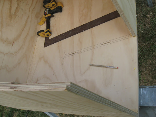

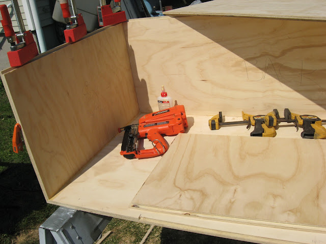

I wanted to add some bracing at the unsupported ends of the folds. I used a single piece of 3/4 ply 2-1/2" wide. The brace goes thorough the second fold (the one that is 90 degrees) and joins to the two outside folds:
Like a glove:
I made a 1/4" recess for the driver so I could line it up properly:
Things are starting to move.. working time of the glues starts to become an issue:
All the folds finished:
Just need to add a brace on the backside and the mouth, cut the access hole for the driver and closer her up.
Tim
