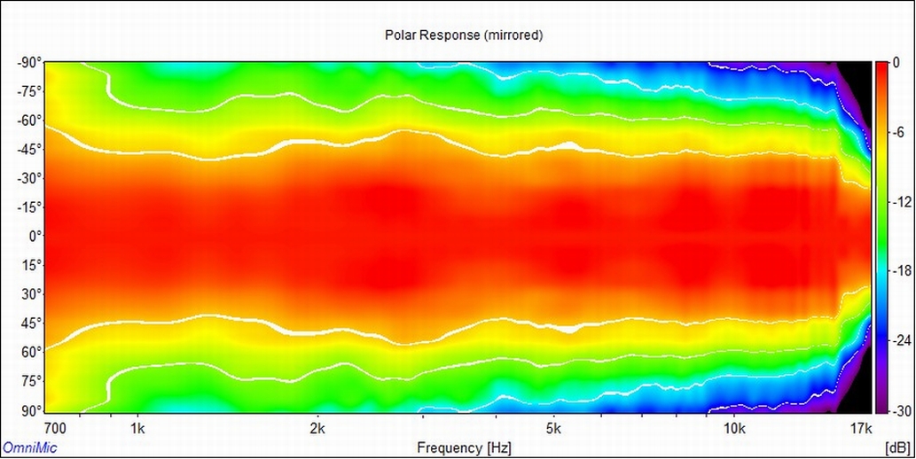

Quick update on the measurements confusion.
Based on what I know now, I believe that the jzagaja's measurements posted on Auto-tech SEOS-12 product page are most likely incorrect.
I do not think the chart was mislabeled because that just does not happen by mistake, all the labels are generated by the software.
More likely explanation in my opinion, which jzagaja seem to share, is simply imprecise positioning due to wrongly calculated acoustic center or angles. As MBentz pointed out, even small mistakes at such a short measuring distance can lead to significant measuring errors.
Another reason for my conclusion is that there is a more recent set of measurements that jzagaja performed, this time using B&C drivers and measured at a larger distance. They look very much in line with BWaslo's measurements.
jzagaja kindly allowed me to share the ARTA files, attached.
DE250.zip 3257k .zip file
Here's is my attempt to plot a directivity sonogram using the data.
My ARTA skills are limited at best, I could not figure out how to change the degree axis to a more useful scale. But even at this level of details it seems to be very close to Bill's results, which is to say both measurements show SEOS12 as roughly 100 degree horn, slightly wider than the 90 degree target.
I do not want to overstate the difference 10 degrees make. LTD02 has argued rather convincingly that it does not. My opinion is that it is application depended.
Edit: to expand on my last point, in large rooms or outdoors the wider beam width may be an advantage. In small rooms typical for HT, all else being equal, horns with tighter directivity control are a better choice. A problem with LTDs chart, in my opinion, is that it assumes 45 degree toe in. If my experience is any indicator, 45 degree toe in is rarely an option, most people use less aggressive angles.
Here's Wayne's take on the subject

I've been gone for a bit so I just noticed this recent discussion.
First, Zheka, yes those early measurements by Jzagaja were incorrect. I don't recall if the measurements themselves were flawed or simply the chart. We recognized this when he posted them. I assumed they had been corrected. Anyway, Bwaslo's measurements are the reference measurements IMO. They show a 90deg horizontal dispersion over their usable range. That was the original design specification and the achieved measurement.
Second, I've been involved with the SEOS since the first couple of posts. I've built Pi 4's with H290s and Ewave Deluxes. I had many discussions with Zilch before his passing. I've designed crossovers for horn based speakers and used Pi documents as a piece of my reference material each time. I've also pointed people towards Pi3 and PI4 speaker plans and kits, even in the SEOS thread. There is no animosity from the SEOS crowd towards Mr. Parham or Pi Speakers to the best of my knowledge. The only "bone to pick" was an old quote attributed to you that panned the SEOS. I don't know if the quote was accurate and I'm pretty certain we explained it away due to the aforementioned botched measurements.
Third, Wayne, I believe you are making some assumptions about the SEOS design that aren't true regarding its profile. It is true that it does not fit an exact catenary function, it is quite close and we found this was a slightly better compromise. Like with any design process, two different designers will have different priorities and different views of the data.
All in all, the differences between the the SEOS and H290C pale in comparison to their similarities. When I find some time for more speaker projects I'd like to get a few H290Cs to try next the SEOS and QSC waveguides I presently have.

Originally Posted by coctostan View Post
. Anyway, Bwaslo's measurements are the reference measurements IMO. They show a 90deg horizontal dispersion over their usable range. They show a 90deg horizontal dispersion over their usable range. That was the original design specification and the achieved measurement.
With all due respect BWaslo's directivity sonogram clearly shows that the -6dB contour is over the 45 degree mark for most of the 1.7kHz to 6kHz range, reaching approx 55 degrees around 3kHz.
This may be of little or no consequence in terms of performance but it does contradict the claim that SEOS is a 90 degree horn.

post #102 of 196 Old 08-14-2012, 02:07 PM
bwaslo's Avatar
Location: Portland, Oregon
Posts: 916
Mentioned: 17 Post(s)
Quoted: 66 Post(s)
Liked: 182
That sure looks like an average of 45 degrees to me. Youre upset abouta dB of wiggle?

post #103 of 196 Old 08-14-2012, 02:14 PM - Thread Starter
zheka's Avatar
Location: Chicago burbs
Posts: 1,105
Quoted: 29 Post(s)
Liked: 26
is that how the beam width is measured, by averaging the results?
zheka is offline
post #104 of 196 Old 08-14-2012, 02:22 PM
bwaslo's Avatar
Posts: 916
Quoted: 66 Post(s)
Liked: 182
Well its about as close to being an 80 degree as it is to a 100 degree width, right? Why do you pick the peak rather than the minimum? 90 is the closest answer. Below 300 Hz its going on to 360 degrees....

post #105 of 196 Old 08-14-2012, 02:31 PM - Thread Starter
zheka's Avatar
Posts: 1,105
Quoted: 29 Post(s)
Liked: 26
Because that's the convention AFAIK.
to be fully consistent it should be called a 110 degree horn but I felt it would look like I am overstating my case

post #106 of 196 Old 08-14-2012, 02:33 PM
bwaslo's Avatar
Posts: 916
Quoted: 66 Post(s)
Liked: 182
convention?? Sez who?

post #107 of 196 Old 08-14-2012, 02:54 PM - Thread Starter
zheka's Avatar
Posts: 1,105
Quoted: 29 Post(s)
Liked: 26
That is a good question actually. I honestly do not remember where I got it from. Perhaps LTD02 remembers offhand?
zheka is offline

What hasn't been mentioned is that:
1. A cross over may take that "hot spot" out of the 3khz region; and
2. The horn holds that -6db at 45degrees pattern down to 800hz!!!
Gotta think about the forest when in the trees some times.
Ryan
tuxedocivic is online now

post #110 of 196 Old 08-14-2012, 04:11 PM
LTD02's Avatar
Join Date: Oct 2003
Posts: 20,407
Mentioned: 411 Post(s)
Quoted: 2340 Post(s)
Liked: 2573
"That is a good question actually. I honestly do not remember where I got it from. Perhaps LTD02 remembers offhand?"
the convention is based on the -6db point off axis. if a horn is down 6db at 45 degrees to one side and is symmetrical, then it will be called a 90 degree horn.
in the o.p. in the "rallying thread", there is a 12" seos with de250 on it. off axis lines every 7.5 degrees. counting up from the bottom gives a hair over 45 (including the white line that is really tough to see), so 2x a hair over 45 could be called a 90 or a 100. it really doesn't matter and you won't hear any difference.
Listen. It's All Good.
I am glad that the convention does not mention any averaging. There are probably many bloomy horns with severe waistbending and HF beaming that,when averaged, could claim to be 90 degree.
Calling the beamwidth from the widest -6dB mark is a good and objective way to gauge directivity control. All the relevant averaging is already done in the form of smoothing and on-axis normalization.
And I'd appreciate if you agree that SEOS is a 100 degree horn simply call it such.

Originally Posted by smokarz View Post
Then what are you arguing?
I am arguing that SEOS is not a 90 degree horn

Erich
I have not exactly come over to the "rallying" thread to poo over the SEOS and push the competing design. Come to think of it, quite the opposite has happened.
Whatever claims I made were always modest and, I like to think, well supported.
You on the other hand failed to dispute any of them on merit and instead accused me of bad faith, incompetence and ungratefulness .
There is something very disappointing in seeing somebody of your fame and stature trying to roll over a nobody like me with a lawn aerator.
The biggest difference is the elliptical vs. rectangular profiles.
Besides the former looking nicer, I've always wondered whether the internal corner formed by the intersection of latter's horizontal and vertical profiles create acoustical warts like reflections or irregularity in the radiation at the "corners" of the wavefront.
Noah
It's a nominally 90 degree horn by design. It measures pretty damn close to a 90 degree beamwidth over a wide bandwidth - nothing to do with "averaging". There are narrow peaks and dips between 100 and 80 degrees.
If you want to call it a 100 degree horn, go for it! It's however rather abnormal for horns to be called anything but 120 / 90 / 60 / 50 / 40 and sounds like someone trying to downplay its effectiveness in order to push whatever agenda they have. what it isn't, is a 120 degree horn like Wayne has suggested in the past. Nor is it a < 60 degree horn like some prefer. You'd "appreciate" people calling it a 100 degree horn? Why is that? In what way does it affect you?
I hate to say it, but I too am getting the sense that you're trying to justify your purchase by putting down the other choice. In reality, the most important thing is that the directivity is matched in the crossover region, and for a speaker like this, that it is sufficiently narrow to reduce side wall reflections. Beyond that you're splitting hairs, and this is a bit annoying coming from someone not using the SEOS to design a speaker, but rather someone who didn't buy a SEOS in the first place.

thirty minutes later......
Unless im reading it wrong then i dont see much of a difference in degrees.

wrong 50 degree mark of H290C chart. your line is about 40 degree or so. please correct it.

I did it again and its the same thing..... the black ticks mark 0, 20, 40, 60.
My white lines are indicating 45 deg and 50deg
My lines are correct
Lets have an overlay
