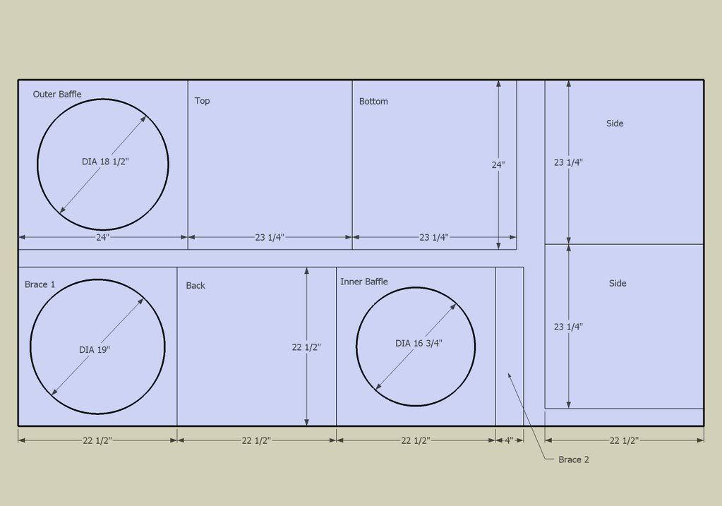

I saw that you had posted this in another thread (can't find it) but I had downloaded this:
I'm having a hard time calculating the volume of this cut sheet.
Is this 6cu.ft?
Will this work for the FTW21?
Do you have to do 1 1/2" thick all around?

Ya those are the ones I built, they are perfect for the FTW 21. I used 3/4" mdf double baffled front and back with a bit more bracing, though the extra bracing it's not really needed. If I remember it's 6.2 CF or close to that with driver. They were a Neo Dan easy build.
Thanks again for your help.
I will start building my 2 boxes soon.
One last question...the outer and inner baffle cut holes dimensions look to be for an 18" driver?
If yes then what are the cut hole sizes I need to do for the FTW21?
