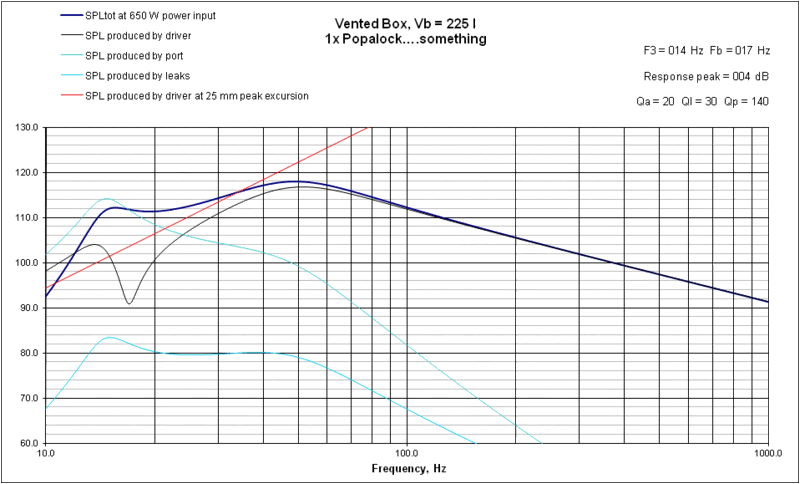

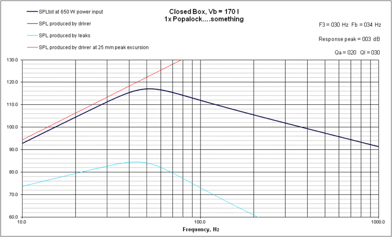

I'm still learning the ropes and I'll try to get spun up on modeling at some point in the near future. In the meantime, can anyone model this for me?
Based on the specs and modeling alone, what would you directly compare this too? I'm trying to see what compares from a price/performance standpoint. I haven't gotten a price on this yet, just in the research phase.
Let me know what you guys think, or better yet, if this sub looks familiar?

Thanks man. I'm going to have to invest some time into learning modeling software soon... Scott, I know you've done a lot of modeling, so when you say "basic sims" how would you compare it other subs you've seen? I mean, would it come close to comparing to the MFW 15" or the TC Axis 15"? Does anyone think it would be worth me dropping like $350 to run it through it's paces in my space?

In this case, when I say 'basic sim' I guess I meant '1 minute sim'. Lol. I just picked an arbitrary power input, something that sounded reasonable. In this case, one half of a Behringer ep4000 and then modeled up two alignments that looked pleasing enough. I could spent more time and make a couple more fully optimized systems if needed.
Compared to...? This seems better than the MFW15 but ...you know I forgot, I didn't see an Xmax rating so I put it at 25mm, iirc. *shrugs* So depending on that... yeah, idk. This isn't really up to the Axis cuz that driver has a much lower Q and more powerful motor. Output wise, maybe similar.
Personally, I don't know enough about it to drop $350 on it. I wouldn't. I'd need to know more about it first. Do you want to? That's really the important question.
