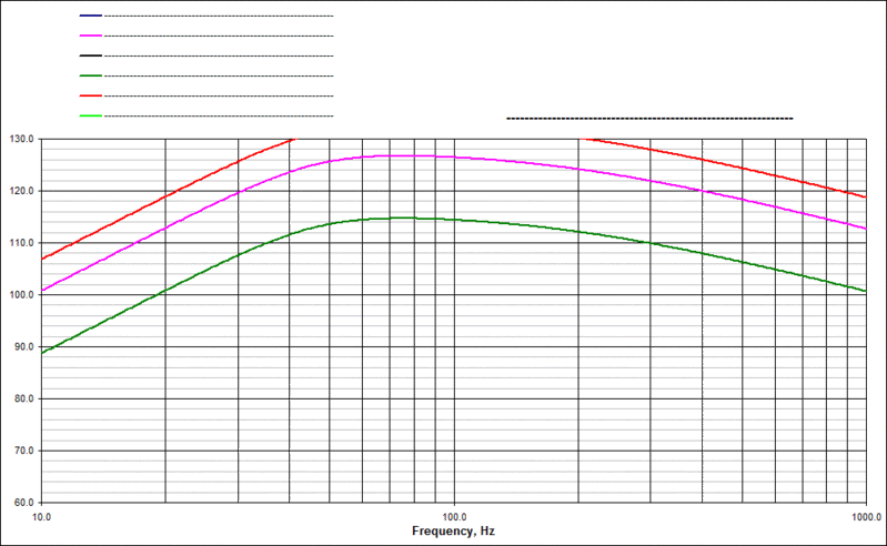

Smokarz and anyone else in the same boat....
I made this comparison sim for you. This is a simulation of 1, 4 and 8 MFW15's (or equivalent). The simulation is run at 300w per driver which in this particular system hits Xmax with no overshoot, giving the owner safe extension down to the bottom single digits if the electronics signal chain allows for it. This should show you why you may feel that there isn't enough output. The bottom line is just a single and if you have quad 15's, one each in the corner you may not see a ton more output than the single. It depends. Same with the middle line which is four. You very may get this kind of output of they are all co-located. The last sim suggests eight of these drivers.
Scott Simonian is offline
Thanks SS.
I got 4x MFW15 lining up my front stage.
That graph suggests I should be getting 120db down to 30hz, and above 110db at 20hz. That should be more than enough for the average listener.
Also, I believe that's where most of the bass lies in the typical movies.
Not sure why I am still feeling bass inadequate.
