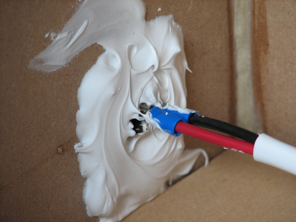

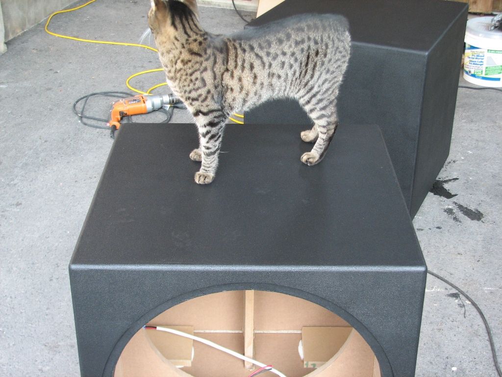

Well the 4 cabs are done...
Put caulking on the inside of the cabs where the speakon is to make sure it's sealed properly.
Last 2 cabs done and approved by Kami.
Now I wait and can't wait to see how my Double layer Sheetrock with Hat Channel and Green Glue hold up!

Originally Posted by N8DOGG View Post
I like my subs in the back also. When properly setup, you can't even tell the bass is coming from back there. Gotta love the impact! biggrin.gif
You were right N8, stacked rules in my case and the impact is insane!
I just love when I close my eyes and all the sound is in the front...it amazes me!
I can't wait to play with the MiniDSP.
Originally Posted by benclement11 View Post
good looking cat. i really want one like that...kind of spendy(for a cat) around here though. I also feel bad if I get a pet from somewhere other than a shelter. i might break that though to pick a cat like that up one of these days.
Thanks, There's, I believe 3 types of Highland Lynx cats. the one I have are the rarest of them all. (No tail whatsoever)
I would be surprised if you found one at a shelter and plus you'd be paying 4 times the price then buying from an individual.
My vet has been in the industry for 25+ years and he never saw one till he saw ours.
