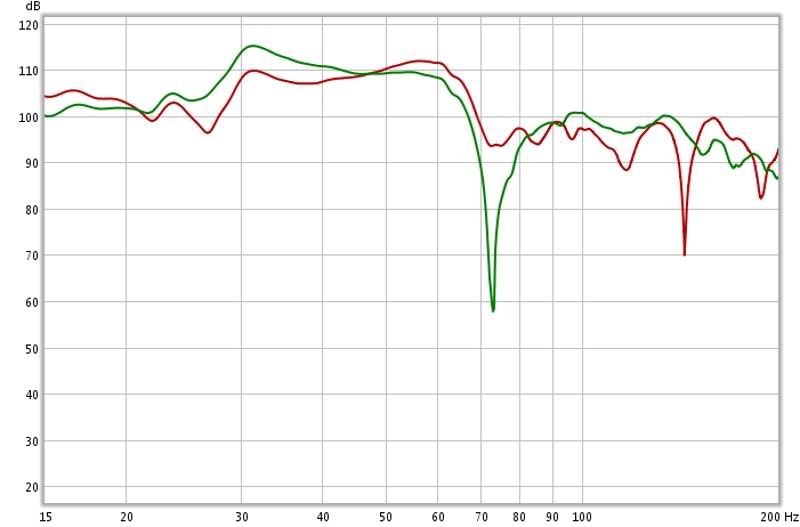

Got the MiniDSP today and have been playing with it a bit now so I have a pretty noob/basic question.
1st of all just wanted to let everyone know so that I hope nobody goes through what I did.
I wasted about 5 f%&& hours of my life today trying to get this thing to connect. Extremely frustrating.
I tried 9 different 12 volt plugs. every single one I cut and connected. Went to the store and bought some for nothing! All that to find out that the problem was the &^%%$^$^ USB cable they supplied...it was defective!!! As soon as I changed it every single plug I tried worked!!!!!
Anyways...
I'm boosting the low end and am wondering if anyone can give me some sound advice on the "don't do that" or "that's OK" type of thing.
Right now I'm finding a sort of sweet spot (by ear of course) and am sort of wondering if it's OK or not to do so.
I've put the following on the EQ output:
10HZ +7DB
20HZ +4DB
30HZ +2DB
45HZ +0.4DB
60HZ +/-0DB
75HZ -2DB
This sounds pretty dam good to me.
IS there anything else I should know?
Should I be worried with a gain of +7DB on the 10HZ scale? Is it too much?
many thanks in advance

Without REW results, you'll never know. That being said, 7dB is quite a bit but if the amps not clipping and the subs not starting on fire, you should be good to go biggrin.gif

Someone else back me up, but I've always read that is is better to cut vs. boost. As Natr mentioned, it's hard to tell where you are at without measurements. Once you get your measurements you should (in theory) be able to make higher cuts to your 60hz & 75hz region, thus reducing the need for the 10hz boost.
Am I making sense?
Am I making sense?
Well, that's exactly it...Stupid me, I played test tones from 10 to 90HZ (increments of 5) and now have totally changed my settings.
popa is right, I have max boosted @ +1DB for the 20 and 45HZ and now have -9DB on the 80HZ tone.
I adjusted every single test tone till they were all at the same volume/output with my ears of course.
What's driving me nuts is I can't figure out if I should keep the Polarity inverted or not.
Is there a trick to know which way is best?
thanks

post #351 of 356 Old 10-16-2012, 11:44 AM - Thread Starter
Fatshaft's Avatar
Join Date: Feb 2001
Location: Montreal, Quebec, Canada
Posts: 1,596
Quoted: 273 Post(s)
Liked: 342
Originally Posted by beastaudio View Post
Your subs are sealed, a nice low end boost is a good thing, not bad, you just have to do it right. It is called an LT boost or Linkwitz Transform. I'm not familiar with the Mini but I bet there is an option to have one of those applied to your signal and it wont get you into trouble. It is true that cutting is better than boosting, but not in the case of the sealed LT boost I just mentioned, it is necessary to get some more performance out of any sealed setup down low. Room gain gets you part of the way there, but a proper LT will transform that system completely...again!!! I will repeat myself for the 3rd time, it has to be done right, and I hope someone chimes in on the Mini's ability to do this. You seemed pretty close with your initial settings, but 7db could still get you into trouble. Then again, we can't really tell you for sure because we dont know if you are running the subs hot, cold, stale, or any other way right now.
As the others have stated, you have way too much capability to NOT have a measurement system. Your ears are your ears and always do what sounds best to you, but you REALLY REALLY need to get something to actually SEE what your system is doing. boosting and cutting and whatever else is all in vain if you can't actually see your response.
http://www.parts-express.com/pe/showdetl.cfm?partnumber=390-792
JUST DO IT
Beast, thanks soo much for your input and I would like to apologize to you and everyone else here.
I realize that I'm asking for guidance but on your end it's like shooting in the dark cause nobody knows my settings.
I totally understand that a graph would speak volumes so I will try to do a graph by the weekend.
This stuff is overwhelming for me but I have no choice to learn it.
I realize that this would help everyone here especially me!
I know what to ask for this XMAS...thanks for the suggestion.
I would like to share a graph he had done about 2 years ago with my 15's and BEFORE I redid my whole HT Room.
IIRC, green was with the fronts on Large and red with the fronts X'd at 80HZ.
I'm hoping to give you a graph like that by the weekend...thank you all for all the help again...I appreciate it!

Here is the MiniDSP page for more info on an LT which as beast already suggested would be the preferred boost to use for the low end: http://www.minidsp.com/applications/advanced-tools/linkwitz-transform

Not too shabby smile.gif I will almost guarantee the FTW's will keep you from having that slight drop from 30hz on. That graph also helps me to understand that before you had these wired up, that you had heard pretty substantial bass in your space before smile.gif Often times people are shaken by their first bass experience, and who knows if it is just a good 100db sub system or a 125db sub system, there is a big difference!!! Now I realize that your impressions are that these are far away better and more potent than your old 15" system so you really made a worthwhile jump smile.gif
I hope you didnt think I was upset you couldnt get readings for your response. It just really does help all of us that can't hear what you are doing. I'd almost send you my omnimic so you could play and tweak for a little while, but I need it right now to measure the new additions myself smile.gif
