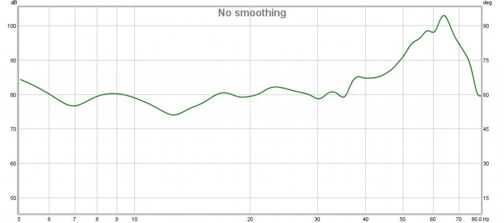

Edit: Also, what side round over bit was used on the driver cutout? Sorry if I missed it.

Been really busy with school - lots of papers to grade and to write! However, I do have new measurements. The hump at 60-70hz seems higher, although I measured without the tops, with the subs on their sides, and everything to eliminate the bandpass function of the floor and the tops, and it didn't change response at all. I think my room just sucks. Maybe I should do a close-mic measurement.
Starting point (ugh)
Here's how EQ turned out.
I think I can do a little bit better with more time, but I get tired of working on my tiny 11" screen laptop. I think below 5 or 6hz can be disregarded, as the mic isn't calibrated that low. Between 5-10hz, the cal file shows near consistently greater -dB at each frequency going down. Perhaps I could determine what the logical cal for 4 and 3hz would be and add them to the cal file based on the slop from 10-5? Eh, who knows.
