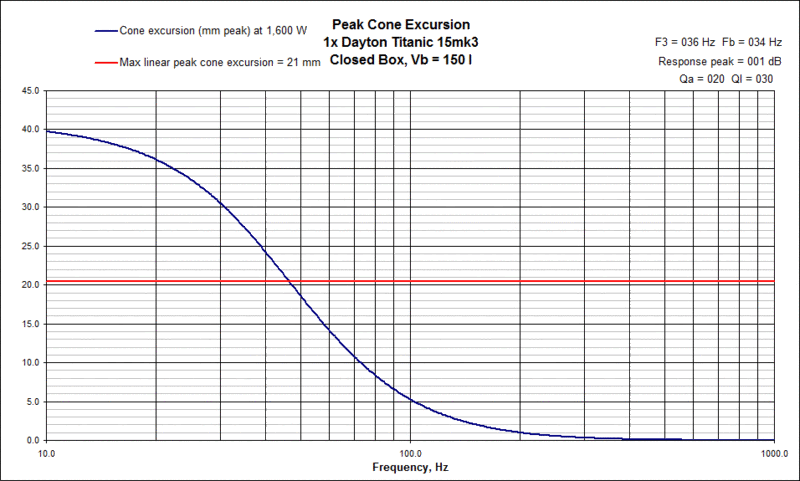

I made a simulation of what 1,600w would do to the excursion in your enclosure. You could easily power TWO Titanic Mk3's with a single ep4000.

Someone calls me a 'Quick Draw'? Really? I thought I was called 'Sub-bass simulation McGuillicutty'. *laughs* jk tongue.gif

The drastic reduction of space to pressurize, in addition to implementation of acoustical treatments/bass traps, will have a more signifigant impact vs. adding a few more subs to your auditorium... Sound proofing your room will definitely please the wife when you feel like playing. Especially if you let all of these ULF freaks influnce you into stepping up your displacement game...
1/4 of your space is still double my 13 x 14 space and I'm running two measly 18's... If I didn't have anyone to answer to, I'd have at least 8 myself!!! As it stands now I'm trying to slow play 2 more...

All good, I am still learning. Are the specs of those FP 1400's real? Or did I have too much scotch?....wow
I attached some pics, I am currently using the Mirage M3's as my mains, but as you can see I have a pair of Peaveys I hook up once in awhile. I have an old SAE A502 I am using to drive the Mirages right now, and the two euro4000's for the subs. Right at the edge of the "dance floor" and the sunken pit is where I would build a wall the whole way across, then move the whole mess over to the left wall (if you look I have my projector screen on left wall anyways). I will keep everyone up to speed on my new project.

I would be worried about having too much scotch at your place and then taking a header on my way back to the bar eek.gif I am a bad drunk though biggrin.gif
That room would be tough to get loud levels of bass, you have the right idea in closing it off. If not then a Pro type bass system would make more sense which sacrifices some low end for more volume.

It's a very good possibility that those subs are too far away from the corners to take advantage of any loading. First thing is to move them.
+1, they need to be less than 3 feet from the corners, and will work best aimed into the corner from about a foot away. Hoffman's Iron Law also applies, for subs to keep up with mains they need to be at least twice the physical size of the mains. A pair of fifteens don't stand a chance, you need at least four.

I did have them in the corners, but not FIRING into the corners, and I had them in tight to the corners not out a foot, I will give that a try tonight. Thanx again everyone. I am looking into a twin 18" vented project using Seleniums. I REALLY do not want to reduce the size of the room......kinda makes the place. Maybe, just maybe two18's will get me a little closer to what I want.

The difference between two fifteens and two eighteens is slight, perhaps 3dB. Adding two more identical fifteens will get you 6dB, and offers the advantage of more placement options.

All good advice so far.  Since you listen to jazz dominantly and haven't expressed any interest in UULF I would also just recommend considering ported/horn alignments for your subs.  The sheer size of your room works against you in terms of any cabin gain to help out the sealed subs reach ultra lows anyways.  IMO, with a room that size your best served to pick as low a tuning frequency as you can spatially accomodate, and maximize your efficiency down to that point.
What are the dims of your sealed enclosures?  You may be able to retrofit your enclosures with porting and since you already have eq it would only cost what you spend in PVC pipe.

Current "OUTSIDE dimensions are 24 in wide, 22 high, 22 deep. I have a ton of internal bracing, and taking into account the volume of the driver itself, and all my bracing, my boxes have around 5.5-5.7 cub/ft internally. I am really looking forward to getting home tonight and try what Jinjuku said and try them pointed into the corners a foot or so out. That is one thing I have not tried. All the calculations I did on these current speakers all say to use them in sealed only boxes, so I really do not want to vent them. I do like what Bill said about 18's only adding a little more than a 15. I still have all my "blueprints" from my 15's it would not be hard to produce 2 more. You guys rock, TY for all the great advice, it is appreciated very much.
