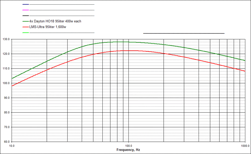

This guy sims well in multiples. Four of them in about 3.25cuft with 400w each model within a 1dB of my proposed dual RLp18 (4cuft and 2,200w per driver) system. Imho, that's pretty awesome! These would be great for someone who doesn't want to use a lot of super expensive amps and has room for the total system size which really isn't that large anyway. A single ep4k could make four of these keep up with one of my dual-opposed high power monsters.
At a glance, yeah, these seem kind of underwhelming but.... I like em. tongue.gif
Just don't look at them in singles. Multiples is the key with these guys. Are there more affordable choices? Of course. Total displacement isn't everything about a subwoofer system though, imo. It's just a really important part. biggrin.gif
EDIT: Here. I made a comparison of four of these new guys from Dayton and compared the four of them to a single LMS-Ultra as the price for four is roughly as much as a single LMS-U. Now...obviously the LMS-U is the superior driver and blah blah blah. I would not say that these are better drivers than it. However, if one can fit the space and just wants to use a single and simple ep4k... the choice looks obvious to me. tongue.gif
Scott Simonian is offline

Made another sim that includes the SI 18's in the exact same size enclosure (trying to keep it apples to apples) and same power and another with more power than it could be powered at with it's extra throw.
Oh ... just a simple fyi for you guys, a ~95liter box is equivalent to a 20" cube using 3/4" stock.
