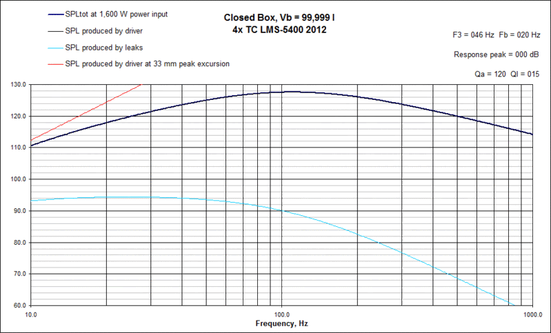

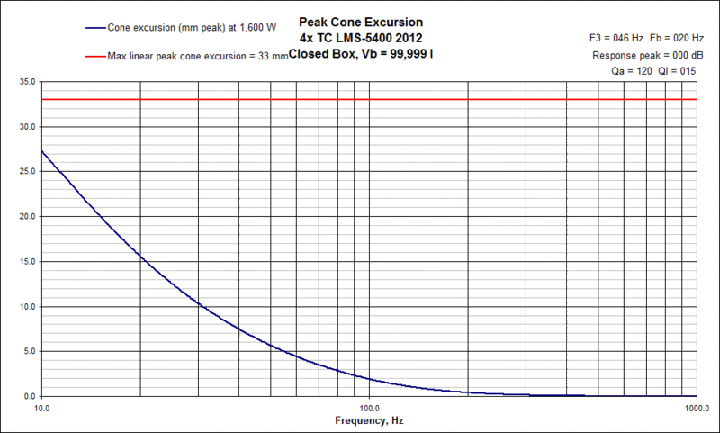

The LMS-Ultra isn't the most ideal driver for IB use but it can be used for such. I would highly recommend a rather small amplifier for the job or you'll be bottoming out like crazy.
400-600w per driver looks good.
You would stand to get a lot more output if used in small, high powered sealed enclosures.

the lms will model better but they cost 4x the price. about 2db difference @ 10hz

Scott, is that the result of 4 drivers combined?
Never mid Scott, I just re-read your graphs title. Sorry for the stupid question.

I really appreciate the help guys. But it is not a money problem. I already have 2 SubMersive's that I can't use use due to the amps as well as 3 Catalyst speakers, that I am waiting for Mark to give me a refund on(Taking a very long time to get any response from Mark as to how I can get this sorted). They are just sitting in my spare room room waiting for his(Mark's) response. Seeming as though I already have the 4 LMS drivers and I don't see anything that will prevent me from getting another 4 drivers, what will it take me realistically to get a flat response to 5 hz at 105 db?

Dave, just go ahead and do this. You can wire 4 drivers per side for a 4 ohm load to better utilize your clone. Notynt is flat at 120db down to 10Hz with his 8 sealed Ultras. Throwing 8 LMS-U's in an IB sounds like uncharted territory around these parts, but I can't envision anything negative coming about by giving it a shot.
Besides... We all know what these are capable of in sealed applications, so if you don't like your IB setup, just beef up your amplification and switch it around again.

Again. Very easy. Just put them in 3-4cuft sealed boxes, don't use a HPF or too much power. No more than 2,000w per driver is ideal.
Originally Posted by beastaudio View Post
While you are able to accomplish what you are aiming for, it is slightly unrealistic to persue. Even the guy with the most capable system on this DIY, Notnyt, with 8 LMS and his own power plant to run them high passes his system at 7hz. A) movies, even summed dont have response that is 0dbfs at 5hz, two with Not's system cranked, he said by 5 hz he couldnt even tell there was content anymore. wanna make it flat still? a rotary sub sounds like a good plan.
Yeah but Notnyt has an awesome looking system though he is overpowering the LMS-Ultras in too large of a net enclosure space. The Xmax is not controlled and continues to rise rapidly with lower frequency. He says he doesn't notice the deep bass ~5hz anyway and prefers being able to just go loud everywhere else ...which is fine. Using a rotary system is completely not needed to get loud output down to 5hz.
IB will not use up the excursion efficiently and will be severely excursion limited down low.
LMS-U drivers are not ideal for IB use. Make two or four sealed cabs, use 1-2kw per driver. Don't high pass. I don't see why that is so difficult to grasp. confused.gif
One does not use a Ferrari to do the job of a Bulldozer.

I disagree wholeheartedly. IB will use excursion extremely efficiently (that's kind of its' "thing" actually). Whether or not that's how you want the excursion to be utilized is something entirely different though. Fortunately that can and should be controlled via EQ (actually that's true for any setup). I fail to see what advantage a smaller enclosure would have over the IB other than acting as a high pass that may or may not be desirable.
Oh, and that's a really poor analogy smile.gif Although the LMS would be overkill it's certainly capable of doing the job of IB specific drivers, a Ferrari isn't really capable of doing the job of a Bulldozer though wink.gif
Actually, you just made my point. A Ferrari is nice and overkill but not suited for all jobs. You could pull a trailer with one. *shudders* But there are other vehicles suited for doing things like that and could do it better than the Ferrari. Ugh....audio/car analogies get awkward quickly. tongue.gif
And no, sorry. Read post #15 and #18. He wants extension to 5hz and useful output and doesn't want them to self destruct down low. That will be tougher when you will require a high pass filter just to not explode the drivers. Kind of defeats the purpose and a real waste of a bunch of LMS drivers.
I'm not saying he can't do it. There are just better options. This is DIY however. Do what you want. I'm out.
Meh, still disagree. Your analogy and subsequent explanation make it sound like the IB specific drivers would be better in an IB than the LMS which just isn't the case. The LMS might not be *much* better in an IB than the IB specific drivers but that's irrelevant as he already has the LMS drivers. Obviously in a conventional alignment the LMS would really have an advantage over an IB specific driver but I digress.
I'm confused. The fact that he wants extension to 5hz is an argument for IB over small sealed not against? Unless, as Bigus points out, he doesn't want it to be flat to 5hz which I doubt is the case. The only advantage a smaller enclosure would provide would be a built in acoustic high pass filter but that would need to be undone via EQ to achieve flat to 5hz. This doesn't provide any additional protection to the driver it only requires sending more power to the driver for the same output at any given frequency.
Although there may be more efficient options from a $/performance perspective I don't believe they'll actually out perform an equivalent number of LMS in the same IB.

I agree with Scott. I would never IB 5400's personally. Dave already crushed one by slamming it too hard as have a lot of others. An IB (free-air) only makes it that much easier to bottom them out or damage one. Efficiency and distortion aren't the problems with these drivers it is the danger of damaging one. Due to the strong motor on the 5400 it gains a lot less than other drivers by increases in box volume. They can work in IB but it would be my last choice of alignment for them since you will need to severely restrict the available power going to them or risk mechanical damage. Either that or high pass at which point why not just go vented in the 15Hz range? 5400's are the wrong tool for an IB. My two cents.
Interesting. Seems I've underestimated the potential for damage.
