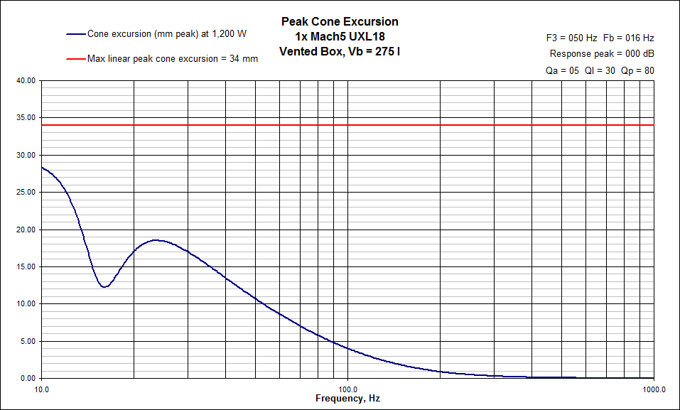

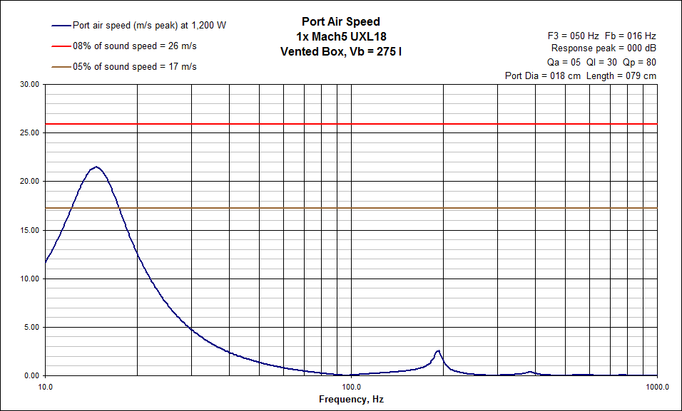

The port is 40in2 and calculates out to just under 80cm long which for an unchanged box gives a 16Hz tune.
With a second order HPF at 16Hz, I get this in Unibox.
Frequency Response
Excursion.
Port Air Speed
All looks good, with no reduction in enclosure volume.
A9X-308 is offline

Originally Posted by The_Nephilim1 View Post
So are you saying I can use the box I built without modifing it??/quote]Yes, that's why I modelled it this morning and posted the results.
NB: I used 275L not 285, but it will make stuff all difference.

Simply Xmax is the excursion you can use a driver to with good performance and no damage indefinitely. Xmech is the point where if you increase the excursion (and it doesn't matter what frequency it's at) you will damage the driver.
The tuning is the frequency that you've tuned the box/driver system to, in this case you've been talking about 18Hz IIRC.
With any ported enclosure, below the tuning frequency, if you apply power there, excursion rapidly increases. This is why you need a steep filter, to get rid of any content (music/movie sound) that exists below tuning. With an 18Hz tune, almost all pipe organ will be fine as there are few that use a stop below 16Hz. If you put on a movie with lots of extreme LF content and turn it up, you could damage the driver, which is why I asked.
Here is the excursion of the IXL18 in a 275L 18Hz tuned enclosure at rated power and no filtering. Note the rapid increase in excursion below tuning. This is the same in general for all ported boxes.
And this is identical with a 2nd order 17Hz HPF.
The horizontal red line is the IXLs rated 22mm excursion. IIRC Xmech is around 30mm, so imagine another horizontal one there and anything above that means damage.

I don't get what needs to be further explained. The post you quoted has all the info required already, so re-read it.
The difference between 275 and 285L will make stuff all difference.

Referring to post 30>
Graph 1 shows the expected excursion if you swept a sine 10-1000Hz.
Graph 2 shows the same with a 2nd order HPF in place. This reduces signal level below the knee point (17Hz in this case) so excursion is reduced. Even with this in place if you supply the driver with it's rated power below 15Hz it will exceed Xmax, but probably not Xmech. This is considerably better result than without the filter. If you want to absolutely gaurantee that the driver will never exceed Xmax with rated power applied, use a 3rd or 4th order. I wouldn't bother personally, but it's your call.
A9X-308 is offline

Hi Thnx for that just 1 more note. In the graph it shows at 10hz it has surpassed XMax but just near xmech.. I thought that if the 10HZ tone had exceeded the XMax that would have damaged the driver..If I am correct it will not if I aplly a 3rd or 4th order bandpass which is what I want to do..
Any cons to applying a 3rd or 4th order bandpass..I would also like to know in the iNuke software are the bandpass called Slopes ?? I have 5 slopes to choose from, 6db,,12db,,18,,24db,48 is that 1st,2nd order bandpasses??
No. Xmax is where the performance of the driver has degraded to some degree (Bl<0.707, THD>10% etc) but exceeding Xmech is when it will sustain actual damage.
You don't want to use the bandpass filter function; you need to make one out of the HPF and LPF sections to get the desired slopes and correct passband.
You are correct that 1st order = 6dB/oct, 2nd = 12 etc. This is often shorthanded into filter descriptions such as LR4 being a 4th order Linkwitz Riley though LR24 is sometimes used for the same.
I don't have an inuke, so can offer no advice on how to implement filters with one. Ask someone who has one.
