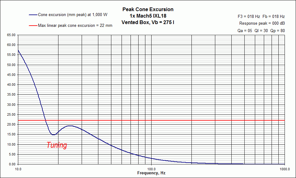

Two IXL18, EP2500, MiniDSP, wood and glue should be close to $1k. Two enclosures not one if possible.

OK I decided on the IXL 18.2.2 altho have to get it from Aus. but I already bough and cut the MDF..
So now on to the next part what size Wire do I need to wire the sub driver to the terminal Cup..
I also need to know How far to spread the screws on the MDF Box to hold it together I am using Glue and screws..
So what else do I need? I know I need the amp EP2500 but would that be too many watts?? What is this mini dsp is it an absolutey needed?? how about a Equalizer will I need one of those??

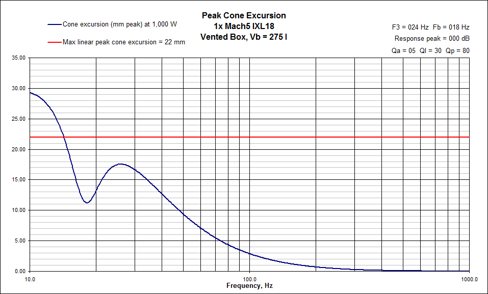

if you use a really strong glue, such as pl premium, the screws are pretty much just there to hold the wood together until the glue dries. once dry, the joint will more or less be strong than the wood itself.
in 4 cubic feet, 2000 watts is too much, as it sends the driver way past xmax, 1000 would be better.
mini dsp is a digital signal processor...essentially an advanced equalizer. if you need some eq to bring up the bottom end of the sealed system, it is a good choice.

285 liters is about 10 cubic feet. that is a great design for that driver btw. 1000 watts takes it up to xmax.
i'd stick with the pro audio amp, but you need some sort of high pass filter so that your driver doesn't crash below tuning.
the inuke dsp line is one option for integrated dsp. the mini dsp is probably the best bang for the buck as a stand alone unit.

First of all, where do you live?
When you mentioned getting the IXL18 from Oz, I presumed you were down here, Nuw Zulund or SE Asia.
If you are in the US there will be other options that might work out cheaper.
Originally Posted by The_Nephilim1 View Post
OK This I do not understan all the Tunings and xmech and such.. Well I understand a little but not too familair with all the teminology..
Simply Xmax is the excursion you can use a driver to with good performance and no damage indefinitely. Xmech is the point where if you increase the excursion (and it doesn't matter what frequency it's at) you will damage the driver.
The tuning is the frequency that you've tuned the box/driver system to, in this case you've been talking about 18Hz IIRC.
So If I use the Dayton 1000w amp this is NO good?? I intend on putting those Action flicks that I have been seeing go down to 5hz but mostly too 10hz.. I do have the Saturn 5 CD that goes to 0 Hz I would love to get that as low and loud as I can but it is a killer.. I also have those music clips from the Truth Hz thread I intend on playing..
I also Listen to Pipe Organ music with some content to 16hz but the louder and deeper I can get the better with Organ music.
With any ported enclosure, below the tuning frequency, if you apply power there, excursion rapidly increases. This is why you need a steep filter, to get rid of any content (music/movie sound) that exists below tuning. With an 18Hz tune, almost all pipe organ will be fine as there are few that use a stop below 16Hz. If you put on a movie with lots of extreme LF content and turn it up, you could damage the driver, which is why I asked.
Here is the excursion of the IXL18 in a 275L 18Hz tuned enclosure at rated power and no filtering. Note the rapid increase in excursion below tuning. This is the same in general for all ported boxes.
And this is identical with a 2nd order 17Hz HPF.
The horizontal red line is the IXLs rated 22mm excursion. IIRC Xmech is around 30mm, so imagine another horizontal one there and anything above that means damage.
