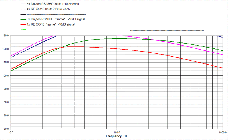

Here ya go. Had to include sims of the two at -10dB down because with both systems they go off the chart from ~30hz and up. tongue.gif
Both are very capable and will more than likely satisfy even the most die hard bass fan. Both should sound incredible. They are different though. It would cost less than $2,000 for eight Dayton drivers and for most people four XXX18's would run ~$3,000. The XXX18's are the superior driver down low with some mechanical headroom left on the table. The Daytons, not so much but these are modelled within reason and should sound very good.
Ok, all things considered with the exception of space, the headroom up top you would get from these HO's is unreal. The area where the RE starts to head back down is a problem for me as it really sucks up some amp power at that point. Wanna talk about real power concerns...I already have them with just a pair on a single FP, and that is also crossed at 60hz. The 40-60hz by itself really sucks the juice away. when running at 40hz and down, there is no problem at all smile.gif
beastaudio is offline

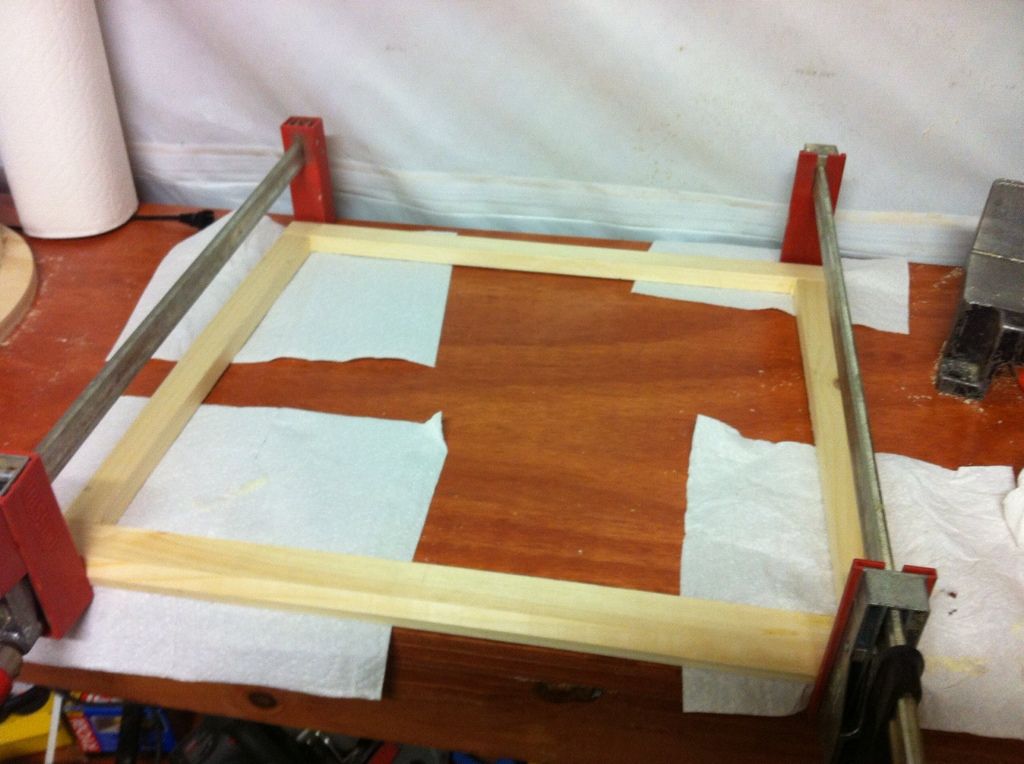

Thanks for the complements, much appreciated. Here are my building costs - some money could be saved like primer, magnets, grills, etc if you did not want that stuff.
4 X Dayton 18 HO drivers - 933
4 sheets 4x8 ply, cabinet grade - 123
2 x binding post plates - 13
black screws for binding posts - 5
#10 x 1.5" spax screws for Drivers - 10
1 gallon primer - enough for probably 8 boxes - 18
3 tubes of PL premium sealant/glue - 15
1 gallon duratex - not used yet but enough for many boxes including a roller, 2 extra pads, and shipping - 72.00
Magnets for grills 40
14 pounds of polyfill from Walmart, not used yet - 42
1 X Crown XLS5000 (when it was on special with coupon) $533
1 x Minidsp with shipping $165
Wood for grill frames - approximately 10.00 for 1x4's ripped down
Cloth for speaker grill fabric - 15
Sandpaper = already had like 50 sheets of 120 / 150 / 320 grits, but if you need to buy this add maybe 5.00.
Wire - already had a spool of monoprice 12 gauge, but if you needed to buy I used about 12 feet overall. 5.00 maybe?
Subtract out the amp and EQ = 1296 including my fancy coatings and grill materials.
I think that's it.

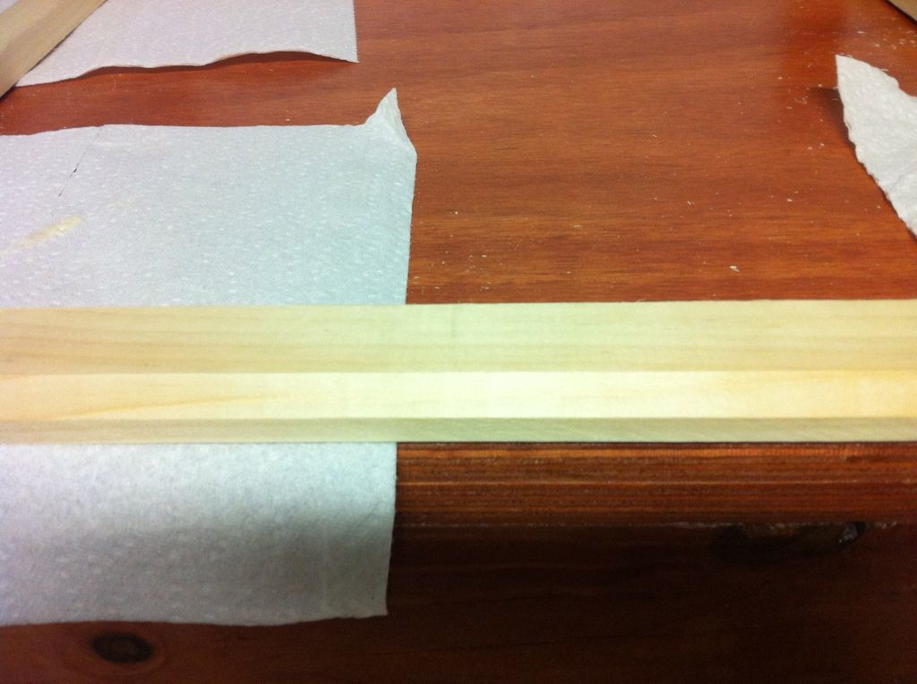

Started working on the grills this afternoon. I made them a little smaller than the box itself at 24" H x 22" W. To save money I bought 1x4's and ripped them in half with my table saw. I hit the edges with a 45 degree bit on my router and did a quick sand on the edges. Voila!
Gorilla83 is online now

Looking nice. Off topic a little bit, but is there a reason you chose not to 45 degree them on your table saw? Only reason I ask is I'm building some fabric frames for my theater and am wondering if I should 45 them on the saw or use my router.

Cutting a 5/8" 45 is far easier to get right with the router table. Not to mention pushing a 1.5" board through the table saw is a bit shady. cool.gif

General note - I did a 'mockup' of the grills on the boxes and they look kind of odd to me. I'm not sure how I feel about keeping the grills, I'm still up in the air as of now. I did drill the pilot holes for the magnets, but not sure if I will wind up using them. Chances are they will look a little bit better once painted black and covered with cloth though. Hmm.
