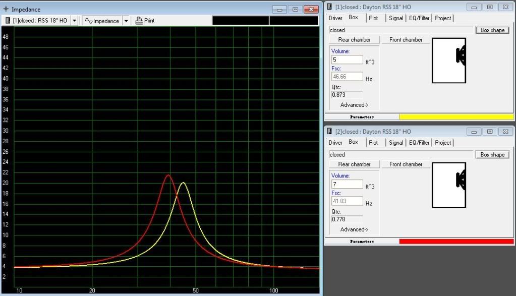

Josh - have you played with the Dayton 15" Titanic driver at all? I was playing around with modeling these subs, each in a 3cu foot box with max rated power and the difference between this driver and the HO 18" is not all that significant. Of course I did use the 13mm xmax figure for the 18 when modeling. Now, if the 18" xmax can move to 20mm or so, then more power and/or a bigger box can be applied which tips the tables quite a bit.
dayton ho 18 vs dayton titanic 15.JPG 103k .JPG file

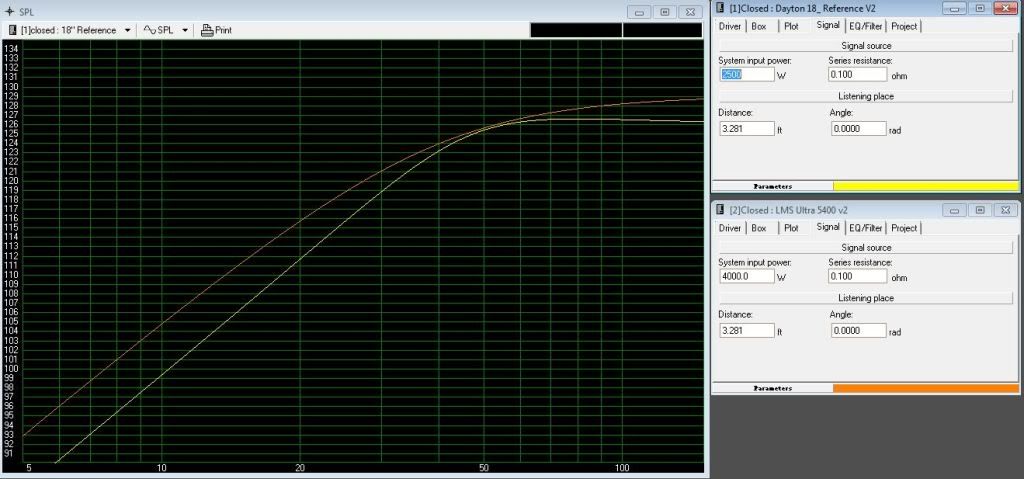

Another interesting comparison:
4 X Dayton Reference 18's and 3600 watts in a 9 cu ft enclosure (yellow). $1000 of drivers shipped.
Vs.
2 X LMS Ultra 5400s in a 8 cu ft enclosure and 4000 watts (orange) $1900 of drivers, shipped.
Both within rated Xmax to 10hz, both go over by a few mm under 10hz. LMS pair has a couple db below 20hz, then Daytons take over >20hz.
2 X Daytons in 5 cu feet with 2500 watts vs 2 X LMS5400 and 4000 watts in 7 cu feet
Clear advantage to LMS sub 30hz, but very close 40hz and up! $500 vs. 1900. biggrin.gif
Gorilla83 is offline

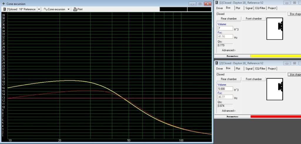

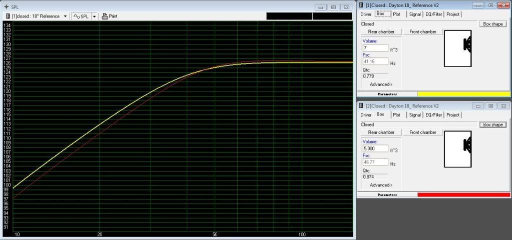

Originally Posted by Ricci View Post
IMHO you should look for danger in excursion levels between 10-25Hz and not worry as much down at 3-6Hz. Once you combine the receiver electrical roll off with that of the amplifier and any other electronics in the chain you are very likely to have a signal be 3 to 6dB down at 5Hz compared to 20hz and then there is the fact that the sounds down below 10Hz are almost never as strong as the sounds above. A 6db reduction in signal results in half of the excursion from the driver. Try applying an 8Hz 1st order high pass filter to your models (to approximate the electronics roll off) and look at where the maximum excursion ends up in most instances.
Very helpful, thank you again. So in comparing a 5cu foot box vs. 7cu ft, here's what I'm seeing with a 8HZ 1st order HPF applied:
SPL differences, both being driven by 2500 watts/pair:
Excursion:
The 5cu foot box seems quite a bit more conservative, but gives up a couple DB on the low end. Please do let me know if I'm overlooking anything.
Since you are looking to understand/compare the differences of the 2 box sizes, you could also post an impedance curve of each sub which shows Fb clearly.
IMO, 7 cu.ft. is plenty small and appropriate for 2500W maximum power into a pair of 18s. You are probably pretty safe assuming your crown won't deliver much more equivalent Voltage than this into the drivers when driven hard, which should leave you well limited by the amp clipping, especially with wider spectrum program material vs. test sine waves down low.

post #85 of 1016 Old 11-01-2012, 05:52 AM - Thread Starter
Gorilla83's Avatar
Join Date: Aug 2011
Location: Delaware County, PA
Posts: 3,759
Mentioned: 105 Post(s)
Quoted: 372 Post(s)
Liked: 513
Mark - Here is the impedance curve for 5cubes vs. 7. I'm not super clear on how to interpret this other than face value so feel free to teach a man to fish. tongue.gif
post #86 of 1016 Old 11-01-2012, 06:11 AM
Stereodude's Avatar
Join Date: Jan 2002
Location: Detroit Metro Area
Posts: 13,824
Mentioned: 25 Post(s)
Quoted: 3093 Post(s)
Liked: 2239
Fb is the frequency where the impedance peak is. You can pretty clearly see the 7cu-ft box is tuned about 6Hz lower than the 5cu-ft box.
Stereodude is offline
post #87 of 1016 Old 11-01-2012, 06:25 AM - Thread Starter
Gorilla83's Avatar
Join Date: Aug 2011
Posts: 3,759
Quoted: 372 Post(s)
Liked: 513
Thank you sir. This is interesting because in the SPL chart they both start to roll off around 50hz.
post #88 of 1016 Old 11-01-2012, 10:40 PM
Ricci's Avatar
Location: Louisville KY
Posts: 5,311
Mentioned: 76 Post(s)
Quoted: 185 Post(s)
Liked: 473
Ok all of this questioning about what the RS18 is capable of and its xmax rating led me to doing some investigation tonight. Turns out it will take 36v at any freq in free air without hitting the stops. The min impedance is right around 4 ohms so that is 324 watts. When placed in my 4.2 cube sealed enclosure it will accept 75 volts at least without running out of stroke. Thats around 1400w into 4ohms. In a small sealed enclosure you could use 1000-1500w into 4 ohm rated amp channel without worrying about clanking the driver. This drivers excursion is useful to atleast 20mm and has less mechanical noise than many.
Ricci is offline
