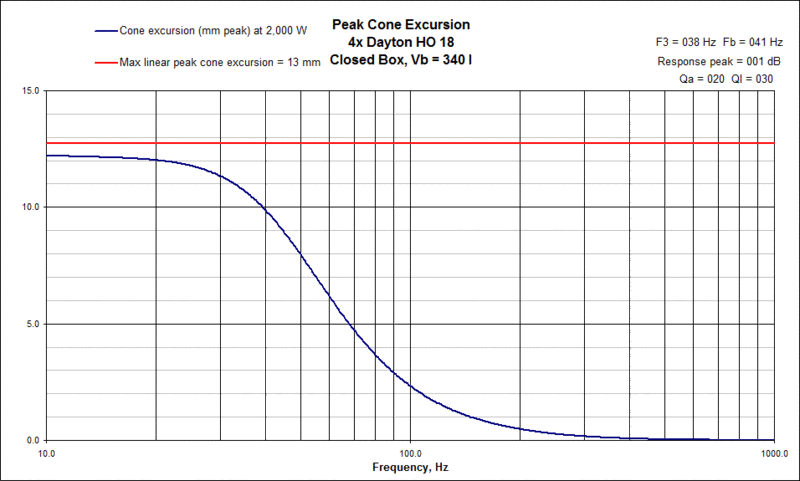

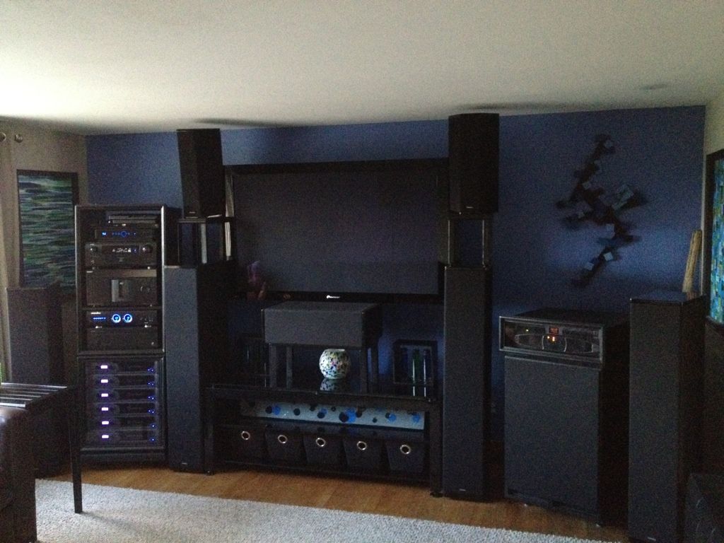

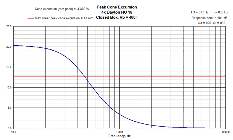

Well this pic kinda sums it up: I'm not really using the stand for components anymore, so why not a 6 foot long 14 cubic foot bass-coffin?!
Hey, speaking of: I could easily wire (2) pairs in parallel and then the pairs in series for a (2) ohm total, correct?
Anyone want to run a 2kilowatt model of (4) of these in a 14^3 cab???! biggrin.gif

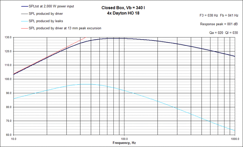

post #102 of 1016 Old 11-02-2012, 11:04 AM
Bass Enabler
Scott Simonian's Avatar
Location: Clovis, CA
Posts: 21,321
Mentioned: 176 Post(s)
Quoted: 5840 Post(s)
Liked: 4838
Scott Simonian is online now
post #103 of 1016 Old 11-02-2012, 11:11 AM
mastermaybe's Avatar
Posts: 7,628
Quoted: 409 Post(s)
Liked: 328
Thanks SS.
Just gorgeous...and that's @ 12^3.
Below excursion with 2,000 watts and 105db 10hz output, before vessel gain.
$1000.
I'd bet tempted to go 14^3 ...should be right around/just above xmax with 2k, heh?
I don't mean to hijack your thread, Gorilla. Hopefully this will do us BOTH good, lol.

This is my pre-Ricci tested high powered sealed recommendation for you guys. From my models and anecodotal evidence from Josh, I would not exceed 3.5cuft or so with more than 1,000w. 3-3.5cuft is the sweet spot for +1,000w applications. That is, unless you want to throw away bandwidth with high pass filters. Pfft... No thanks. Might as well built a vented system.
But anyway...
Scott's sim of quad HO18's with one channel of a 14k LG clone.
One could go even smaller for more excursion control/protection but this should be safe and give you the most lowend output for your dollar. One would simply take a 1dB hit down low and bring the excursion down to a max of 18mm one way in a 3cuft box. Definitely the safest bet. Imho, if you can spare the space, this might be the better build over something like the UXL or LMS 18's. Those are fantastic if you NEED a small a very capable sub system. Or even if you don't. wink.gif
