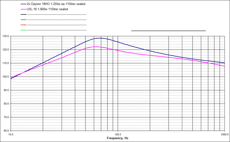

Dual Dayton 18's in a 5cu ft box with 1800 watts (yellow) vs. single UXL-18 in 3.5 cu ft box and 1200 watts. Holy crap - am I doing this correctly? Dual Daytons FTW! dual dayton 18 vs single uxl.JPG 104k .JPG file

Thanks Scott, you're the man. I did some modeling of my own as well - it seems like a 5 cubic foot dual opposed box seems to model the best. This puts me at about a 23" cube considering displacement for both drivers and bracing.The difference between 2 x Daytons vs. 1 UXL is NOT insignificant. It's looking like +1db at 10hz, +2db at 20hz, +4db and 30hz, and +6db at 40hz+. Assuming I can put 1250 watts to each driver, the pair (opposed) should be a STOUT performer, especially considering I can likely build each enclosure for under 650 including duratex finishing - possibly slightly more if I got with a higher end finish and/or a fancy grill.
Considering the box size will only be marginally bigger than the single UXL box, is there really any reason I wouldn't go with the dayton 18's over the UXL-18?
Pros for Daytons:
Cheaper to replace
Readily available from parts express - good warranty coverage and customer service
Twice the drivers means I can spread out the heat vs. a single driver
Cons
More space required vs. UXL (marginal and not really an issue in my case)
Gorilla83 is offline

I agree. I prefered the 5cuft box too but I was just keeping the model in line with what Ricci had mentioned. Both work.
Yeah, man. Go for it! The drivers are out and exist and can be yours in days. You also have the amp already, right? Bam! Go get some lumber and start choppin'. biggrin.gif

the dual daytons are a great idea. each one has a 3" coil, so that is kind of like having a single 6" coil as far as cooling goes.
and, as a pair, they have quite a sensitivity advantage over a single uxl, so for a given spl, much less power will going through the coils.
the daytons with their triple shorting rings may provide the better sound quality. i don't recall reading about any complaints of the sound quality of either the dayton -hf's or the -ho's.
5 cubic feet is pushing q=0.9. no problem there? seems just a little small.
It doesn't quite work like that. The surface area of a two 3" coils is not equal to a 6" coil anymore than two 18" subs = a 36" sub.
you are confusing area of a voice coil which is a linear function with area of a cone which is a non-linear function.
if you disagree, please provide your calculations. here are mine.
the surface area of a coil is its height multiplied by its circumference (x2 if you want both sides, but for now we can use just one).
circumference is diameter * pi.
the height will be held constant.
3" * 3.14 = 9.42" circumference for a 3" diameter coil.
two of those give 2 * 9.42" circumference, which is 18.84".
18.84" of circumference divided by 3.14 = 6" diameter.
so, two three-inch diameter voice coils has the same area as one six-inch diamter voice coil.
Listen. It's All Good.
