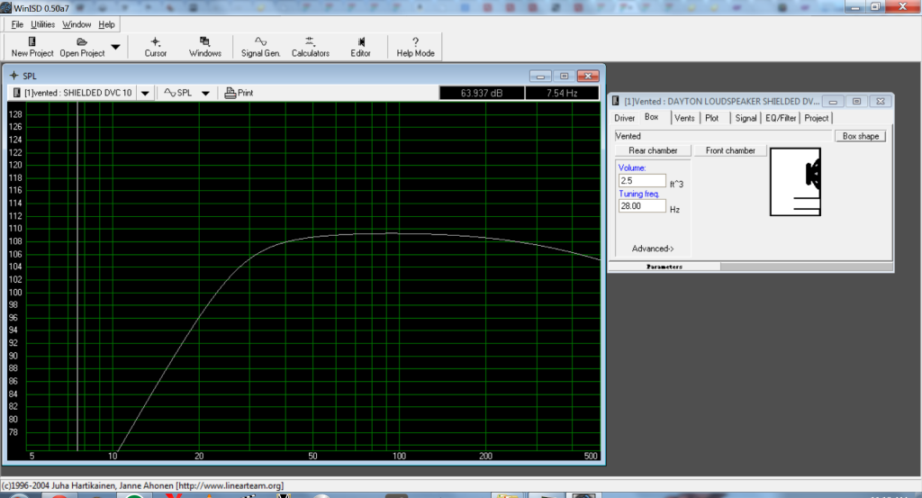

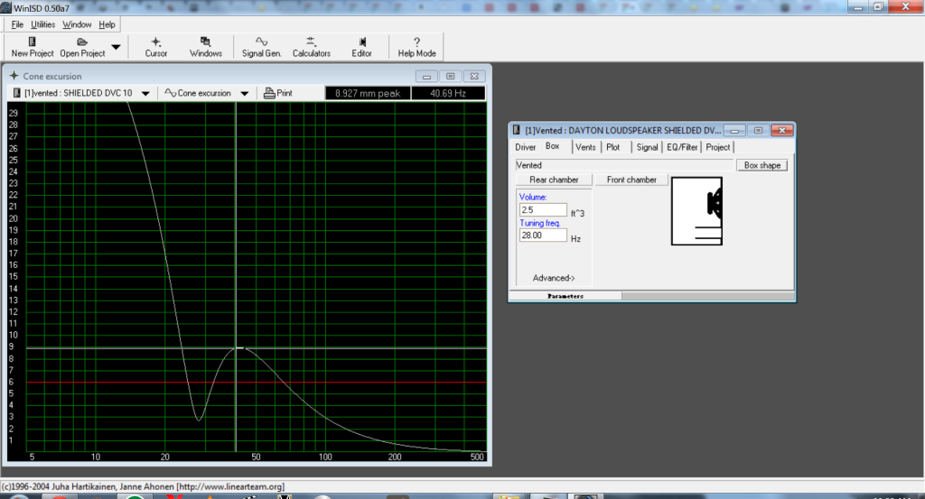

Alright, I could only find 12"D sonotube unfortunately, so I have to go with the 10" version of this driver:
http://www.parts-express.com/pe/showdetl.cfm?partnumber=295-486
It looks like I can get a 2.5ft^3 enclosure with a 4" diameter, 14" long port, tuned to 28hz. Around the tuning I'm getting 50ft per second for port velocity, so just barely acceptable. I get a flatter response if I up the volume, but excursion really becomes a problem. I'm not used to modeling such a low cost driver... even with the 2.5ft^3 enclosure I'm seeing 9mm excursion at 40hz, which is quite a bit over it's 6mm xmax. I'm not sure what the xmech is, so I hope this isn't a problem. Here's some screens from winisd, this is with 100 watts:
doodoobutter is offline
post #11 of 12 Old 11-20-2012, 09:49 AM
nograveconcern's Avatar
Join Date: Aug 2012
Location: Atlanta GA
Posts: 822
Quoted: 91 Post(s)
Liked: 128
Well, that is to be expected with a low excursion driver like that. I don't think you will hit xmech with program material and only 100w though.
