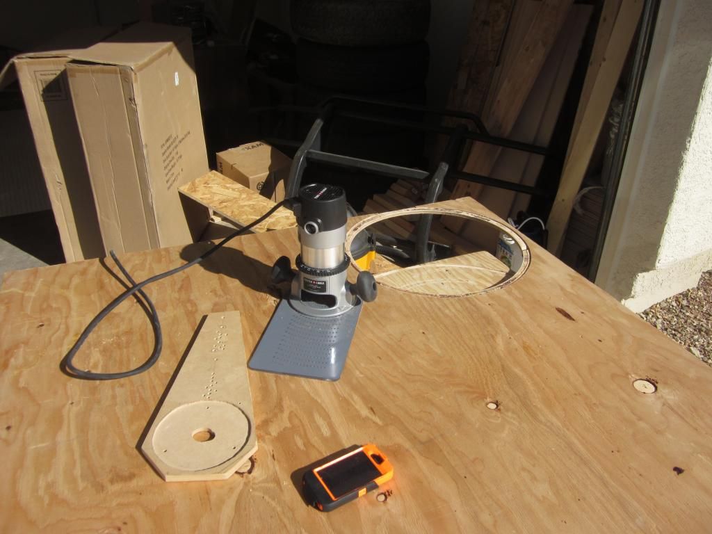

I've done some various little DIY projects, but this will be my first audio subwoofer enclosure build. After doing some research on here the Dayton 18" HO sub was my choice, which will be driven by a Dayton 1000 watt plate amp. The box will be 3.85 cubic feet without driver displacement and bracing.
Day 1:

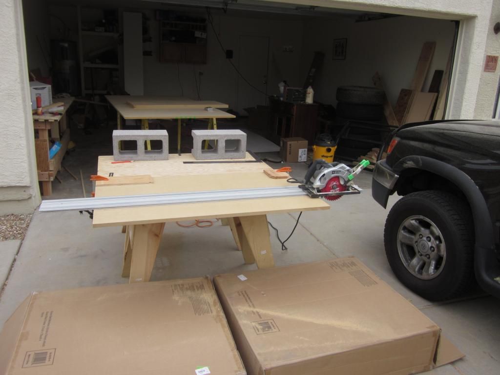

It's not Festool, but I know what you're taking about. It's an Eurekazone high quality aluminum track. I regret buying it though, it's a quality tool ( not cheap) but I should've spent a few hundred more and got a decent table saw. I actually do have a table saw that I picked up on Craigslist (70s era craftsman, made in USA) but I can't use it as the new house has no outlets outside/in garage that can handle the initial power surge.

It's not a Festool, but those are nice! It's a quality aluminum track from Eurekazone. Good tool, but its not cheap, that money should've went towards a decent table saw. I do have a table saw, actually (70s era, made in USA Craftsman that I picked up on CL). It is out of commission, however, as none of the usable outlets in/near the garage can handle the initial power surge from the motor.

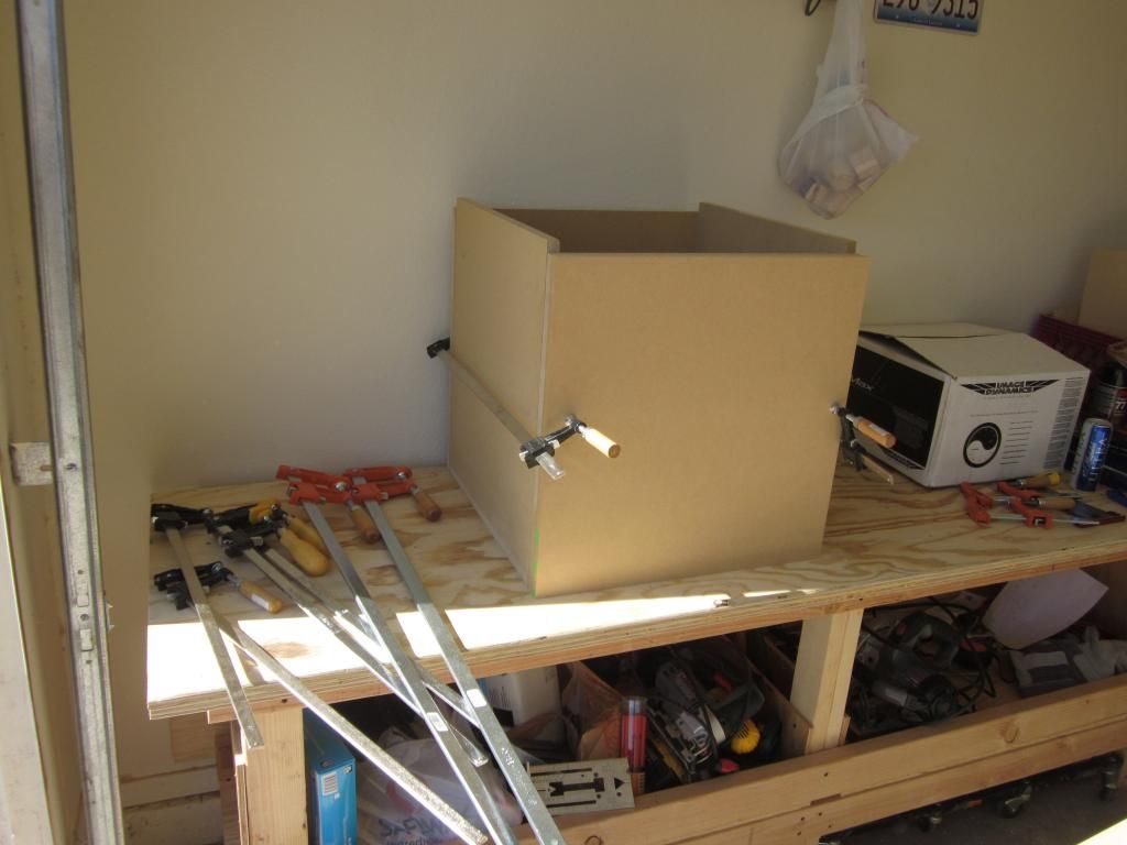

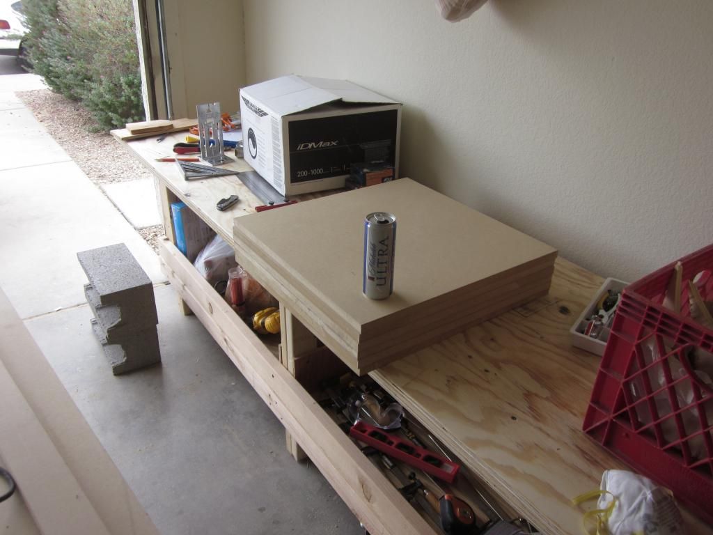

Day 2:
Grrrrrr. Bad and good news. I was so eager to get this started that I made an error on my cut list (if I can even call it that). Not all sides are symmetrical, gah, I'm an idiot! I'm giving up for today (I work 3rd shift and it's really late for me). Upon dry assembly it obviously didn't "line up". This build will be delayed.. I need to truncate some panels and cut a new bigger one(s) out. And to think I enjoyed geometry in high school...
If anyone can help me out in salvaging this I will be very grateful. I have 3 21"x21" and 4 21"x19" panels. I realize that the proper assembly will also change the box volume, but not to the extent where it will be unusable.
The good news is that's got my receiver today. However, the vendor sent me the Denon 2113CI model instead of the last year's 2112CI, which I ordered. That works for me!
Poorly-planned cutlist:
Dry assembly.
Fade to Black is offline

"If anyone can help me out in salvaging this I will be very grateful. I have 3 21"x21" and 4 21"x19" panels. I realize that the proper assembly will also change the box volume, but not to the extent where it will be unusable."
does something like this help at all?
measurements are the dimensions of the panels.
assuming exactly 3/4" material.
if the material is not 3/4", than the top and bottom would be (21" - 2*panel thickness) x 19"

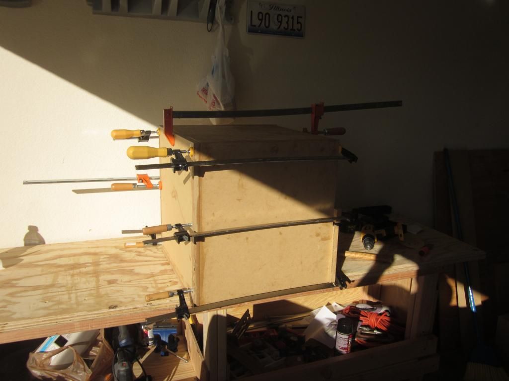

Day 3:
Got my Parts-Express goodies. Nice looking sub with an aluminum cone. They're always nice looking when they're ours, aren't they? smile.gif
I initially assembled and clamped more than what's pictured. I quickly realized that I was running out of clamps quick (can never have enough of those... trained my yard-sale hunting wifey to buy clamps whenever she spots them, and she does smile.gif ) I dis-assembled what I put together and decided to do it right, I knew I would regret it if I rushed through it. Gonna take longer, but I think it will be worth the extra wait.
Even after heeding Gorilla83's warning about PL I still managed to get this stuff ALL OVER EVERYTHING. I started out using a putty knife, but quickly switched over to using my finger to spread the substance. Luckily the nitrile gloves I had partially mitigated the mess. It wasn't fun... heh, I much prefer wood glue... But experience is golden, I will be more efficient in future build(s) biggrin.gif Also spot LTD02's cutout list, which saved my skin (literally had to make only 2 cuts from what I already had from yesterday's mistake. You've been invaluable, thanks buddy.

Day 4:
Glued another panel; with two remaining. Looking more like a box now. Cure times slow us down!
Laminated two panels together for the double baffle.
I already had a jig I made a while back, however, for this project its accuracy wasn't gonna cut it. I tested out the Jasper jig I purchased from PE, and made some cuts with it; they turned out to be pretty accurate. The tool is a good investment. Test-fitted the sub in that hole and it dropped right in.
