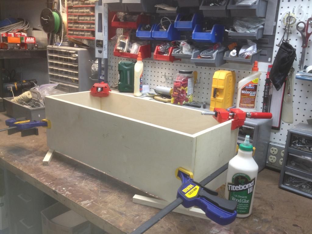

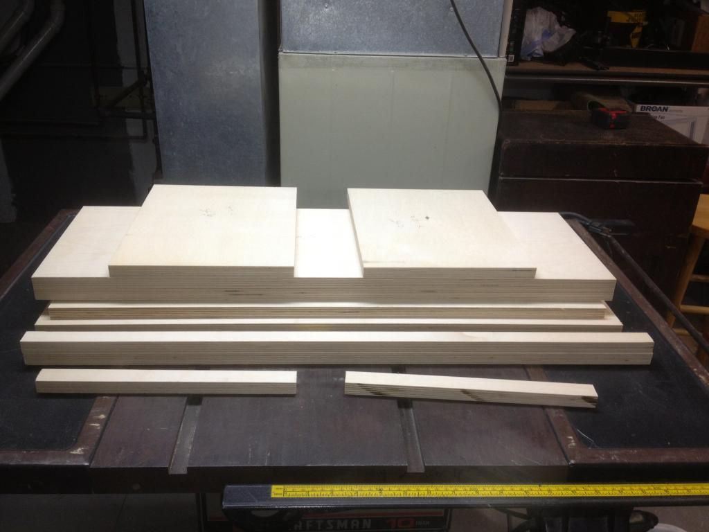

post #7 of 238 Old 11-27-2012, 07:28 AM - Thread Starter
cuzed2's Avatar
Location: Chicago Area
Posts: 4,937
Mentioned: 19 Post(s)
Quoted: 200 Post(s)
Liked: 256
Reduced a sheet of Baltic Birch to this:
And started gluing it up. The red clamps were just purchased, "Bessey" corner clamps (they work well)
