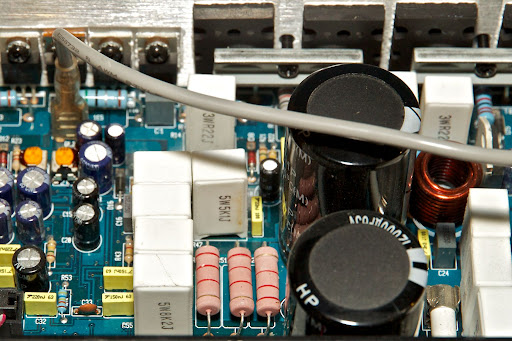

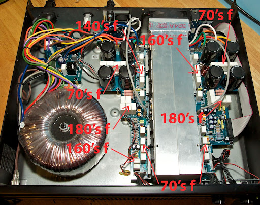

10-12 minutes later, look at these temps, taken with handy IR thermometer, and felt with my fingers.
What are those white ceramic (I think) things that are getting so hot so fast, w/o any signal?? either they are at/near room temp 70's, or cooking HOT.
Any idea/suggestions to trouble shoot this??
All the other components feel just "normal".

Picts of white ceramic components
70 deg f components
180 deg f components
140 deg f components
[update 5pm]
2 full hours later its stabilized, exhaust is cool, those specific components are HOT, but the alum heat sink is just warm, 90's, and only in certain areas.
I'm putting the EP2500 back into the HT.
Would recommend only the low db fan, and keep stock airflow direction.
