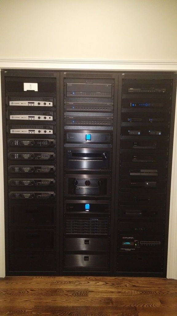

Originally Posted by nix4me View Post
Thats alot of power for sure. Can't imagine needing that much in a home situation.
How else will you drive sixteen 18"s?
Sixteen HST-18's Build
And Auburnu008's recent thread is just one of legions of bass-loco's around here. From dedicated drops from transformers, to dual G-horns in the attic...nothing surprises me here anymore. In awe, jealous, impressed, blown away by some - but not surprised.
Auburn's is a dual purpose theater. When he's not using it to watch movies, Chevron uses it for Hydraulic Fracking.
