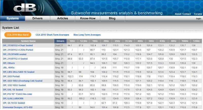

Originally Posted by deathinc View Post
Just orderd two SI 18 D4s. Now I just need the cabinets. How much performance would 2 of the D4s give me vs the 2 15s?
Look at this site, has exact answer to your question, hopefully you can read and grasp the data table
http://www.data-bass.com/data?page=systems&col=drivers&type=0&sort=desc&mfr=-1
I don't see the 15" dayton HFs,Sorry I'm not very good at this......
