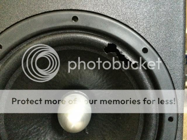

Thank you very much Mfusick! I was planning on getting them back outside this spring to complete the finish on the lacewood and take more measurements so that I could fine tune the MiniDSP XO but with a super busy work schedule and too many other home projects this year I guess I'll have to shoot for next year. Oh and my new 5 month old puppy decided that one of the TD10's would make a good chew toy.

Oh man, I thought it was bad when my 2 year old peed on MY shiny new aluminum cone AV15H woofer! Now That sucks..

Ouch !
Lol @ puppies. My puppy golden was quite a handful. She's a lot better now, hang in there it gets better. Lol

Did you get your speakers repaired Btw?
I still need to get it fixed yet. I have waiting on my puppy to grow up a bit before I fix it and have her chew on it again. Thankfully she hasn't found the rest of the woofers to be as tasty as that one. On a bright note she will be 1 year old in a week. Below is a picture of the trouble maker playing in the mud.
Acoustic Elegance is only 10 minutes from where I work so I can run it over there any time. I just need to give them a call.
dwaleke likes this.
