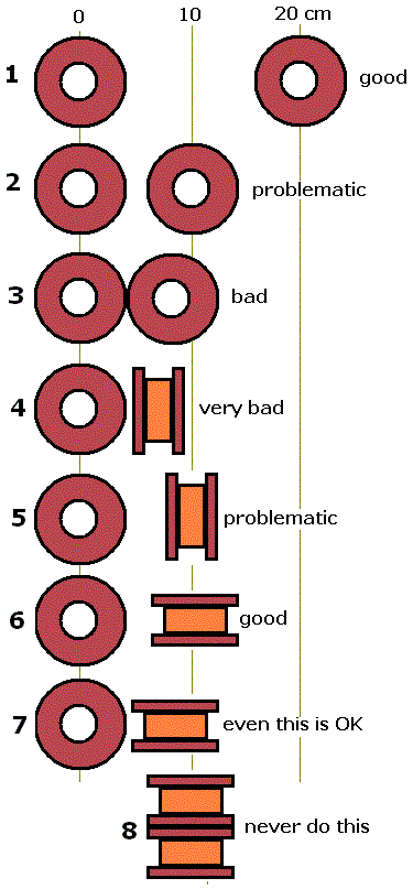

I had an OCD meltdown. Here's my first stab at the XO. Do not cross the streams!!!!!! biggrin.giftongue.gifwink.gif

Liked: 371
The xover on the left, one inductor should be standing up.
Standing one up would be a good idea, if he puts them closer than shown. Right now, they look like they are more than 20CM center to center.

They are ~90mm apart or 3.5inches.
20cm is 8 inches, which is nearly the length of the whole board.
BassThatHz is offline

So with my OCD in nasty-inductor-hyperdrive.
No crossing magnetic fields or streams!!!!
