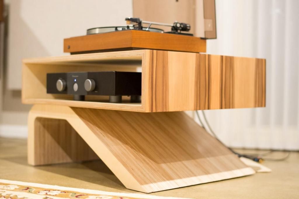

I have used both Makita and Festool, but own a TS75. It has WAY more power and a cleaner cut on serious hardwoods. It also produced better cuts on ply, but this is only material if you're say building furniture with it. For general construction work the Makita is more than adequate.
I cut the mitres for this table with the Festool.....I'd be impressed if I could achieve the same with the Makita. But as I said, if its just breaking down sheets etc, the Makita is excellent.

Originally Posted by audiovideoholic View Post
Nice table and good explanation in general. You finishing that table or just gonna put some oil on it?
That is the finished version (a sort of dull shellac finish). Here is another shot of it.....sadly I had to sell it as its not at all "baby" friendly. My wife and I were worried about out daughter smacking her head on the sharp edges.

post #90 of 420 Old 09-26-2014, 01:51 PM
audiovideoholic's Avatar
Location: Murray KY
Posts: 3,644
Quoted: 653 Post(s)
Liked: 215
That turned out really nice! Mind telling what you got out of it? Really modern yet not overly finished which worked well.
Did you see something similar or design it yourself?
