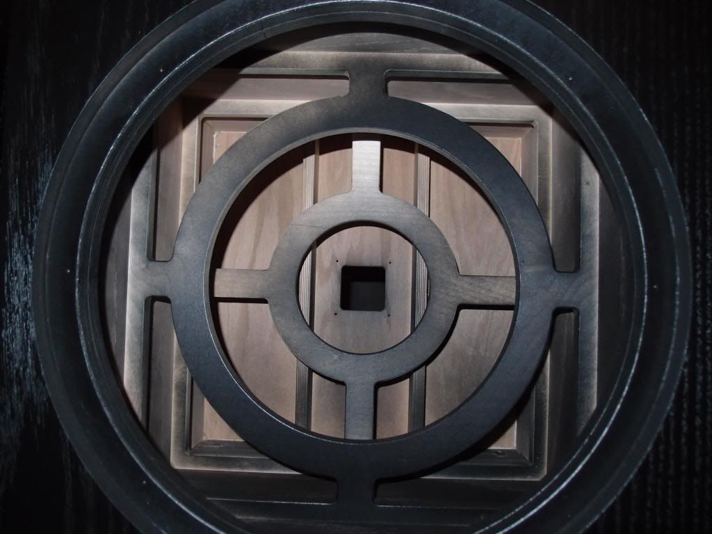

dlbeck was in town and popped into the office while I was testing it and grabbed a pic that ended up in the JTR thread a few days before I had things set to post on my forum. The same and more info is now in a new thread here on my forum.

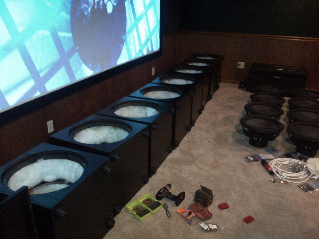

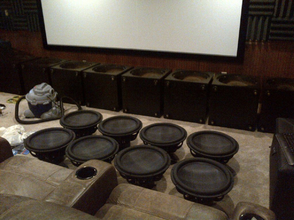

I've been meaning to put some assembly pictures in this thread for some time.
Parts all laid out (some opened and grouped already) - - - - (silly expensive for all these little things---- > $450 for these components completing the boxes -- things I didn't initially think about and they add up!)
25lbs of poly fill from wal-mart
Black aluminum back plates with gold plated terminals from parts express (~$30 each box!)
Rubber feet from parts express (PENN-ELCOM 9106 RUBBER CABINET FOOT)
stainless washers, stainless machine bolts, premium t-nuts, black machine bolts, 12 gauge speaker wire, etc...
Boxes which cost me about $300 each including gas for pickup, or $250 each outright. (I consider this a VERY good price because these boxes are excellent in every way! -- the original guy that sold these said the cabinet shop that made them had a minimum order of 16 and he was charged $460 each. He was going to open a speaker/subwoofer line, but then opted against it and sold all his gear he had purchased at a loss. I purchased the second set of four from another forum member who had also purchased them from the same guy originally. So I ended up with eight. I'll buy more if I come across more of the same). There are pictures of the boxes throughout this thread - but they are excellent. Here is a link to some pictures:
http://s1191.photobucket.com/user/jv...d%20Enclosures

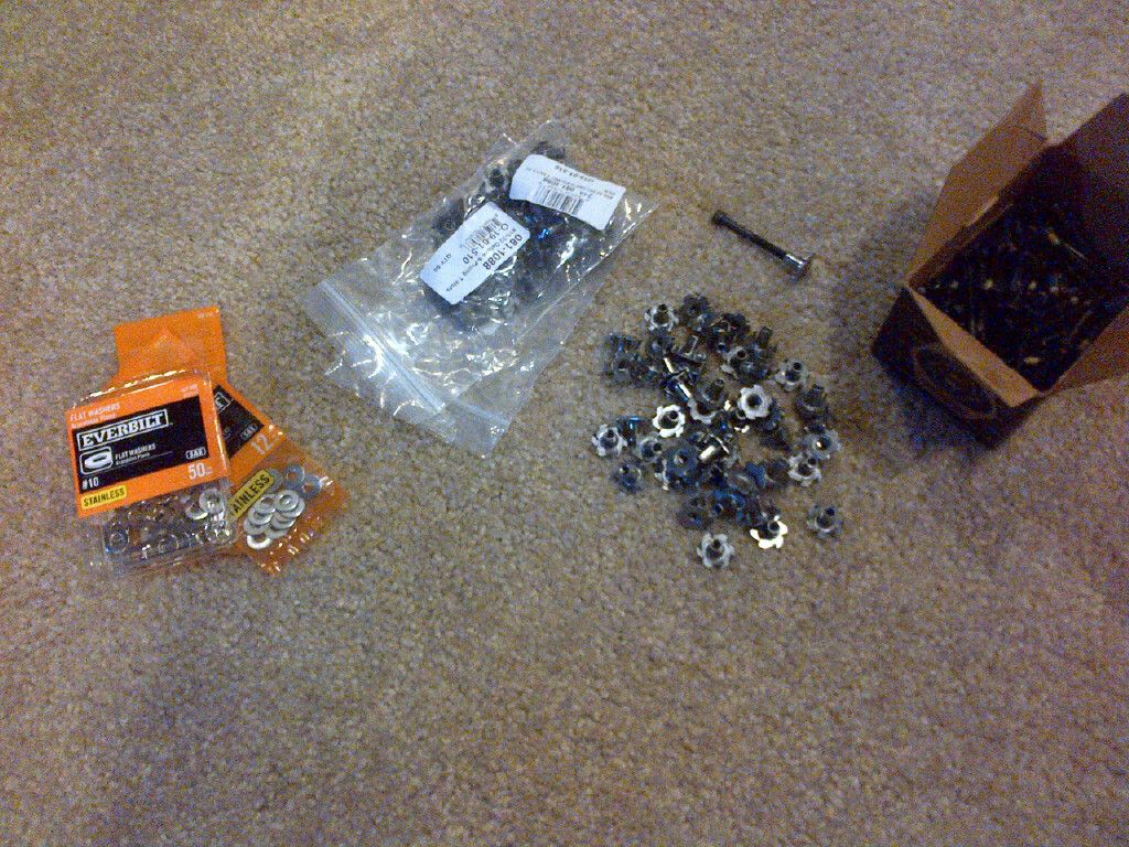

I decided on using premium t-nuts to mount the drivers because I didn't want to worry about my mounting holes wearing out if I replaced the drivers - even though the front baffle was two sheets of 3/4" Baltic Birch, with a third layer to inset the surround and basket. In hindsight I was very pleased I used t-nuts because a local friend of mine has two of these same cabinets, and has stripped out a hole in securing one of his LMS-5400 with regular wood screws after a couple screw and unscrew sessions in trying to seal an air leak. He can salvage the box easily by using t-nuts, or a larger screw - but I don't have to mess with that at all should I need to remove the drivers or unscrew the machine bolts at any time.
I was super fortunate that the CNC drilled pilot mounting holes for the LMS-5400 drivers on these cabinets matched PERFECTLY to the Ultimax UM18-22 driver basket mounting holes. So I simply drilled out the initial pilot holes in increasing size from 1/8" to 5/16" and used these premium t-nuts from parts express.
(Part # 081-1088)
http://www.parts-express.com/10-32-d...-pcs--081-1088
I haven't reviewed them yet on Part's Express site - but I need to. These premium t-nuts were incredible. Not one issue in installing 64. They are really a SOLID product. -- no stripped t-nuts, no cross threads - which is a common complaint of using standard t-nuts. Each t-nut has six prongs - and they are made of a high strength quality metal. I bought some 2" hex cap, black oxide, alloy steel, Brighton Best machine screws from an e-bay seller (part # 015139-100) These were also a high quality product and I am very happy with them as well. Mark Seaton recommended me going with the 1/4" t-nut for a bit extra durability instead of the 10/32 - but his recommendation was after I had already bought the 10/32 and I ended up having no issues at all with the slightly smaller size. My thought was the smaller size would leave a bit more wood between the driver circle cutout and t-nut shank. I put some serious crank on these with my 18V cordless drill on a couple test units and not one stripped out - or came loose - so I can't speak highly enough about this hardware and feel it is totally sufficient for my needs. This was a very time consuming process because in addition to carefully drilling out each hole (64 holes) in incrementing size bits(you have to make sure your t-nut installations are straight!), I had to lock down each t-nut before putting the driver in which meant tightening down each hole with a machine bolt and washer and then reversing the machine bolt back out again. This is a solid half day of time (at least) for these eight cabs before doing anything else at all!

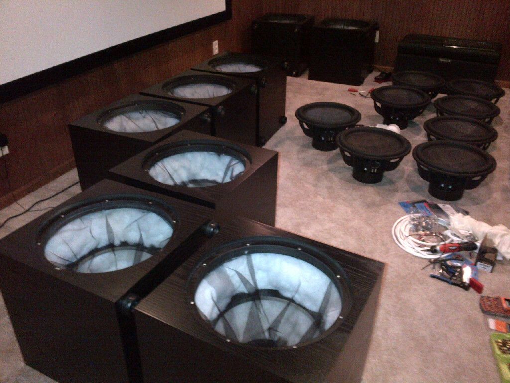

I then shop vac'ed out the cabs from the drill mess and applied a bit of cosmetic black paint to the drilled locations.

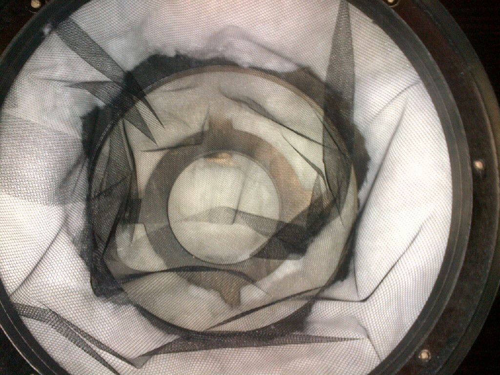

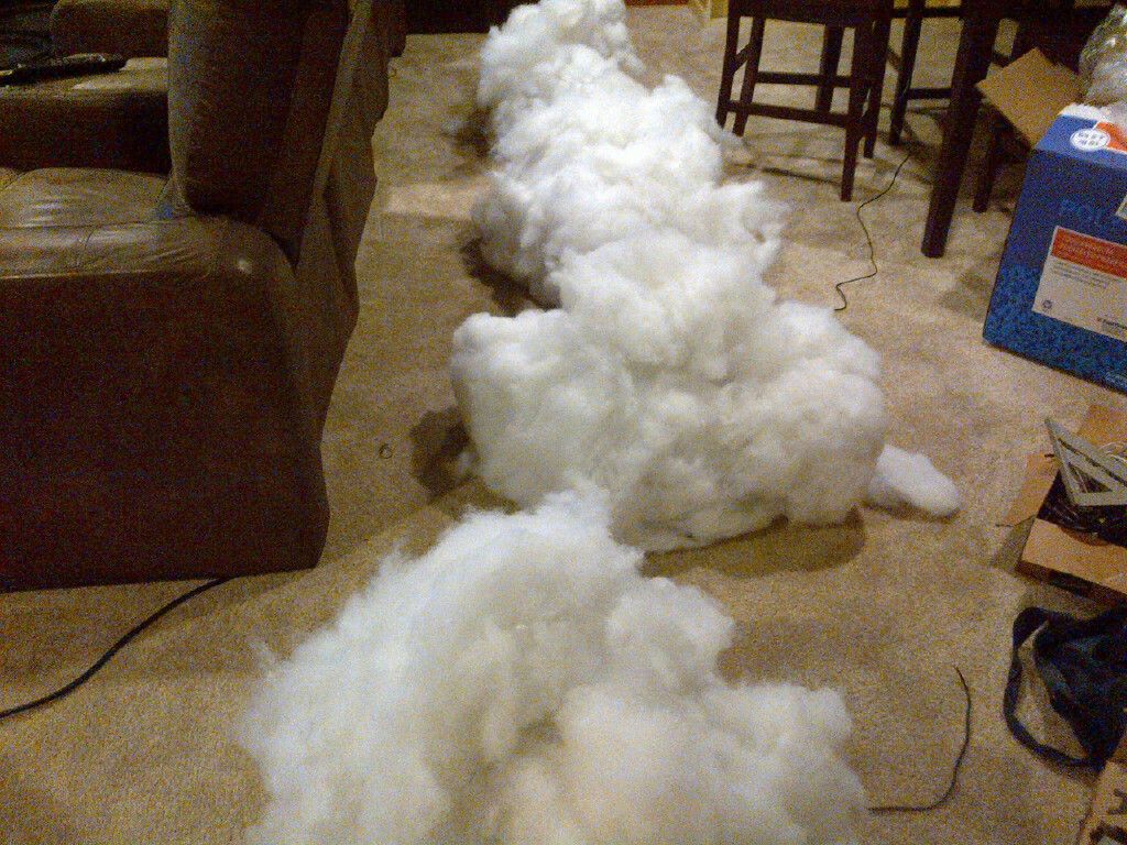

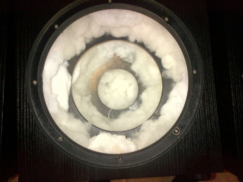

I divided up the 25lbs of poly fill into even clumps as best I could.
I mushed the clumps of poly fill into each cab. About 3 lbs per cab (or 1lb per cubic foot - per typical suggestion).
http://www.data-bass.com/data?page=content&id=79
I bought some cheap durable nylon netting from JoAnn's. I cut and laid the the nylon netting around the inside of the enclosure to ensure the poly didn't shift and come into contact with the driver cone, fearing impeding the cone's movement. I then stapled the netting in place.
rinse and repeat for all cabs...

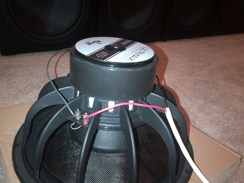

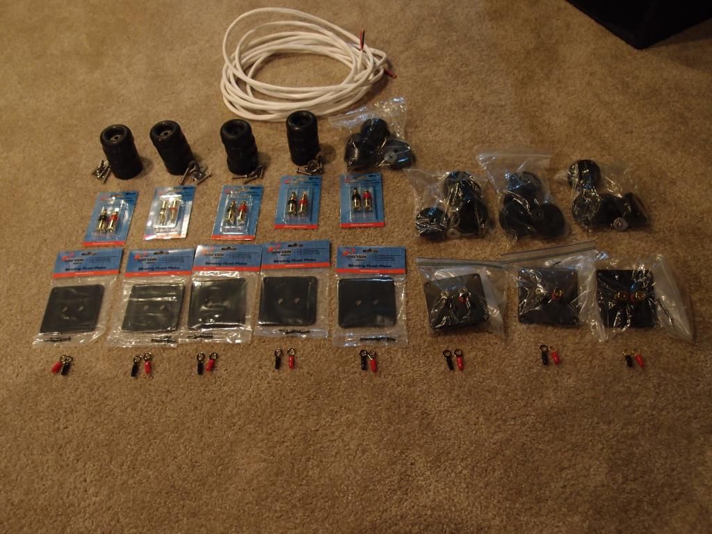

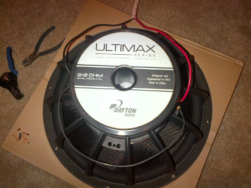

I then started wiring up the drivers: I wired each cab for four ohm (UM18-22 has dual 2ohm voice coils) For the internal wire + to - I used a small piece of 12 AWG Romex bent into a semi-circle (single copper wire). For the cable that lead to the back of the aluminum plate and gold binding posts I used a 3' section of 12 gauge finely braided speaker wire. To perform the back wiring I used the carboard cut out that shipped with the Ultimax driver so I could lay it face down on the carpet without stressing/smashing the surround.
Each driver was wired the same
I dropped each speaker in the cabinets after wiring up the Parts-Express binding post using gold ring terminals. I'm a big guy and didn't have any trouble just dropping the 50lb speakers into the box directly. If you are worried about smashing your fingers you can use long plastic zip ties to put in a couple opposite side speaker basket mounting holes and then use the zip ties as handles to drop the subwoofer basket in, and finely adjust it's position. After you drop the subwoofer in, then cut and pull out the zip tie. I found that step unnecessary. If I was mounting something exceptionally heavy like the LMS-5400 - I would have had to employ that trick to avoid damaging my boxes. I used a couple of small screwdrivers as tools in the subwoofer basket hole to finely tune the rotation of the driver to match my t-nut hole installation. I managed to mount all eight drivers without making a single mar on any of my boxes! WOOT!
Though - - -I actually had to use a wire snips to cut the o-ring so it would fit over the binding post connector, which I don't think I should have had to do - but the circle on the ring connector was too small to fit otherwise. No big deal - it is still just as functional. These are the parts I used for the connection to the terminals outside the box.
(095-665) - https://www.parts-express.com/gold-r...-pair--095-665
(091-620) - https://www.parts-express.com/dayton...-gold--091-620
(091-602) - https://www.parts-express.com/dayton...dized--091-602

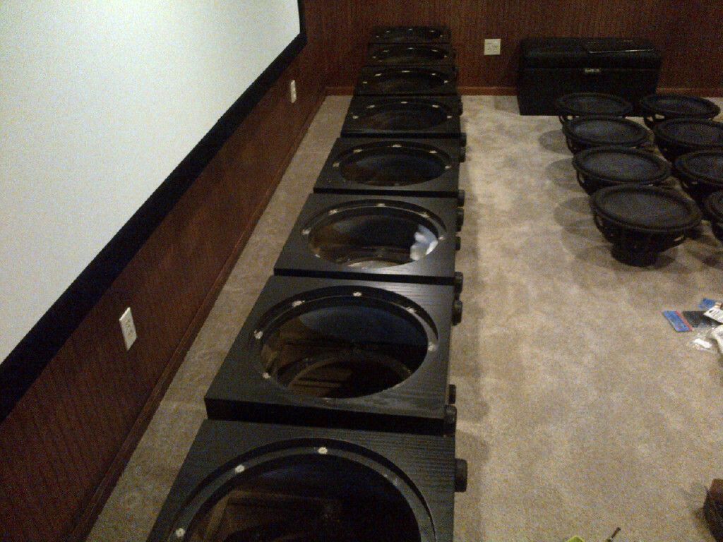

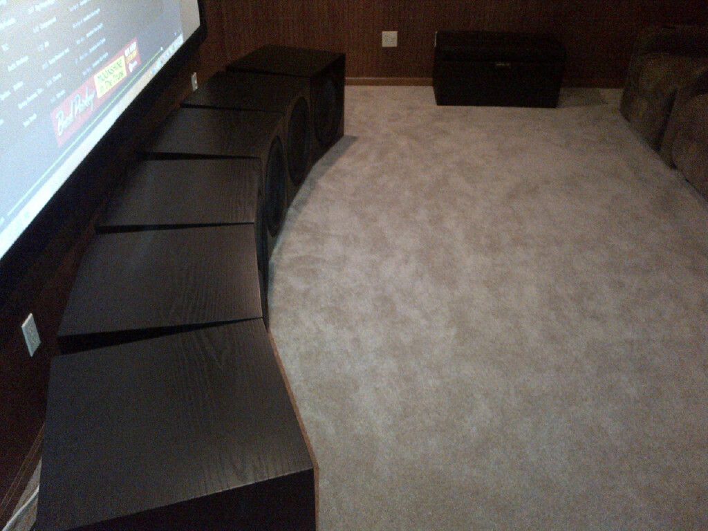

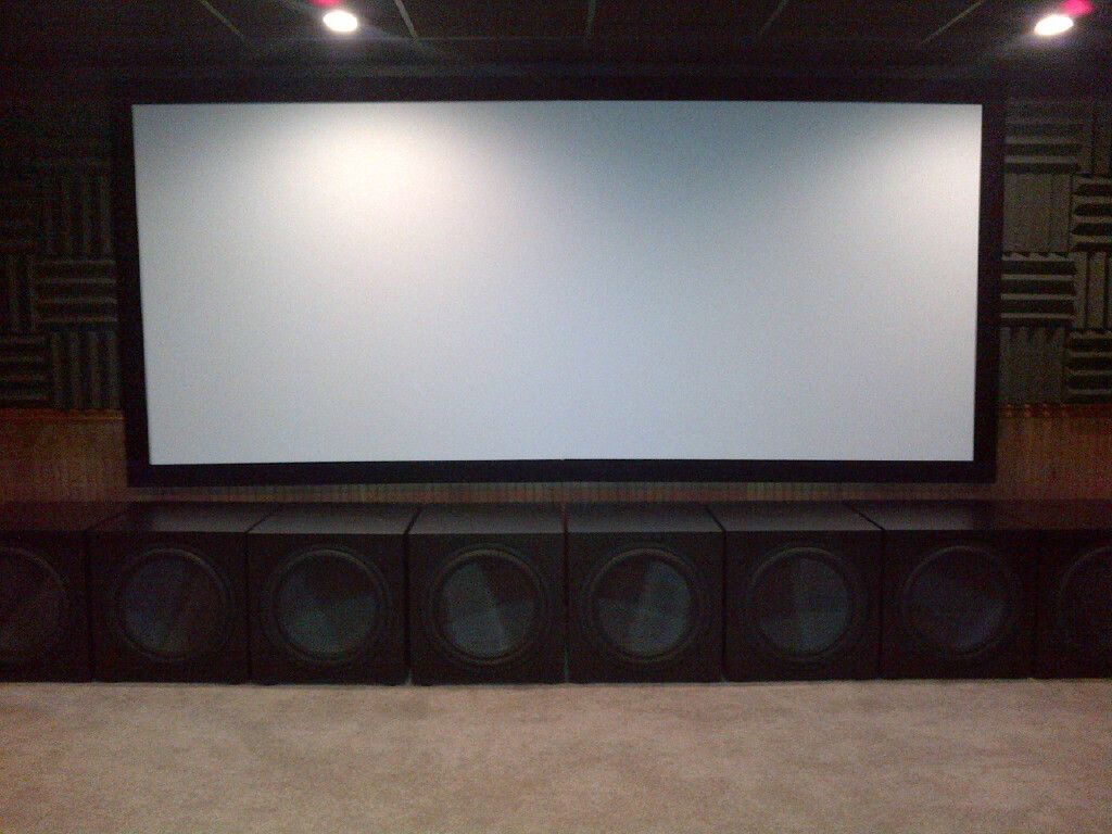

First run with all eight subwoofers up front...
This particular arrangement with the subs in a straight line lead to around a 50hz room null in my frequency response (so I ended up changing the setup to address that null).
Currently I have six up front curved in a slight semi-circle and two behind my main two chairs firing into the back of the chair for nearfield. The first six are run off "subwoofer output 1" and the back two are run off "subwoofer output 2" of my Denon 4520CI.
I am using a pair of iNuke DSP 6000's to run all eight subwoofers. Because of the impedance curve of these subwoofers I can run two Ultimax 18"s per channel in parallel (supposed two ohm load) on an amp not designed to run an impedance load below 4ohm on each channel. The UM18-22 only hits below about 6ohm resistance at frequencies below 8hz. I have implemented a high pass filter on my inuke DSP 6000's using this thread's advice to set a HPF at about 11hz, and thus can get away with running a "2 ohm load" on a minimum 4 ohm capable amp. How to extend the high pass filter below 20hz in DCX2496
If I don't employee the HPF, then the iNuke DSP 6000 can't drive two ultimax 18's per channel on very specific movie scenes like Black Hawk Down - Irene because the impedance dips too low and the amp power cycles, even at low volumes. However with the HPF in place I don't have any problems with powering a pair of these Ultimax 18" subs off a single channel of the iNuke DSP 6000 - even to very high volumes. So 3 channels of two iNuke DSP 6000's power my front six subwofers, and the remaining channel powers my rear pair of UM18-22. I'm not much of a believer in frequencies below about 15hz having much effect on the overall cinema experience - especially on my concrete slab theater space - - - so this compromise doesn't bother me much. At some point I may try a different amplifier setup - but for now it's meeting my desire.
I'll screenshot my iNuke DSP 6000 settings at some point and add them to this post.
dgage, noinimod and Ryansboston like this.

Archaea - Top notch post...thanks so much.
Glad to hear the tee-nuts worked for you but I get scared they'll come out or shred the wood so I went a slightly different route with my sub builds.
http://shop.stafast.com/sl14205h2130
I use a pair of small screws to hold them in place so I won't have to worry as much as I would with a tee or hurricane nut.
d_c and Gorilla83 like this.

Dgage,
I hadn't seen those before. Nice choice!

No kidding! I like that a lot. Tnuts are the bane of my existence. I quite using them long ago after I had some threads pull.

Well I wanted these Type J inserts but no one makes them in 1/4-20. I found a place in China that would make them for me but I'd have to order 10,000 units, which was about $1100. I decided the previous ones I posted were good enough, maybe even a little better.
http://shop.stafast.com/threaded-ins...ck-in/j-insert

not exactly --- let's split the difference. It's more like a ~3 ohm load on an amp that is spec'ed to do only 4ohm or higher.
The impedance graph (ohm/resistance plot) shows the UM18-22 to be a six ohm subwoofer above about 7hz. So I'm only running the subs in parallel as a pair at about a combined minimum of a 3ohm load above 7hz.
My workaround is the HPF which eliminates those frequencies which have the lowest ohm rating. Without the HPF - I easily overwhelm the amp with too little resistance and it power cycles, even at low volumes. With the HPF- no problems.
Ultimax UM-18 impedance chart is in bottom right for reference.

A little update.
I was tired of messing with the impedance limitations of the iNuke Amp paired with the UM18-22 when trying to run two subs per channel on the iNuke DSP 6000 (which is out of spec).
I now have three iNuke amps powering five sealed UM18-22 subwoofers up front.
2 iNuke DSP 6000's running 1 sub per channel (4 subs powered this way)
1 inuke DSP 3000 running 1 sub bridged (1 sub powered this way)
all split off the same subwoofer 1 output signal from the Onkyo PR-SC5508 prepro.
And my nearfields are disassembled because I'm going to rewire three of them to 1ohm so I can bridge those three off a Cerwin Vega CV-5000 amp. This will give each nearfield about 1650 watts on the 5K of output. I'll use a Symetrix 551E to provide PEQ to nearfield.
I post simply to provide an update of my experience on these sealed. Last night I spent several hours listening to well known demo clips with the front five subwoofers properly powered -- Results --- I'd quite clearly take my pair of ported 2011 JTR Captivators over those five sealed. The output capacity of my former JTR Captivators is much higher, MUCH higher. The UM18-22 are getting nearly 2,000 watts each. No impedance issues now, yet I can tax out the amps (and therefore the drivers (since the amps tax out at about 2,000 watts per channel which is in line with the peak rating on the UM18-22) long before I get to reference because of my 6dB boost at 20hz PEQ (Q of 2) and my 3dB dynamic EQ LP6, and the fact I like to run my subs 6-10dB hotter than the mains. Because of my room's shape with the baffle wall, once again I'm getting very little boundary gain because my subs are out about 6-8 feet from the cement wall -(since I have a baffle wall) --- therefore even with my PEQ boost and my Dynamic EQ boost, I'm still not flat to 20hz, or below. When I watch my demo scenes at -8dB with the subs 6-10 dB hot that's about all my amps/subs have in them when just the five are playing along the front wall. I could always run the same demos on the Captivator pair at reference with the subs 6dB hot in my old room and have no troubles with my proper HPF in place. To get to those same volumes - I'd have to cut out all my sealed sub boost and --- well then I'd rather just have the JTR ported Captivators - because I'm completely lost the benefit of the sealed. I've tapped them out, and they are insufficient for my listening preferences. (I know the subs are being fed their limit now because I ran some short 5hz test tones checking for air leaks at 4 signal lights, for like 30 seconds??? --- when I took the sub out after finding a leak - the smell of hot subwoofer/electronics was very present - so I feel comfortable knowing they can't handle much more power if they smell like that so quickly with what power they have currently.) I'm looking forward to @Ricci data-bass test on these UM18-22 to see how they do.
Conclusion: If I only had five of these subs I would be sorely disappointed right now.
NEARFIELD SUBS change the whole game though. With a sub right behind me I'm plenty satisfied with the sealed experience, and I think I'd need a lot less to be overall satisfied if they were only nearfield. Honestly, with my experiences in playing with this gear ---- I think if I had my druthers I'd take one or two sealed nearfield firing right into my back with a low crossover (like 60 or 70hz) over eight of the same drivers in the front of the room. Nearfield is just that good. So the current plan is to have five subs in the front of the room arranged under the screen, and three subs nearfield, immediately behind the three main theater seats. It is critical, IMO, that the driver is centered on the chair, and as close as possible, and firing right into your back. It is the only way I see any value at all in subsonic frequencies. You can feel them nearfield, you can't hear them, you can't flood your room with them in mass - but placed nearfield you get the subsonic ULF tactile effect and it is cool.
