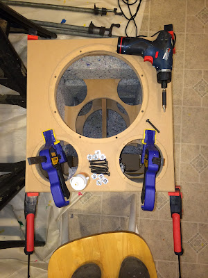

Sunday 12/1 afternoon progress
Ports glued in 2 steps.
Step 1 ...................................................... Step 2
Middle braces glued
Detail showing the 2 middle braces are lightly clamped to the bottom, then I clamped the spanner brace "down" by pulling it down via clamping as shown, and then the two middle braces squeezed to the spanner brace
middle%2520braces%2520close%2520iso%2520view.JPG . middle%2520braces%2520close%2520up%2520view.JPG
Hopefully Erich mailed me the rear brace (it got left out of shipment, his first ever for a flat pack) , and I can have that Tuesday, then I'll get steps done each night.
Ideally I'd actually do the rear brace/back first to establish all parts square to each other, but I did not want to wait.....took caution to make sure the middle braces are square.
My goal is sanding this next weekend if possible, and painting after that.

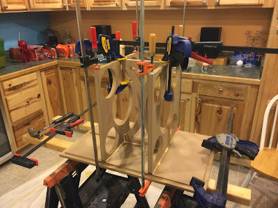

Came home from the all day robotics competition, checked on progress from this morning 8:00am - 9:00am , it came out ok, LH side and front inner baffle glued on....
Lesson learned;
When you use clamps, you need to put them on in a certain order, to pull it tight in 1 plane, then the next.
At the same time, you don't want to lock a gap in, so it's a learned process to clamp correctly.
I always recommend people to dry clamp the pieces before committing to glue.
Top ................................................................ Front view
The rear was slightly fwd of the back of the LH top corner, I guess the read inner brace possible not perfect,
I used a spreader clamp to set that flush to the LH plate, needed to "set" the inner brace to the lH plate for a firm anchor to spread from.
I drilled a hole for 1 5/8" deck screw, a good idea but I was too close to the top, about 3/4" down. A full 2" down would have ensured the brace did not split like it did.
No biggie, upon glue drying I'm removing that screw, and fill up the hole later with wood filler.
you can see that brace split slightly. Later I'll add to Gorillias DIY FAQ tip on drilling hole sufficiently down from edge to avoid splitting.
Yea, a brad nail would have worked but my air gun was up stairs and the deck screw was readily available.

Progress update;
routered rear for binding post cup.
Confirm port clearance to lining, also wiring routing as hands will need to get way back once top is on.
cut pieces to fit, glue on back ................................................lining in process
lining "done", top lining will be done after top is glued on .................. front view
Next up for this weekend:
-Glue top and front outer baffle
-wood filler at seams if needed
-sand & prep for paint

Liked: 629
I've added up total project cost so far, $652, I'm guessing close to $700 when done considering paint/other, post #3 has details.
Top is now glued on and drying.
Late last night: Marked brace location on top inside, cut lining to fit with clearance to braces/other lining on sides, glue lining on
Early this morning: Apply glue both top and box, spread, flip top and clamp down and square:
mtbdudex is offline

Sunday progress:
Morning before church:
I centered the frt otr baffle to the inner baffle, clamped it @ the ports, dropped in the 12" Ultimax driver, then drilled 1/4 holes thru the 8 holes using the driver as template.
Very careful not to hit the surround foam Took off outer frt baffle, drilled 5/16 holes in the lower front inner baffle for 1/4-20 hurricane nut install, put outer frt baffle back on
(I usually do NOT use hurricane nut's, but I've had these 2-3 years and figured what the heck have them, they are paid for, why not?)
Hurricane nuts installed, I used gorilla glue to hold them against the inner baffle MDF, each is exactly centered and square, as the outer frt baffle acts as a jig to keep each screw and nut square while being seated and glue dries
Go to VEX Robotics with the 3 kids, 1-6 pm, come home, get them into bed after dinner, then glue the frt outer baffle on.
Getting pretty decent at gluing the 2 piece baffle together w/o wasting too much glue that squirts out as clamps are tightened.
I tighten the clamps in a pattern, and have damp wash cloth ready to wipe glue from the seams as it comes out.
The 8 driver screws also act as clamp here, ensuring good bond inner to outer baffle.
That's it for tonight.
Oh, I should add it's so cold here I did some "minor" sanding of the MDF inner plate to top/bottom plate, and boy I did raise some dust in the basement eek.gif
Definitely I'll put in garage after some very little wood putty is put on seam area and dried for final sanding before paint.
Overall this is a very easy build, joints line up so perfect takes hands to feel the very slight imperfection, and wood filler and sanding will rid that easily.
