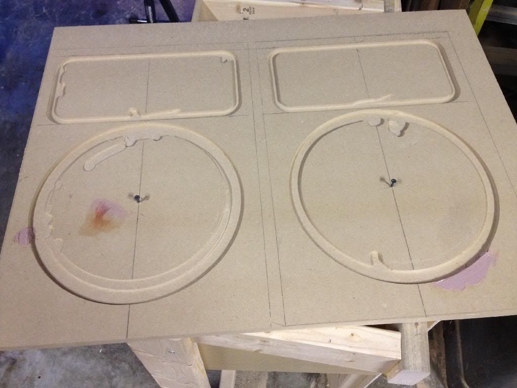

Sizing up the MDF baffles
Making a template to route the waveguide recess using one of Erich's CNC baffles
Rough cut out
Tonight I finish the waveguide template and start routing the baffles. Will also reinforce those halfway open mitre joints with some epoxy.

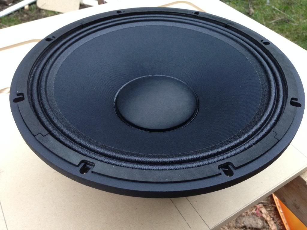

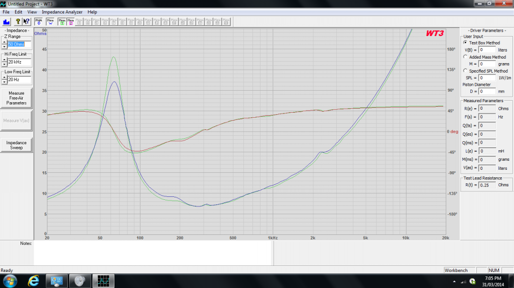

This post will contain the data I collect on the Celestion FTR12-3070C as it comes in.
First, free air impedance right out of the box (no break in).

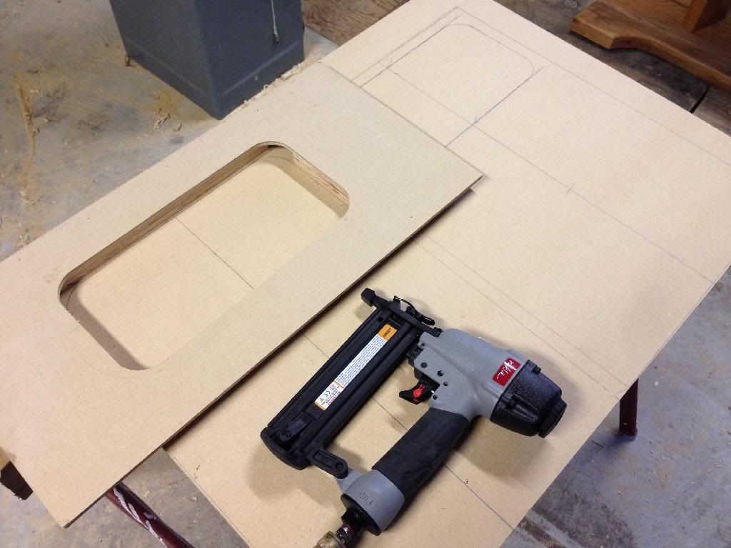

Template worked out good.
I fasten the template to the baffle using 18ga nailer into the surrounding material that gets trimmed off eventually
I forgot how must dust routing in MDF makes. I should have done this inside. I don't have proper dust collection. I wear a mask.
While I have the woofer out for measurements. I picked this driver partly based on looks.
Routing the driver recess didn't go well. Bondo up the boo boo.

Originally Posted by tuxedocivic View Post
Yes it'll be ported. Triangle corner ports. They're space efficient and easy to do, plus I like the look. Sealed roll off is a tad high, and I'd like to be able to play full range in a pinch. Tuning will be 50hz. That isn't full range enough for my music tastes, but in a pinch...
Would you mind showing the modeling for the triangle ports? I want to use them on my build but you're ahead of me. In WinISD since I can't figure out how to adjust the port area itself, I've just been "tweaking" the round port size until the area equals the triangle ports area. I'm not sure how this is going to effect the actual tuning though. I think it will be like a slot port when using the cabinet side as a port wall(some margin of error)
JohnDean is offline
post #25 of 509 Old 03-19-2014, 08:25 AM - Thread Starter
tuxedocivic's Avatar
Join Date: Feb 2010
Location: Ladysmith, BC
Posts: 7,842
Mentioned: 188 Post(s)
Quoted: 2202 Post(s)
Liked: 2078
Hi John,
I use unibox more than winisd (I use both once I've picked a driver), but I'm pretty sure winisd works this way. Select two ports. Square or round, doesn't matter. Size the ports via length or area, what ever it takes to size them how you'd like. I size mine for an 80hz XO at full xmax. The length is given, write that down. Not sure is area is given to you in winisd, maybe just the dimensions. either way, you can get area of a round port by saying A = pi*r^2 or pi*(d/4)^2. If the dimensions of a square are given, then A = LxW. Simple. Once you know the area of the port, you need to get the dimensions or your triangles. A = (LxW)/2. L and W are equal, so A = (L^2)/2. So you can find out the sides of the triangle. For instance, I think my port area was 20cm2. You can solve for L if you're good at algebra, or you can open a calculator and do this. 5 x 5 /2. That equals 12.5. Ok, 6x6 /2 = 18. Ok 6.5*6.5 /2 = 21.1. 6.25*6.25 /2 = 19.5. Good enough.
Now that we know the sides of the triangle are 6.25cm, we need to know the length of the piece to cut, the long side of the triangle. That's the last photo I posted above. That width is found by a^2 + b^2 = c^2. Let me simplify that for you. SQRT(L^2 + L^2) = Width of piece needed. For the 6.25cm port, thats SQRT(6.25*6.25 + 6.25*6.25) = 8.83cm. So I have to cut my ports 8.8cm wide.
For the length, don't forget to include the tickness of the baffle. That counts. Which I forgot about in my hurry last night. So I need to trim 3/4" off each of those ports.
Yaaa, that probably is a head scratcher. If that makes sense to you, great. If you are totally confused, just post the dimensions winisd is asking for and I'll work it out for you.
My youtube channel: Impulse Audio
tuxedocivic is offline
post #26 of 509 Old 03-19-2014, 09:44 AM
JohnDean's Avatar
Join Date: Jul 2012
Location: Franklin, TN
Posts: 1,237
Mentioned: 22 Post(s)
Quoted: 470 Post(s)
Liked: 207
LOL. Yeah I'm with you and that's what I've been doing.
It's just simple geometry. I was more interested in whether the models are accurate since the port is using 2 side walls of the cabinet and I'm kinda manipulating the data for the port size. It seems like it works fine though. Thanks.
Oh and inches man, I understand inches. ;-)
" I size mine for an 80hz XO at full xmax"
Are you adding the x-over into your sims also? I've never done that. Let me see if I can figure that out. I'm thinking that affects the power you can model with at the same time keeping it under xmax
JohnDean is offline
post #27 of 509 Old 03-19-2014, 10:10 AM - Thread Starter
Join Date: Feb 2010
Posts: 7,842
Liked: 2078
Ah, ok I misunderstood what you wanted to know. Ya, I find it pretty accurate, but I've only done it a handful of times. The port material is only 1/4" and I keep it a tad long. If I need to shorten the port, it can be done relatively easily with a dremel grinder or something. There will be some natural extension along the port wall, so probably a 1/2" to long.
Yes, you can put a 12db/oct high pass on the model and excursion and port speed will reduce significantly. No sense oversizing a port. I usually check 60, 70, 80, and 100hz. Just to get a feel for the different setting and understand how the speaker should perform. Then the real world comes along and I do a ground plane measurement to make sure the model is actually working ok.
post #28 of 509 Old 03-19-2014, 11:47 AM
maxcooper's Avatar
Join Date: Jul 2003
Location: Silicon Valley, CA
Posts: 1,689
Ah, now I get it. I thought you were just going to trace the cutout with a pencil and then cut it with a jigsaw. :-) It looks like you used a flush trim bit in the router, with the bearing riding on the DIYSG baffle cutout.
-Max
maxcooper is offline
post #29 of 509 Old 03-19-2014, 12:30 PM - Thread Starter
Join Date: Feb 2010
Posts: 7,842
Liked: 2078
I should have described that better. Maybe I'll add some photos. But ya, flush trim bit to get the template cut. Then a top riding bearing pattern bit to cut the recess.
