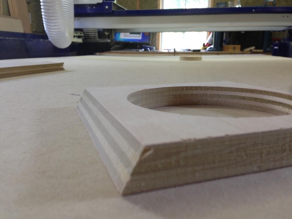

Been a while since I've contributed anything here. I finally got around to playing around with stepped bevel cuts. After a couple trials, success! Angled cut with a straight bit!

post #260 of 324 Old 08-10-2014, 04:31 PM
awedio's Avatar
Join Date: Apr 2005
Posts: 197
Quoted: 79 Post(s)
Liked: 26
So schweeet
How thick is that material?
awedio is offline

What angle and how many passes was that?
Passes doesnt really matter but I was curious. I have seen some amazing carving designs uses a straight bit on a CNC so I figured angled cuts would be easy. Thanks for the update. BUT no video of it in action.....lol After seeing the GTG pics I was only waiting for the next video to be posted.

Originally Posted by awedio View Post
So schweeet
3/4 birch plywood, actual thickness around .720
Angles were 63 and 64.5 degrees. I took a .25 inch bit and stepped it down the edges of the board in .110 inch increments (radius of the bit plus some extra room for stepover). Each pass was done in a single slope. It took quite awhile to cut compared to a normal profile cut, but this technique can be used to cut any angle over any specified distance with relatively smooth edges. This video wouldn't have been too exciting, but I can grab something more "interactive" next time I build something.
Gorilla83 is offline

Its up to you on the videos. I know people have lives and stuff to do so if you ever get a chance that would be awesome.
When cutting angles like you did would it be better to have a few angled bits like 45, 22.5 or no?
I know some of the tool change racks are available but this might be faster. And do you have to zero the bit after the bit is changed by the automatic rack?(not manually)
It's probably a good idea to have some bits with common angles around (like 45, 60, etc). At the very least they could be used for putting an edge profile around a panel or something. I like the idea of not having to switch bits and re-zero though when doing it with the stepped 'flutes' like I did above.
An ATC (automatic tool changer) would be AWESOME, but since they are a 8500 dollar+ add on, not very likely for me.

Recent project. First time using a large 45° tool on the CNC. This is a new GR Research OB design.
