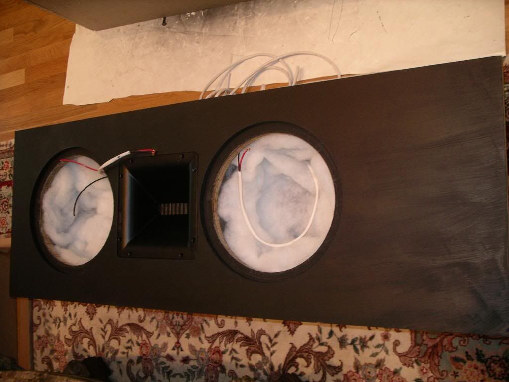

Center channel, just needs TD12M's. Damping material has been applied, box has been stuffed and wired.
[IMG][/IMG]

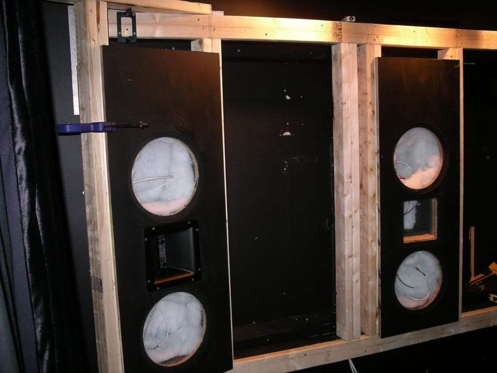

Pic of center and left surround fit in place.
[IMG][/IMG]
I have also installed the sub that fits in between the left surround and center speaker. Still remaining:
1. Build right side.
2. Extend baffle framing to the ceiling.
3. Stuff cavities with fiberglass insulation.
4. Install 3/4" MDF on face of baffle.
5. Cover baffle wall (behind screen) with 1" black duct liner.
6. Install drivers and wire everything up.

Have all five boxes in the baffle wall.
[IMG][/IMG]
mjgarrett100@gmail.com
[IMG][/IMG]
What frequency range will the 18+ be handling? I know you said mid bass, but was curious if that's along with the TD12M's.
That's going to be one crazy ass wall of sound.

The boxes shown for the 18's are for two subs (SI-18). The TD18's will be located right under each main. The TD18's will cover from 200 down to 80 or 60.
