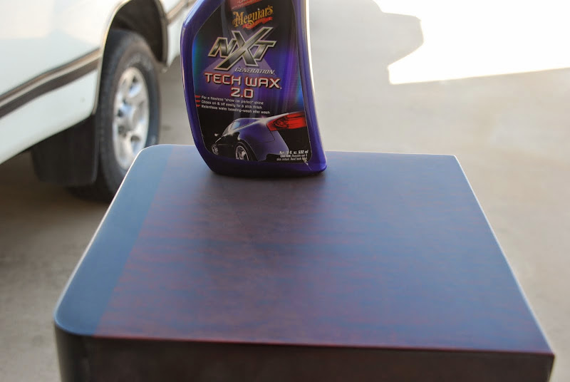

Dry sanded with P800. Not reflective yet.
Next, I will dry sand with P1200, P2500 and P4000.
After dry sanding with P4000, it is pretty reflective already.
I haven't polished yet. Again, the bottle of polish is just to show the reflectiveness of the cabinet so far. I think we can clean this mirror a bit.

Rubbing Compound, Polishing Compound, Swirl Remover then Wax.

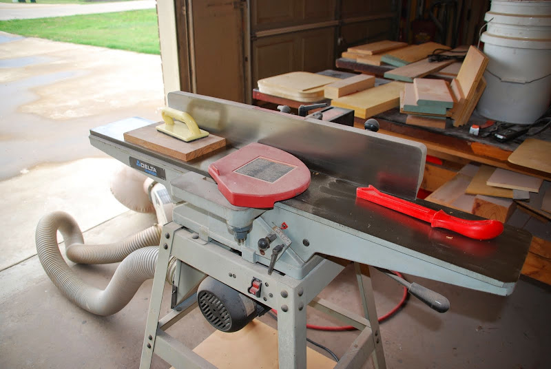

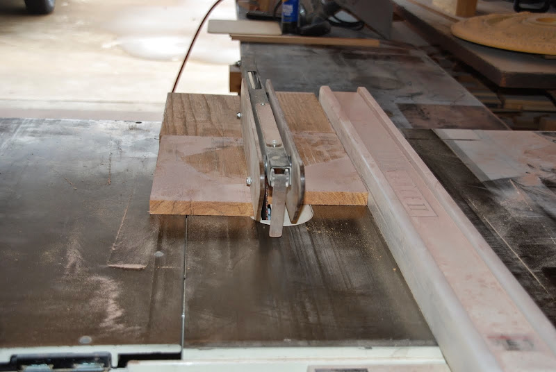

This oak is cupped
Here's the solution--rip them down the center...
You can already see far less cupping.
Joint the faces.
Then the edges.
Ready to put them back together.

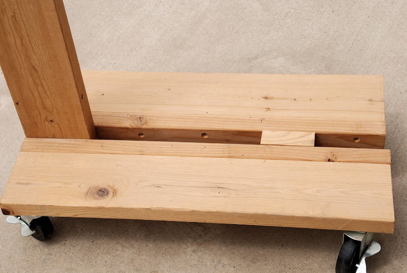

I need to rebuild the finishing stands, so they are collapsible and can hang on the wall when not in use.

Is that your stand for spraying? Can you show a full picture of it?

For the finishing stands, I tried two different approaches, beginning with the slanted one. I later made a simpler straight one.
Here are a few shots.
And the mounts.

Can you explain which boards were ran through the wood jointer? What is the purpose of a wood jointer? Is it for making doors and other things were you have to cut grooves in two pieces of wood in order to mate them together with a stronger joint as opposed to using a but joint?
Also, what is the point in having both a wood jointer and a router table as the router table can also do wood jointing too, right?
As soon as Harbor Freight sends me another 20% or 40% off coupon then I am going to purchase a nice router table or possibly the wood jointer. Their router table retails for $199 and the wood jointer retails for $399 but, they have a floor model wood jointer for $280 that I might pick up! I want to start making a new set of kitchen cabinets and more specifically, doors, as well as other general "house" stuff such as bookcases and TV cabinets, raised panel wainscoting and so on... !

Marty, here is a good article on jointers vs. planers, which should help.
Yes, you can edge joint on a router table, but you are limited by the length of the bit. Just something to consider for future growth. By the way, you saw the only two boards that I needed to joint in the thread.
I admire your enthusiasm. My experience has been that the more involved you get with woodworking, the more important it becomes to have the right tools to get professional looking results. Once you get started, you might not stop until your entire house has been customized!

Thanks for the pics of the stands. I appreciate it. One more question, how do the mounts attach to the speaker? I assume you insert the pipe through the binding post hole in the back of the speaker and then put one mount board on each side of a brace inside the cabinet and screw them together to hold it in place?

In this case, the mounts are held in place by spreading pressure.
I ground the points off the screws, so when I tighten them, they provide spreading pressure inside the cabinet.
