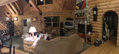

Family room 5.1 set-up, pano via iPhone 5s.
It's open family room, the TV/Audio is corner placed due to fireplace, I know not ideal from sound PQ viewpoint but primary HT is the basement and this is "just" 5.1 for casual TV viewing and music when family gatherings happen.
Like stated these will also see 2nd duty as occasional outdoor HT speakers
Outdoor movie annual fall 2-3 showings/year, I mount the R/L on the walls, and the center goes below the 16ft x 9 ft screen.
The PJ is 29 ft back, people sit between 10 ft and 30 ft, I've had 45 over before

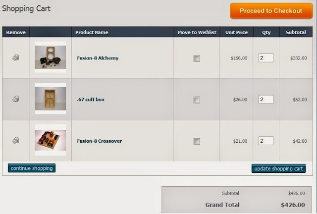

Shopping cart made, will place order#1 shortly, now waiting for the 8ohm fusion-MTM R/L and Ctr to show up that will be order#2
You just made a payment of $440.19 USD (shipping included)

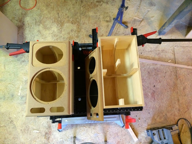

All my shipments arrived, as usual DIY soundgroup has excellent packaging.
Here I'm un-boxing the Fusion-8's in above garage workshop.
I won't touch the MTM's till the Fusion-8's are done.

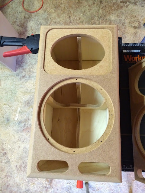

Stack of pieces....
Simple dry fitting, these go together so easily
I notice the top brace edge by the waveguide barely protrudes, will dry-fit the waveguide to see if issue or not
RH side surround going here, not down firing rather on side and angled forward
LS side surround going here, same side and angled down and forward

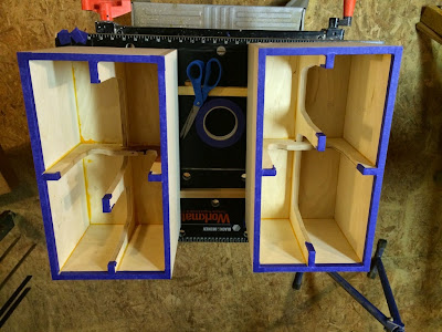

Making progress - I love weekends early morning time .
Dry fit with clamps to establish glue and clamp strategy, which clamp to do 1st/2nd/etc.
I'm using basic titebond, have a damp rag on hand to quickly wipe overspill to make staining come out good.
put pencil marks where braces should align makes the job easier and more accurate
Glue time
Plenty of clamps
I like putting my clamps in place loosely so I don't lock in a gap, then tighten it in sequence to get it nice and tight, as tighten wipe seams with damp rag.
For me those cheap 90deg corner clamps are easy way to assure square corner.
