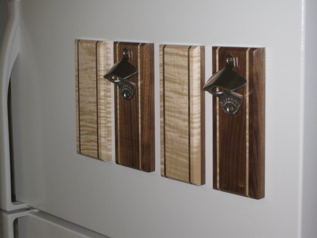

Lightbulb Not exactly audio related...(fridge-mounted bottle openers via N50 neodymium magnets)
...but I figure many of you here like beer and building things, so I thought I'd share
I built some fridge-mounted magnetic bottle openers; two as Father's Day gifts for my dad and grandpa, one will be a Christmas gift for my brother & sister-in-law, and one for myself (and my wife).
To give credit where credit is due, I ‘borrowed’ the idea from Kent Frayn & Joe Walsh's website dropandcatch.com.
The basic concept is the magnets both hold the bottle opener to the fridge and also snatch the falling caps right out of the air. The versions I built can catch and hold about 100 caps, although I generally clear it off before that many build up.
It definitely serves as a good conversation piece, when we have company over.
To build the bottle openers, I used walnut and maple hardwood obtained from Menards and Home Depot, Starr X bottle openers from Brown manufacturing, and high-power Neodymium magnets purchased from CMS Magnetics.
I feel like I really lucked out with the maple, as I found a 1x4 just sitting in the rack at HD that exhibited some nice curly/tiger-stripe figuring (and it only cost me $6 and some change).
Anyway, on to the pictures…
Pieces dry fit…
Glue up of front…
Glued fronts sanded…
Cavities routed for magnets…
Magnets installed…
Glue applied…
Clamped…
Look, the magnets work!
Watco, rattle-can lacquer applied to the walnut versions…
Bottle openers mounted…
Lacquer applied to the maple versions…
A couple group shots before I gave the walnut versions away as Father's Day gifts…
The one I'm keeping in use…
Anyway, just thought I’d share

Thanks guys! Wish I could say the idea was my own. If it was, I'd be selling them online and using the proceeds to fund speaker builds . I'm not all that creative myself, but can do a decent job at reproducing things if I have a picture to work from.
My next speaker build will be a pair of SI 18 D4s (bought them back when it looked like they were going to stop manufacturing them). I'm torn between doing 'Funk Audio' style curved cabinets, or Marty-cube style ported boxes.
Unfortunately, it will be a while before I can even get started on them. One stipulation of the purchase was I could buy them, but could not build the boxes until AFTER I finish remodeling our master bathroom (which is currently gutted down to the wall studs and floor joists). I guess it was a win-win agreement; my wife gets her bathroom done (somewhat) sooner, and I get new subs.
I'll definitely start a build-thread when I do, but it'll probably far later in the year before I'm able to finish the bathroom .

Thanks for the kind words!... although I wouldn't feel right selling them since I copied the idea from a couple guys who are trying to make a business of it (see reference in first post).
I'd also be underwater in the $30-$35 range; the 2"x1/2" N50 magnet that catches the caps is $23 by itself (and holds 106 lbs). Of course, I probably didn't need to use magnets quite that strong...
