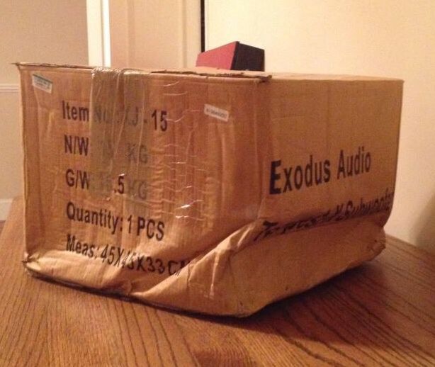

I pulled this out of the garage this evening. I bought an Exodus Tempest X-2 back in December 2009.
Since then, I have changed careers, starting working six days a week, and lived in Connecticut, DC, Charlotte, and now Atlanta. Notice the two different moving company stickers in the picture below.
I'm a bit worried as the box has nearly disintegrated. The last two years were spent in a very damp basement in Charlotte (the box, not me - I was allowed in the house).

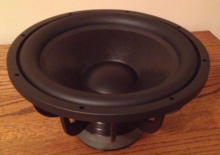

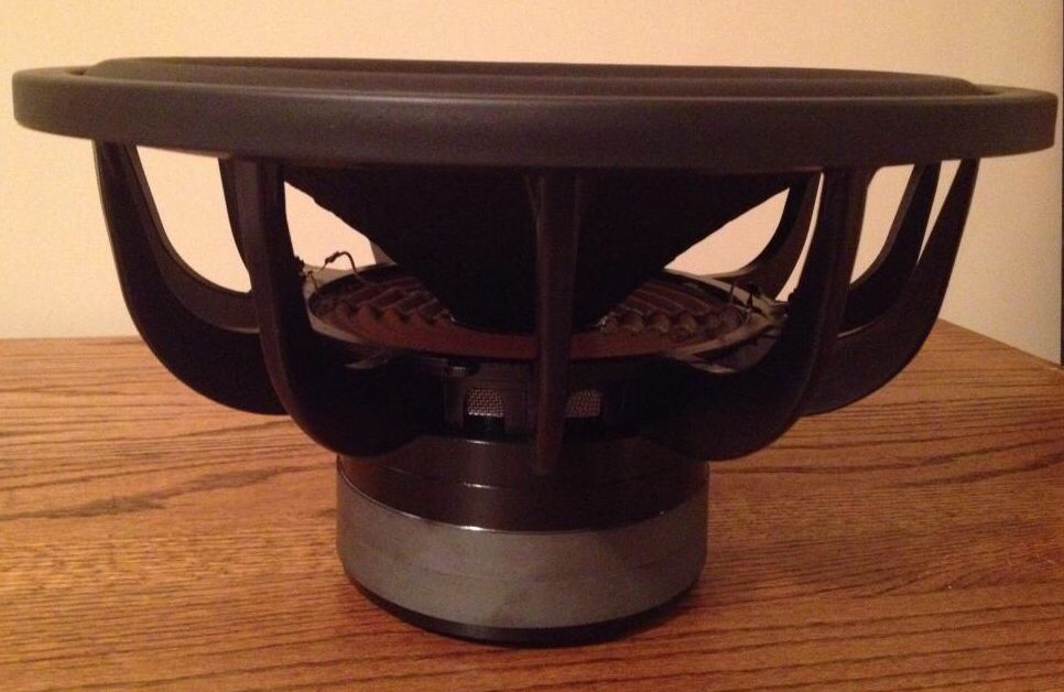

Luckily, despite the condition of the box, the driver was still wrapped in plastic and wedged between two chunks of packing foam.
It *appears* to be in ok shape. Obviously, I won't know until I spend countless hours building an enclosure.

Would this 15 work for a Marty mini or Marty cube tuned to <20 hz?

Just checked the specs and it would work well in a minimarty . Wants 9 cuft vented so not good for cube. Will take 1000 watts.

You could always test it free air with a 17hz sine wave or such to make sure the coil isn't rubbing. It shouldn't take much power to get it moving.

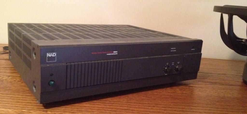

I have this old NAD 2600A stereo amp from the late '80s. Would it have enough juice for a mini-Marty?

Thanks Kevings. The NAD belonged to my dad.
According to this site, the NAD is rated for:
MONO mode, Continous average power output : 1x 500W (27dBW ; min. RMS, 8 Ohm, 20Hz...20Khz).
Does this seem ok for a mini-marty? This is probably a stupid question, and I really am not familiar with amp spec charts, but does this mean that the NAD will not output any signal below 20Hz?
Maybe if I add a second large sub, I would need to think about a more modern amp (inuke 3000/6000)?
Obviously, one disadvantage of the older amp is no integrated DSP.
I was thinking of putting a MiniDSP between my AVR (Marantz SR5008) and the NAD so I can control the signal and/or set a HPF.

That amp can hold you over until you get something new. Will be losing about 4dbs . Its the hpf and eq that are important as well
