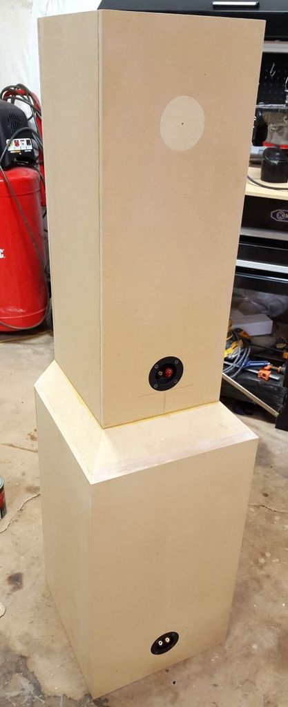

On to the 893's...
Got the crossover boards from Matt and put them together without issue:

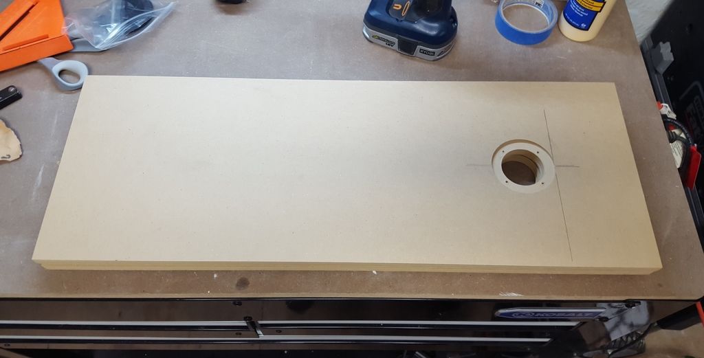

Started the same way as the Volts by routing out the hole for the terminal cup:
Then glue up the sides of the first one:

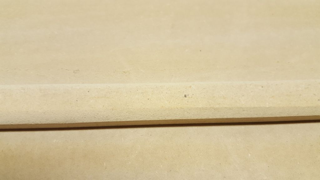

However, there was an issue here. I was really frustrated when this happened but I'm posting this so nobody makes the same mistake. The back board with the cuts for the braces looks symmetrical, but it isn't. I wanted the terminal cup to be at the bottom of the enclosure, but I found after prepping to put the baffle on that the brace would be blocking the waveguide unless the baffle was reversed so that the terminal was at the top. So either add your terminals after it's all assembled, or make sure you know which is the top and bottom before you cut the hole...
I used the plug cut out by the hole saw, as well as a new routed piece to fill the old terminal hole and cut the new one. You can see all the caulk around it on the right here. Lame...

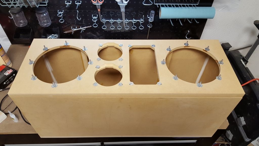

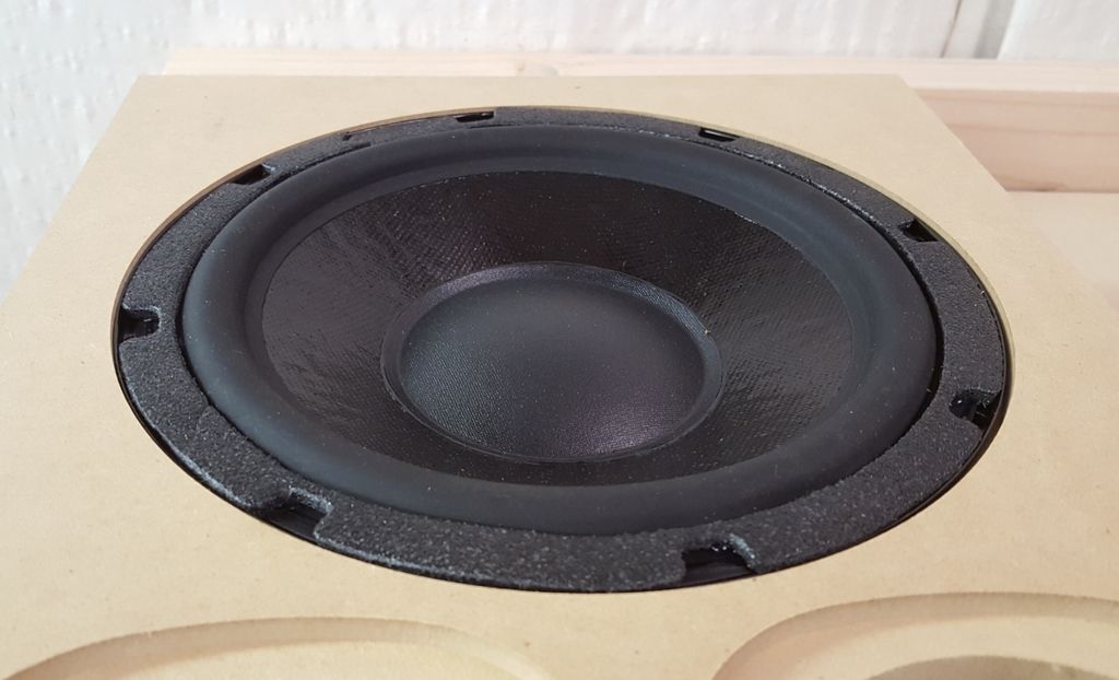

T-nuts for all drivers:

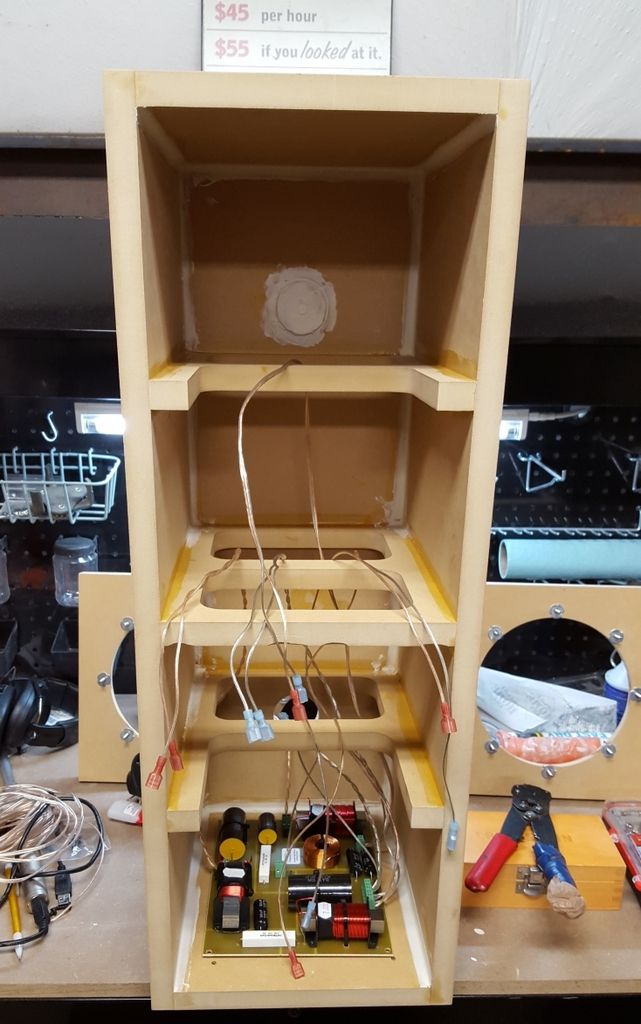

Crossover installed and wires ran:
Compression driver bolted to waveguide and gasket installed:

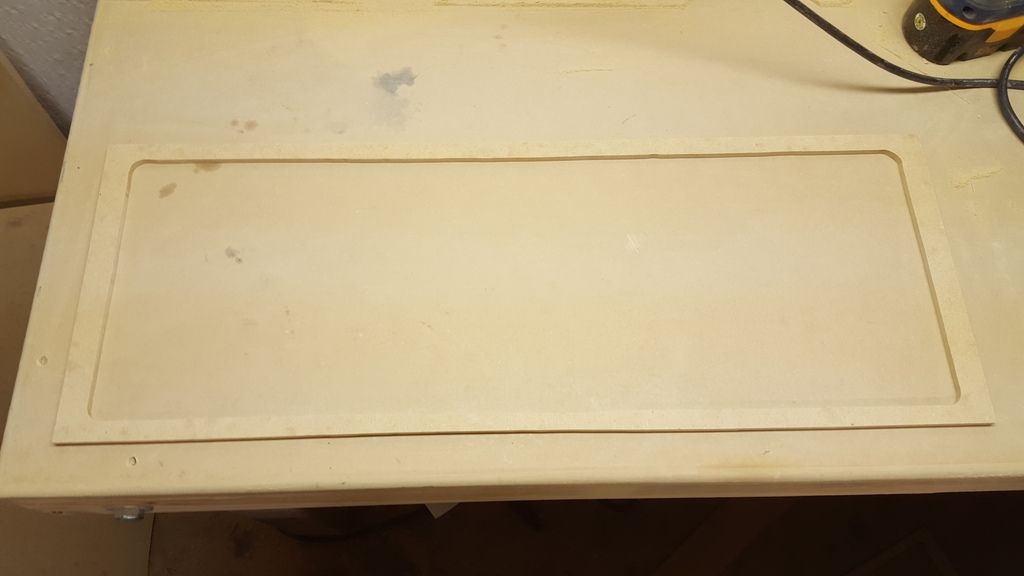

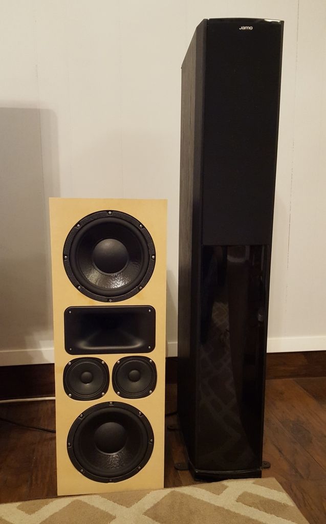

For the flush mount look, I had intended to make another 1/4" baffle to mount behind the main baffle to be able to sink the woofers in further while still having enough wood to be stable. But I couldn't find a router bit locally that could do it properly, so I decided to shave down the front foam gasket on the woofers, since that's what sticks out.
It's now more or less in line with the surround:
Flush with no wood cutting
Baffle installed and brought inside for testing:

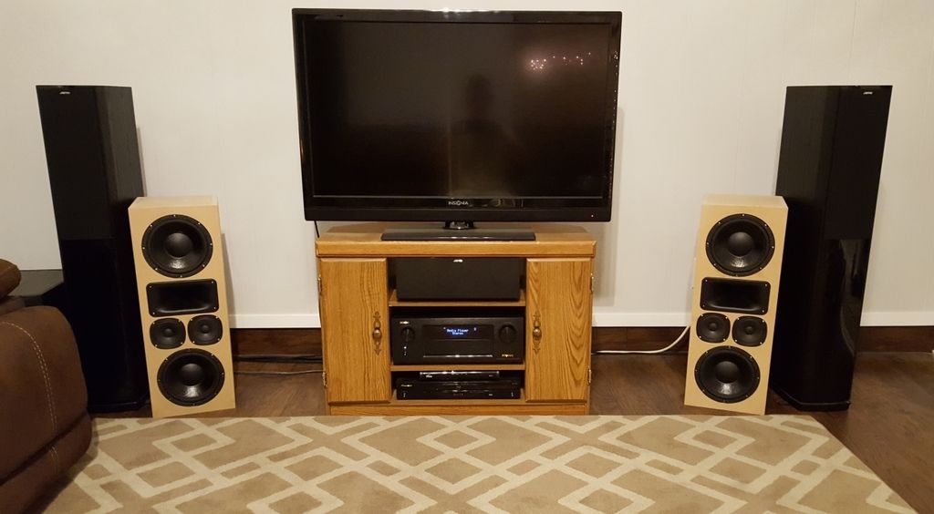

Next to my S606 towers with the drivers installed, along with most of a Walmart polyfill pillow worth of stuffing:
I just played it for a couple minutes to function test. Additional efficiency was immediately noticeable, as well as the corresponding increase in dynamic abilities. These are gonna be good!

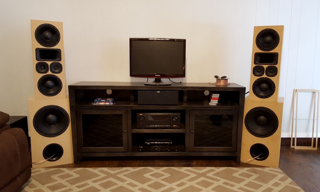

Both make sound now!
Got the second baffle glued on, flush trimmed, sanded, and brought inside.
Stuffed with polyfill:
Drivers installed and set up for some stereo testing:
Spent some time sitting on the floor listening to them. No EQ, crossover at 60Hz. I'm liking them very much. The increase in dynamic impact over the old speakers is my favorite part so far. Definitely adds a feeling of realism. Listened to a track with an orchestra component and I can just see the bows sliding over the strings of the instruments. Snare drum punch is vastly improved. All drums are very tight. Not as punchy below 80Hz as my old towers, but that was expected and will be more than made up for by the Magnum 12 below them once I get them in. This room is also pretty lively with nothing on the walls yet, so some treatment and a bit of room EQ will only help.
So far I'm very happy with the quality of the kits and the sound I'm getting. Once I'm done listening to a bunch of stuff I'll take some measurements.

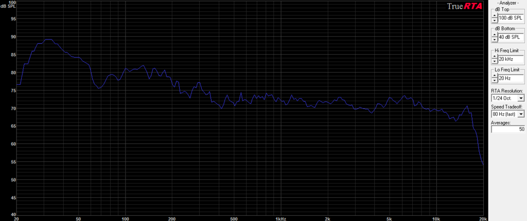

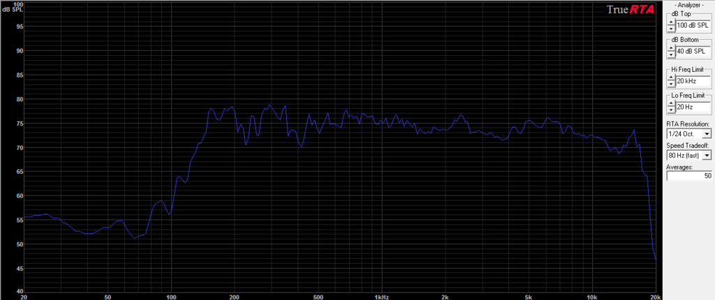

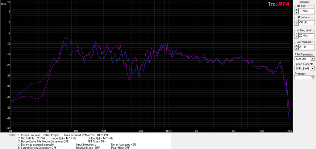

Well it looks like I got sent 1 wrong resistor for one of the Volts so the compression driver is 6-7dB hot in that one. But no big deal, should be an easy fix.
For the 893's, they look decent other than a fairly significant dip in the 400-500Hz range followed by a large peak in the 900-1000Hz range. I did some looking around and found another user with a similar response curve in that band as well.
Here's the left and right:
If anyone else who has built these would share their response curves as well that would be cool. Or if you have any recommendations to improve the midrange response. The crossover is assembled per Matt's diagram and the mids are not out of phase.
They certainly don't sound bad. I'm just wondering if there's anything I can do it make them even better. FWIW, I did a bit of manual EQ in the AVR which resulted in this combined response:
Just interested if anyone has any suggestions to improve the dip. I did try measuring with the speaker up on a 2ft tall stand with no real difference. I don't think it's a room issue since the dip doesn't show up in the response of any other speakers measured in the same locations.

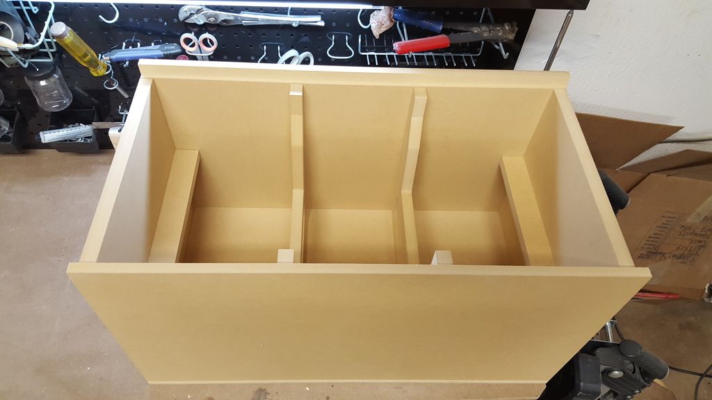

PE and DIYSG orders both arrived this week. Christmas in April!

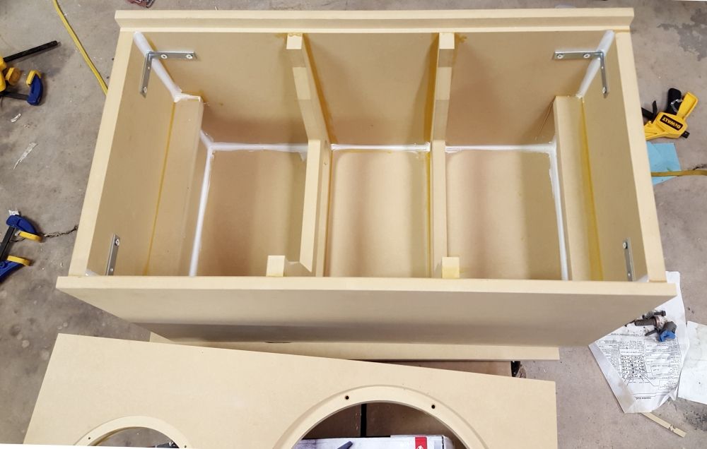

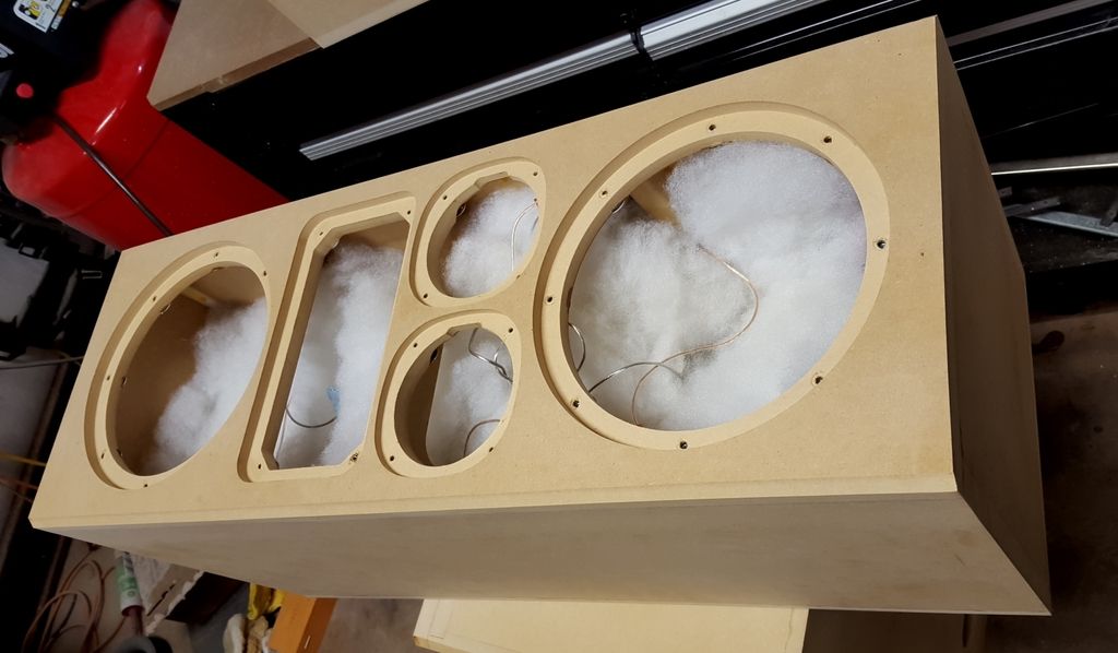

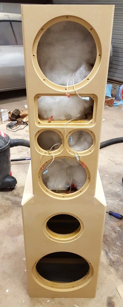

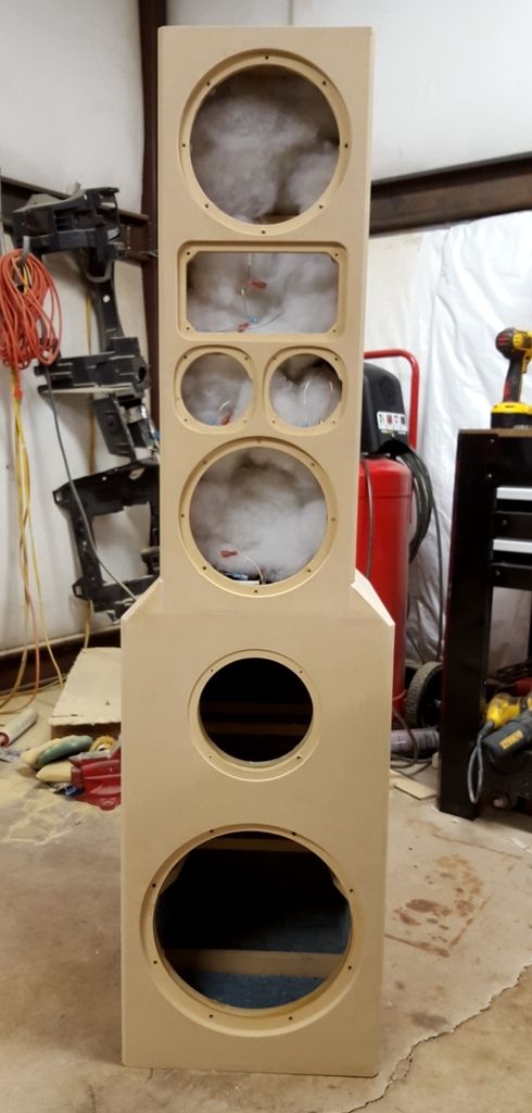

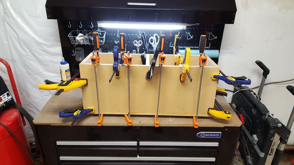

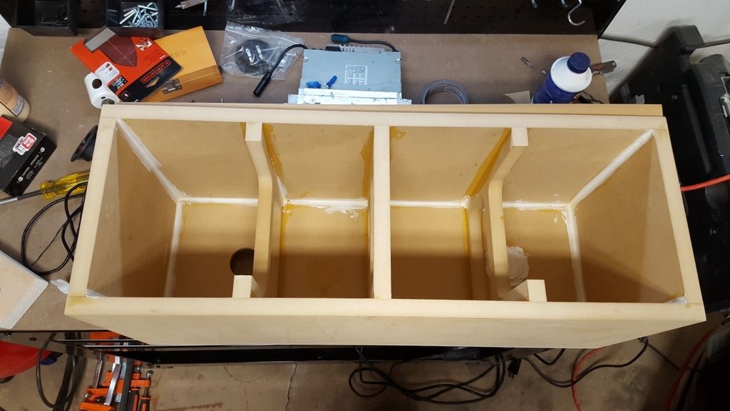

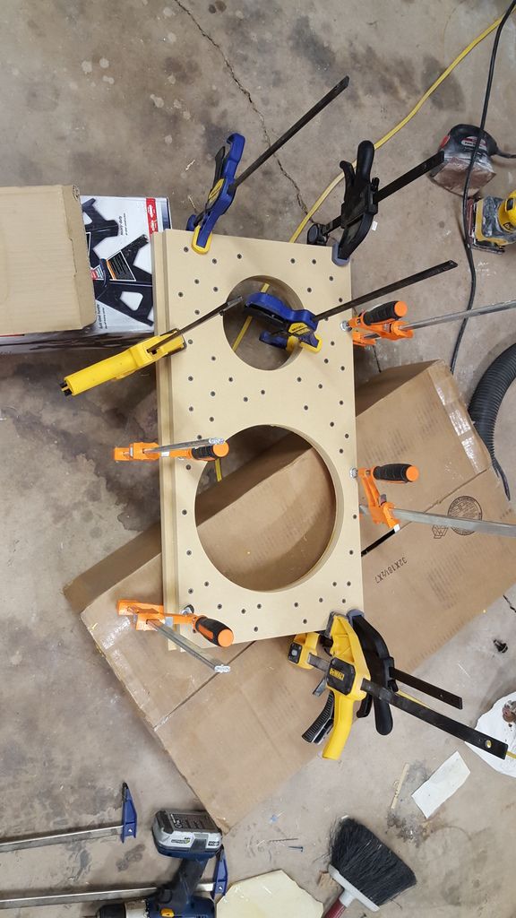

Wasted no time getting to work. No glue mock up of the pieces. Decided to build it in stages since I only have a few clamps big enough to be useful on this one.
All braces glued in:

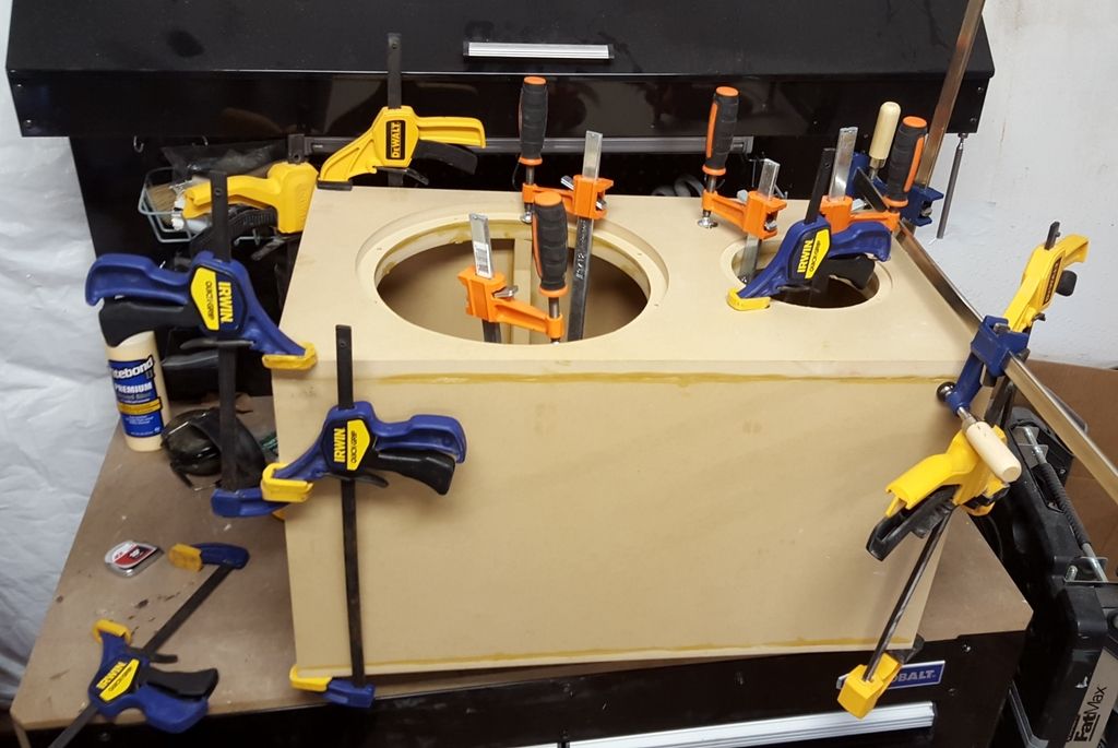

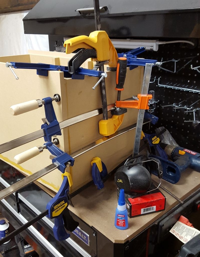

Started on the sides. Only have enough large clamps to do a side or two at a time..

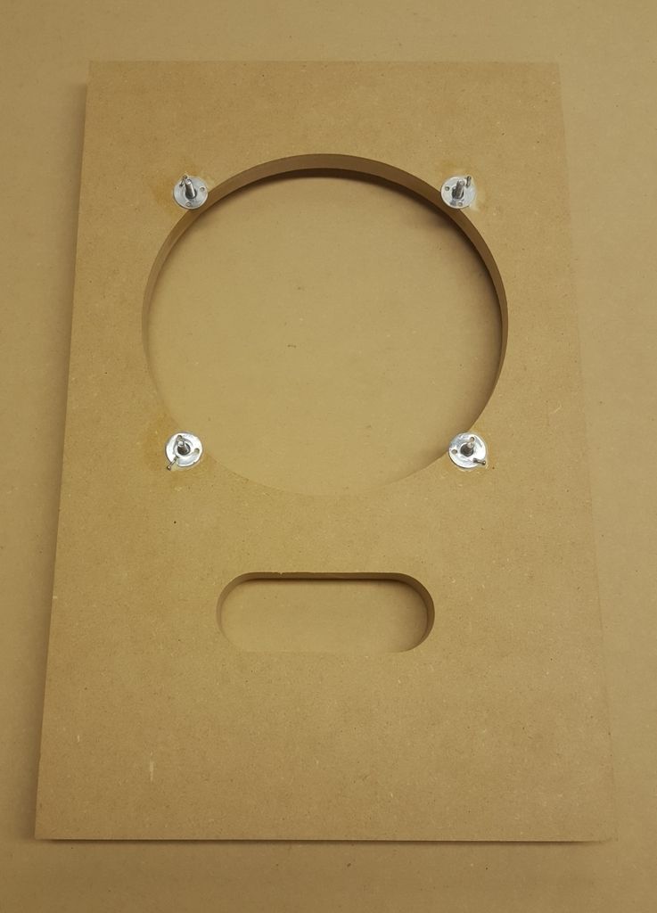

Baffles glued and screwed together. I didn't use screws on the other one. My thought was they'd add clamping force and strength to the bond, but they can actually push the 2 boards apart slightly.
For the second one I drilled the mounting holes and added T nuts first, so when I glued those together, they couldn't float around on the glue and stayed perfectly in place.

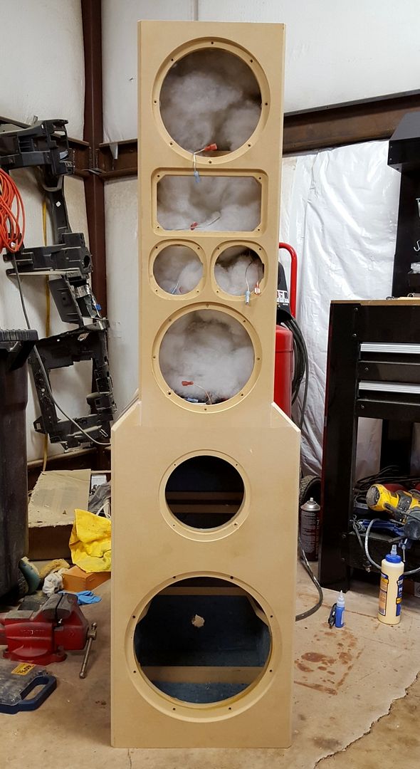

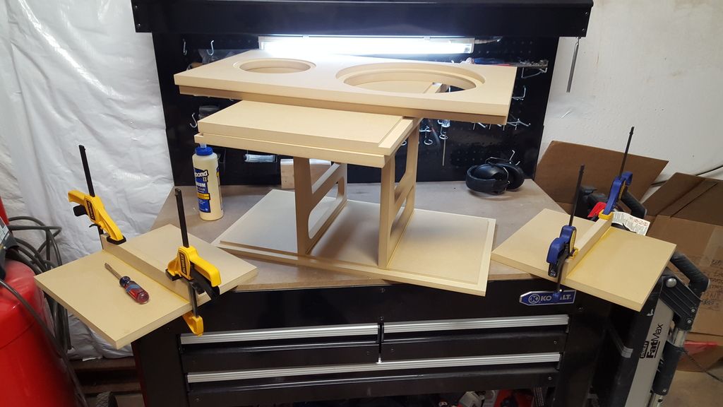

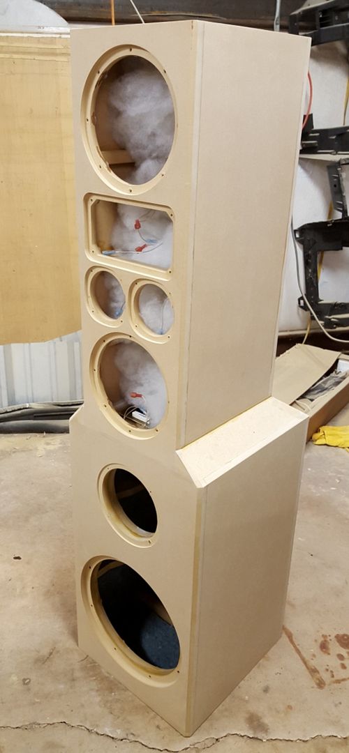

Last side piece going on the second enclosure!

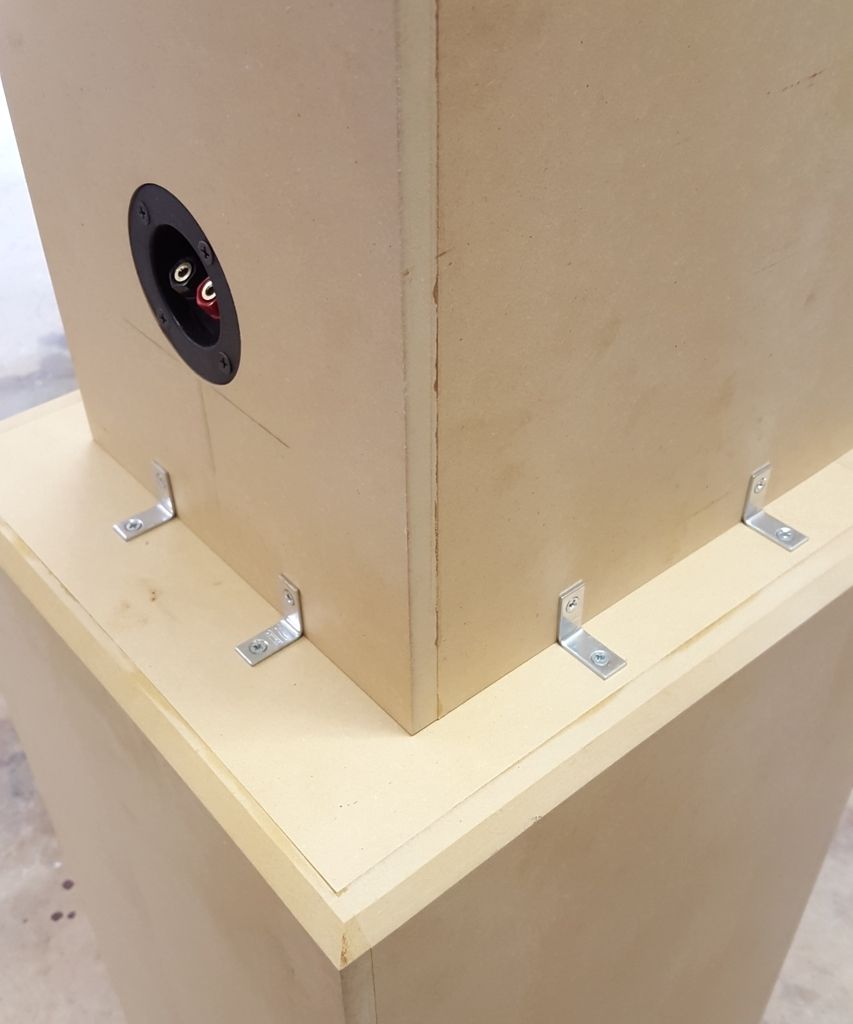

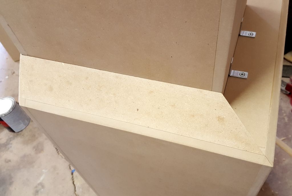

Added some metal brackets for additional support since the 50+ pound 893's will be sitting on top:
I have yet to attach the baffles since I still need some 6-32 T-nuts for the port mounting holes, but I did bring one inside to see what it'll look like in person:
These are gonna be killer

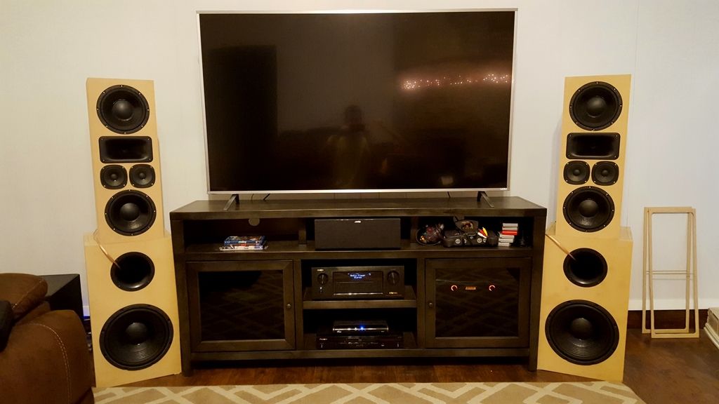

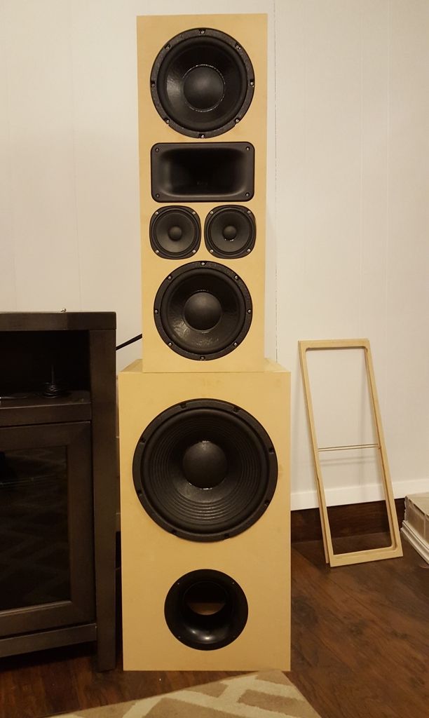

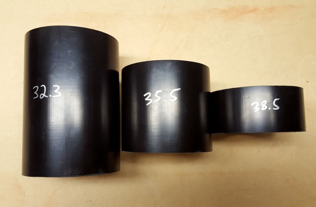

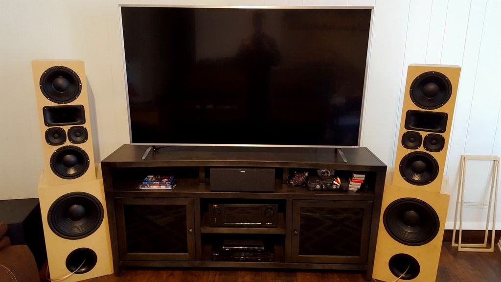

With the included port tube and using the Precision Port site calculator, I cut 3 lengths tuned to the frequencies written on them so I can experiment a bit.
Baffle going on:
Bit of denim insulation - not sure if this is enough...
And here they are with my new 65" TV. It just looks small compare to the speakers...
Haven't run Audyssey yet. Started with manual EQ using the Denon's GEQ for the 893's and the PEQ in the iNuke for the MBMs.
893's crossed at 200Hz. Still the dip at 400 but I got them pretty smoothed out.
MBM's
And whole system with the subs (no EQ on the subs since Audyssey was off):
There's some room to better integrate the subs, but I didn't touch anything on them other than lowering the crossover.
Wife and I went through a bunch of cool songs with the volume cranked grinning ear to ear - laughing even. This system is AWESOME. By far the most fun home system we've heard. The 893's provide the dynamics and detail with great snap. The MBMs produce the great punch and growling midbass we were after with the added benefit of making the subwoofers sound a lot better as well. We still plan on DIYing some new subs, but even now with the little 250W 10's, it's very impressive.
So yeah. Very happy.

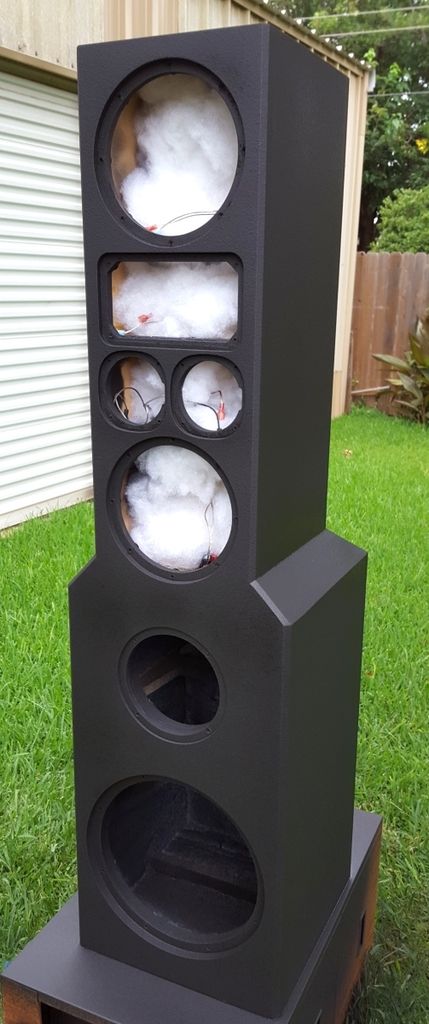

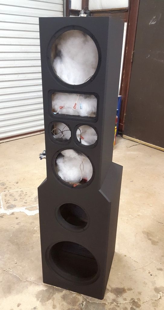

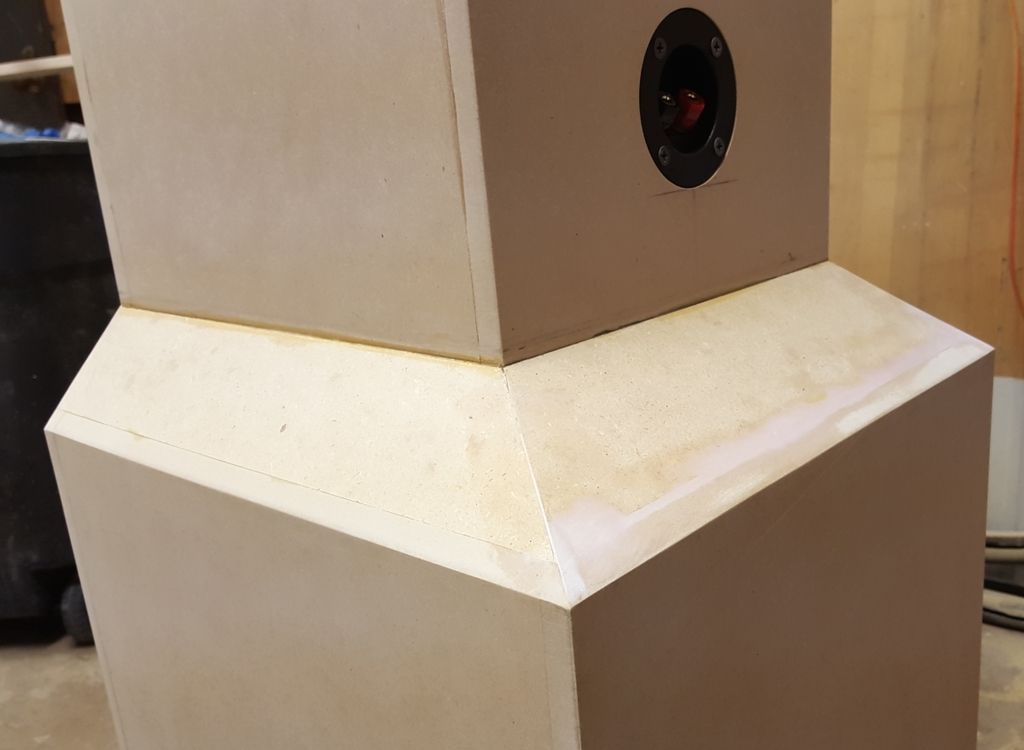

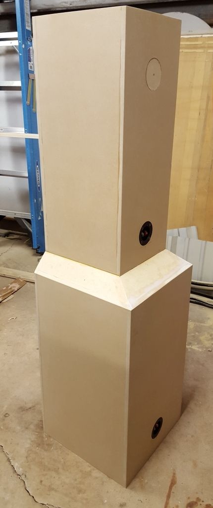

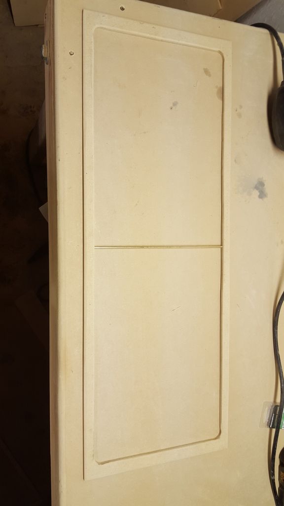

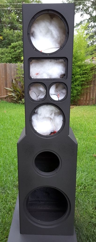

I finally got motivated to pull all the drivers out and get back to work on the cabinets. Routed out the terminals for 12's - went with woofer on bottom orientation. If anything that'll make them a bit more stable with the weight lower.
Put 45 bevels on the front side edges of all the cabinets:
Started making the angled side pieces for the towers:
The back piece is going to be hard since it won't be a 45 degree cut. Haven't done that yet.
Put a 45 bevel on the grill frames too and added some more metal supports since they're so thin now:
And I have some samples on order of different finishes. So progress is being made.

TV on the stand vs on the wall was mostly due to convenience and partly because it makes it over a foot closer to the main couch so it seems a little bigger.
As far as the stand itself, it was impossible to find one that fit the equipment in the way I wanted (few inches of room around the AVR for airflow and a closed cabinet section wide enough to fit the iNuke amps to muffle the fan noise) and also be able to fit a center channel as large as the 893. The top row of the stand was obviously made for a sound bar. After watching some movies in stereo, I do kind of feel like the focus could be better for dialogue so I wouldn't mind having a center, but I am pretty height limited if using that slot. It's 6" tall, so a Fusion 4 Quad would fit. I've been looking at other options with a tapered enclosure. The top of the stand is curved in at the top if you can see in the picture and so could fit a taller speaker as long as it tapered down to less than 6" fairly quickly (within about 2 inches).
Curious what you meant by different way to organize/access equipment.

wrt viewing distance for that size TV, check the THX website, they have charts showing optimal distance range, plus you may a slight downward angle toward the mlp and a more optimal height wrt to viewing into the horizontal center of the screen, just following the science
i initially had my TV on a stand but found a suitable full motion that feed up a lot of space, getting rid of the cabinet, but then i needed a tower for equipment but i have the space to the side of that,whole schmear,
the point being, the mount let me get the TV into that range and angle /height combo
I put up a 2 x 10 oak load plate spanning 2 stud bays, so about 36" long and a lot of big lag bolts . . you have the chops to know what I mean .
given the quality/attentive nature of your work (I really like it)
I can't imagine you not being able "imagineer" a (great looking) cabinet for the "stuff' that just happens to fit an exceptionally suitable CC., part of the plan to see how close you can get it up to the same horizontal plane of the L/R's.
re-engineering a F4Q4 wrt that curve of the cabinet, whole 'nother problem,
after all that, this is what i got for my "imagineering"

Looks like the optimum viewing distance for my screen is 7 feet, but I sit at 11 feet. Shoulda gone with the 75"
I'll think more about the TV layout once I get all the audio done, which is still gonna be a while since I plan on building 3 subs as well. Undecided on the center, but the Fusion 4 is a definite possibility.
Anyway, I had the day off so I spent most of it cutting the side angle pieces and figuring out all the angles to make it fit together seamlessly. It was quite a bit of work with just a handheld circular saw and router. The side pieces were all 45's so that wasn't too bad, but the back was not so I routed the 45 bevel then cut the steeper angle by hand.
I started the taper a bit below the top edge of the MBM enclosure so it all flowed together which probably resulted in more work than necessary to get the side angle pieces to line up perfectly but oh well.
First side piece cut. There are 2 of those metal L brackets on each side.
And here's the completed enclosure, ready for finishing:
Close up on some of the angles:
Very minimal filler was needed which was nice.
Now on to the next one...

Finally... yes!
Over the long weekend I finally had time to finish construction of the other tower.
Some small brackets to hold everything in place:
Side pieces cut and attached:
And shot with some black acrylic to seal the wood. Came out a bit more textured than I would have liked, but should be fine to apply the finish over after sanding.
Is the whole DIYSG forum closed?

Erich should be able to tell you more about the DIYSG subforum but I think posting is no longer possible but old posts are still accessible.
ja00 is offline
post #27 of 77 Old 07-06-2016, 04:30 PM
eng-399's Avatar
Join Date: Sep 2013
Location: Plainfield IL.
Posts: 4,181
Mentioned: 271 Post(s)
Quoted: 1694 Post(s)
Liked: 2878
Yes in the vendor area for diysg. It's a paid space over there and Erich didn't want to re new it. From what I remember reading there's going to be forum for it some place else besides the website it's self.
The box looks great to btw good work! The paint and finish work paid off.

post #30 of 77 Old 07-10-2016, 08:17 AM - Thread Starter
strakele's Avatar
Join Date: Jun 2012
Posts: 231
Quoted: 89 Post(s)
Liked: 104
Thanks guys!
Here's proof they're both actually completely constructed. Partway through sanding them. I got the spray pattern on the second one smoother so the sanding is going much quicker.
